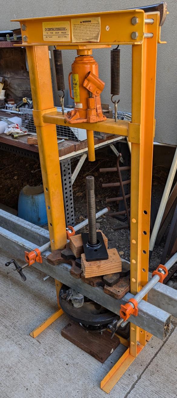

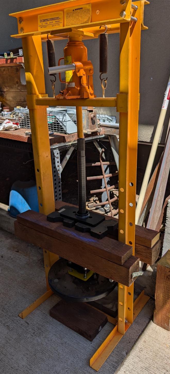

Same here. For the first bearing, I stacked 4x4 and 2x4 on either side. Worked well.
But, the second bearing was a good bit tighter. The wood stack was not going to hold. And, they were rolling off toward the outside.
Crazy thing... I happened to have 2 heavy 3x6 box iron beams. But, the press pins were still bending and the beams were spreading apart. So, I used 2 pony clamps to keep the beams in place. This worked really well, and pushed the limit of the 12-ton jack.
