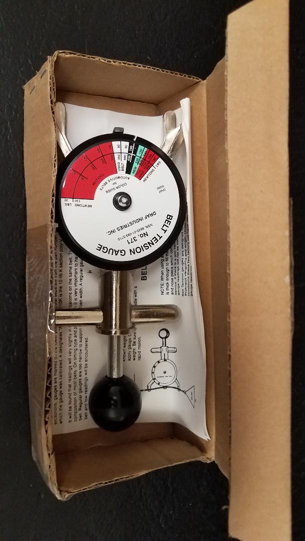

Being a "tool junkie" it should not have taken this long, but. When I replaced my AC system components a couple of months back, I also replaced the idle pulley and all 3 drive belts (2.7L) I adjusted the tension on all of the belts and I have always tried to be on the "not too tight" side when it comes to a drive belt. After a couple of months of occasional chirp/squeak at start up, I had already increased tension on all 3 belts once and on the AC belt twice and it was still happening on occasion. I found a BNIB tension gauge on fleabay for $45, or roughly half of msrp. After checking all 3 belts I understood why it would still chirp, AC belt was under 80 ft lbs and the PS and Alt belts were both just over 60 ft lbs. Without this gauge I would never have cranked them as tight as they needed to be, I set them all to just under 100, call it 95 ft lbs. OEM shop manual shows 2 types of gauges this one and the Denso and lists belt tension at 100 ft lbs. $45 was cheap for "piece of mind" that the belts are tight but not overly tight, and after 2 days not a peep:-) Lesson learned and I will within reason indulge my "tool" addiction as I tackle the repairs and maintenance. One of my tool goals is now a lift, I am getting too old working from the ground underneath and I plan to keep wrenching on my Runner and 81 Celica, plus I have the space.

Nice! That’s a cool tool. I got a cheapie belt tension gauge about the size of a pocket knife. I had the same conclusions as you: when I tighten “by feel” I’m typically 50% under where the FSM wants it to be.
I think old school V belts dont require as much tension to transfer torque effectively. The multi ribbed ones need more.
Nice, I never even thought about that. I have the same issue where I under tighten and get chirping. I hate hate hate tighting the power steerings belt since its such a pain to reach those bolts.
That's a cool tool. If there's one thing I can say about Japanese vehicles it's that they like their belts super tight, way beyond what you would feel comfortable tightening them to. Toyotas will squeak and squeal with a belt that seems tight. They will also have jumpy or almost non-existent power steering with no squeal with a loose PS belt.
Nice and I often wondered about tightening a belt correctly. Money well spent to know.
