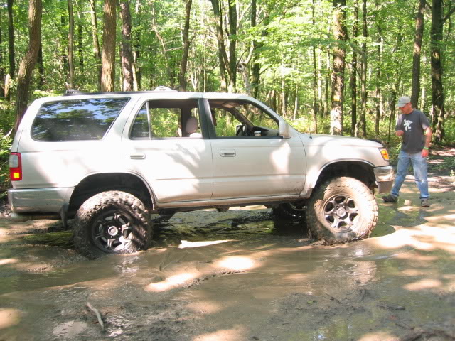

4Crawler 2" lift
Looks like alot of us are starting to grow up lately. I ordered my 2" BL from 4Crawler. They ship it on Feb.03 and I check the tracking number and its passing into Foreign Customs Canada. Should receive it this week and work on it this week end. I'll post some pics.
