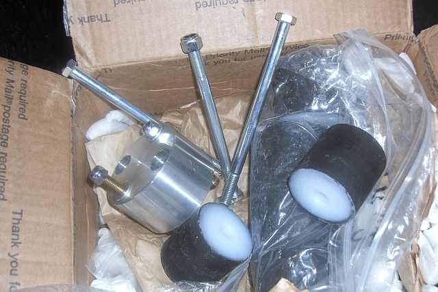

I received my 2" BL today. It take six days to Montreal Quebec. I start to loosen the nuts after I spray it with PB blaster for few days while waiting for the package.

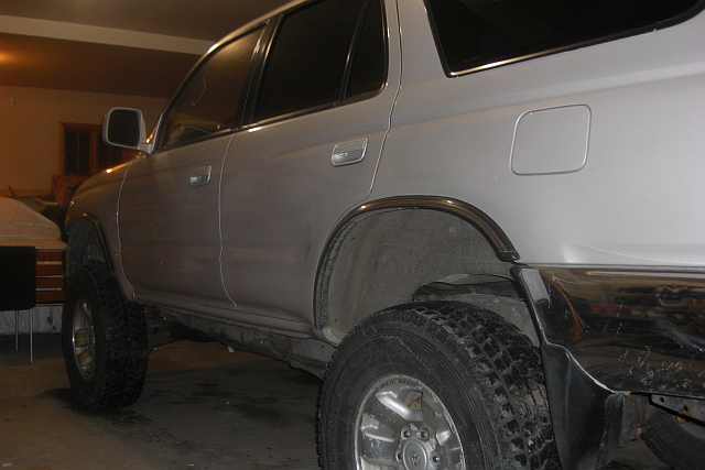

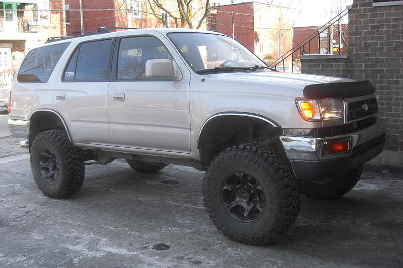

I could not wait for the week end so I installed the BL.

Huhh! I thought I explain it well with the pics.
