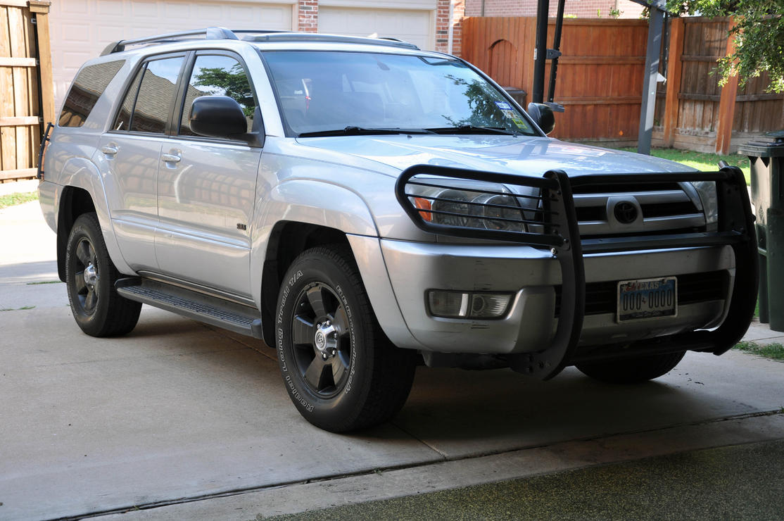

I just finished plasti-dipping my rims black. Check out the pics:
4Runners

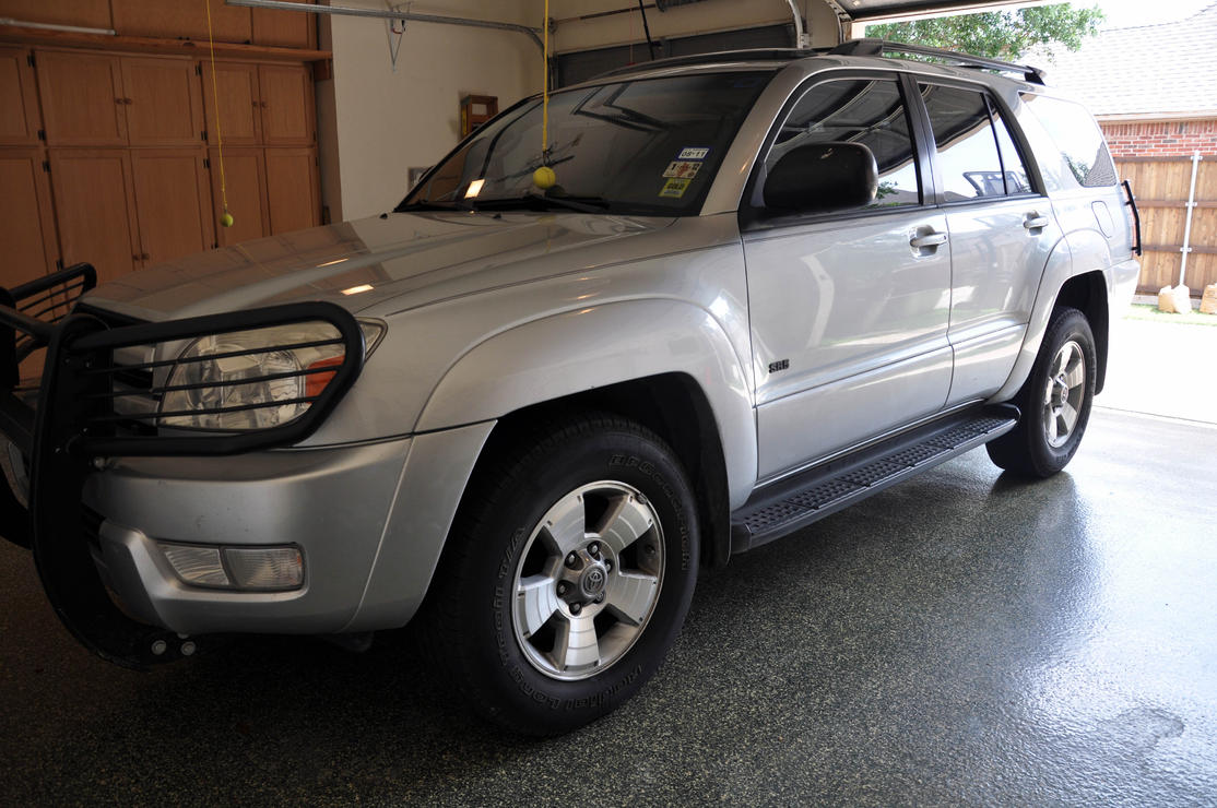

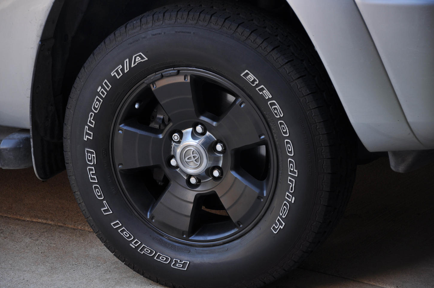

Wow i'm now a plasti-dip addict. lol I have such great confidence in the plasti-dip durability that i now did it to my OEM rims! Check out the before and after pics and tell me what you think:

Looks really badass! How did you go about prep and paint?
Also, your garage floor looks really cool too, what is that, epoxy?

Thanks! I left the tires on the truck, took out the hubcap then used masking tape to tape the edges of the tire near the rim and where the hubcap was and the nuts. Then i spent about an hour cleaning the rims and getting all the dirt and grime out (long overdue) I used about three cans of plasti-dip (about $6 per can at the home depot) and did three coats, applying the last coat as the thickest. (i also did the three bolts at the bottom of the grille guard, you can see they were silver in the before pic)
Oh, and yeah the garage floor is epoxy, makes it real easy to keep clean!
Looks much better. Plasti-dip ftw!
How did you avoid painting the rotors & brakes?
Thanks, when i sprayed it just didn't go that far back that it hit the rotor, so i didn't have to worry about it (i also held the can about a foot away while spraying)

looks great, though Id do the center caps, Im geussing you dont go off road, or that would come off, lol

Oh no she doesn't do any off-roading (unless you consider dirt or gravel roads off-roading lol) She's a 2wd and is stored in the garage between use. I was going to do the center caps, but saw someone else post pics of their rig with the rims done like this and thought it would leave a nice accent to complement the silver/black theme i got going on (although someone told me it looks kinda cop-carish with the grille and the wheels painted like that) i thought it made it look more aggressive! Eventually i'll do a lift and put more aggressive tires on, then make a build thread with all my pictures of each mod (there's a lot i did on the inside)

Were you able to get the inner part of the rims coated decently by leaving them on the car? One thing I noticed when I was doing my door handles is that if you don't get a nice layer around the whole object, there seems to be an edge left that's vulnerable to getting peeled off (by the elements, or whatever). Not sure if this is a cause for concern when doing the wheels, though.

For the most part (and you can see in my close up pic) i got all of the rim. If i were to do it again though, i would leave about a cm gap while putting the masking tape between the rim and tire because that's the easiest spot to miss and i had to touch up several spots around the rim's rim near the tire. Other than that it was easy to spray the rest, including the inside of the wheel spokes.
The good thing about plasti-dip is if you messed up you can either touch it up or peel everything off and do it again!
One last thing i should note is to do this mod in hot, dry weather. We've had several 100 degree days here in north texas and i left my car out in the sun since i started the plasti-dipping of the emblems. This allows the plasti-dip to sort of "bake" into the rims or wherever you apply it and trust me it isn't going anywhere. I scratched it with my fingernail today and nothing happened, although i would still be weary if it were to be scrapped with a rock or concrete, but then again if you were to scrape the paint of your car with a rock or concrete it would leave a mark too!
