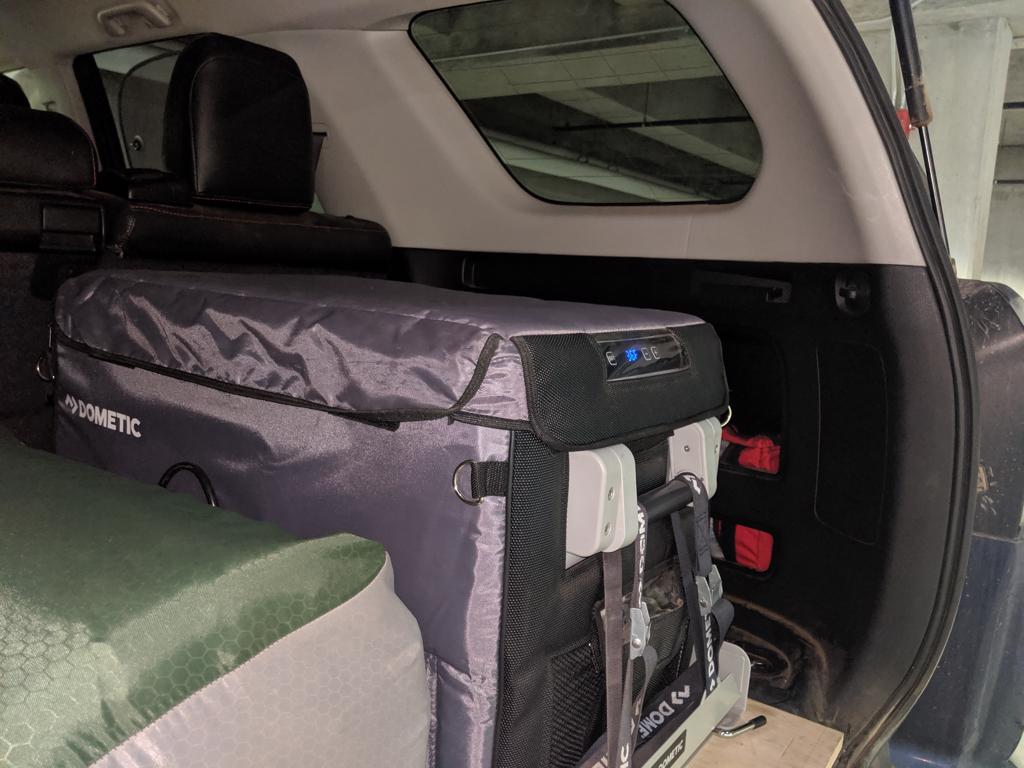

I'll try to help if I can here. I have the Dometic CFX35 and the slide. It's mounted on a 3/4" plywood base. I don't have the privacy cover but hopefully I can give some perspective. The slide elevates the height of the fridge by about 1". Even with my fridge jacket it looks like you have about an inch clearance from the fridge to the rear most attachment point of the privacy cover. It looks like it will hit the roller aspect. I definitely think you'll need the slide and to be honest that will make it much easier to use. Sometimes I will occasionally open the fridge without sliding if something is up high or closer to me but anything that is further back or deeper you will want the slide unless you want to hop into the cargo area. With the slide you could keep your privacy cover on and still use the fridge without having to roll the privacy cover back and forth.

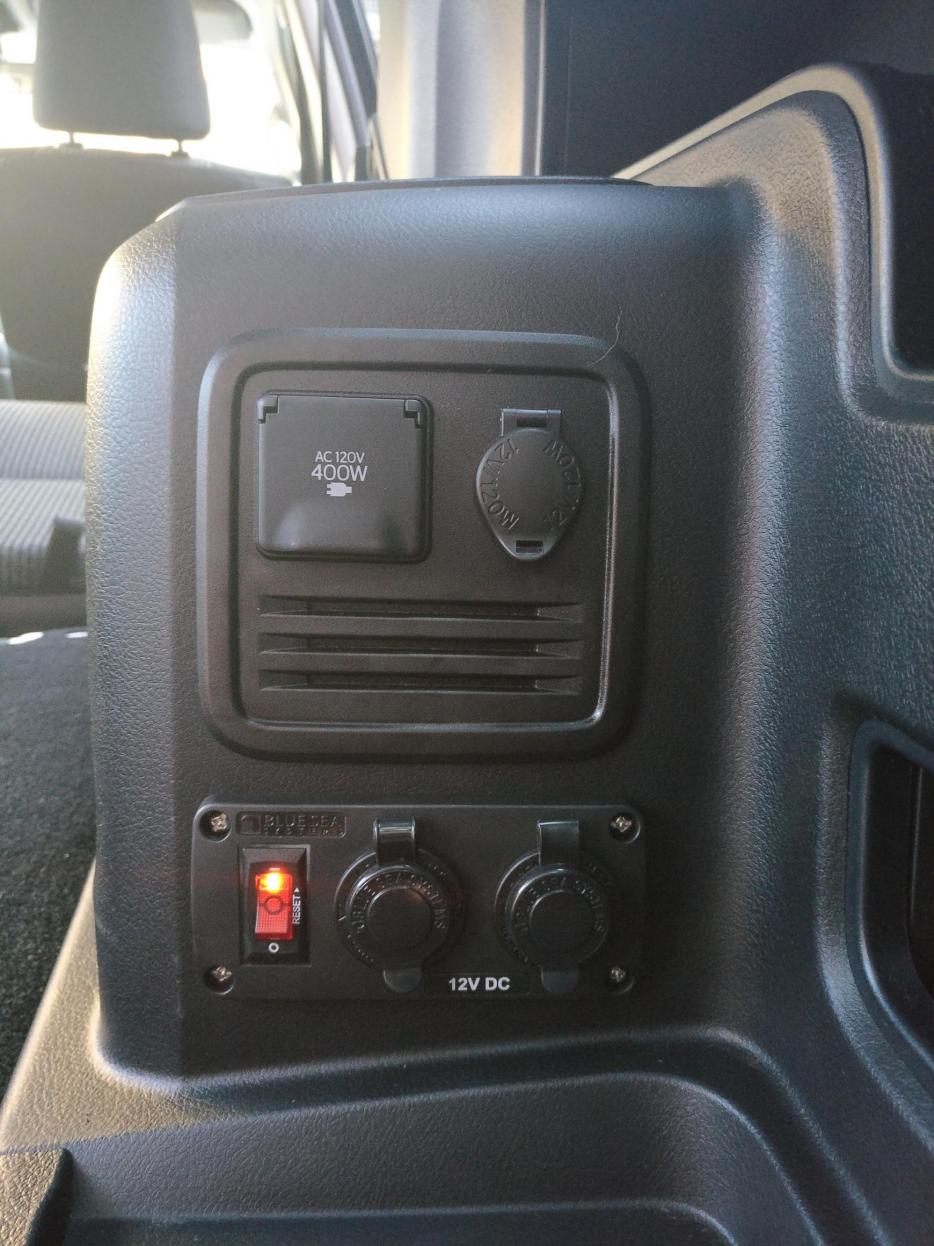

I have mine hooked up with the 12V cigarette with a Blue Sea Accessory panel. No issues with security so far and I've taken it on rocky roads and bombed down corrugated washes as well. It's pretty secure. Although eventually one of these days will likely switch to an anderson plug for reasons you mentioned above.

SN_85, very clean set up. Where id you get the accessory panel that you mounted the outlets to? Did you run something like a 10ga hot wire straight from the battery?

It's actually just about right. So it's usually just me and my gf and we might do 2-3 days at a time. We typically have some food left over in the fridge. When it's only me then it's quite a bit of space. Also a lot of things like drinks can be stored warm and then added to the fridge later when you plan to drink it that day and as when more space clears up. I could see a scenario if you have kids or are out for an extended period amount of time that space becomes an issue. The key thing is to organize well. I keep things either vacuum sealed or in a tupperware to save space.
So I have about an inch between the slide and the sidewall trim. The Dometic fridge 12v plug cable is actually quite long so even when it's fully extended out I still have plenty of slack. It hasn't been pinched yet. I did have that problem when I had my Indel B fridge and tembo tusk slide. It would get pinched and I'd have to be careful about how I slide it out.
It's the Blue Sea Below Deck panel. So I have an aux battery in the engine bay and a Blue Sea Blade Fuse Block as well. Aux Battery --> Blue Sea Blade Fuse panel --> 10ga wire through the fire wall --> under the kick panel --> then under the wheel well trim. If you pop open the OEM 12V and AC panel (just a few tabs) you can gain enough access underneath the wheel well tray to use a stubby phillips head and loosen it. That way you don't rip up and destroy the tray if you don't want to. That will gain you enough access to route the cable underneath with a coat hanger.
You can get them on Amazon but I had ordered mine when I did my dual battery setup from Off-Grid Engineering.
