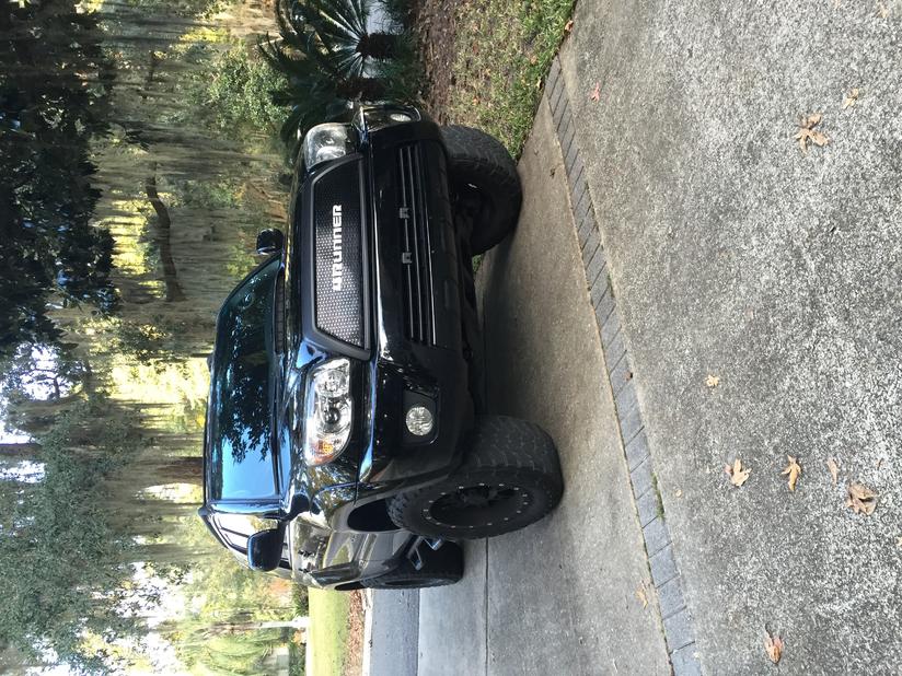

I did what yours looks like
Very nice! Love the look!
Got the frame plasti dipped.
Edit: oops, sorry it's sideways. Uploaded it from my phone
