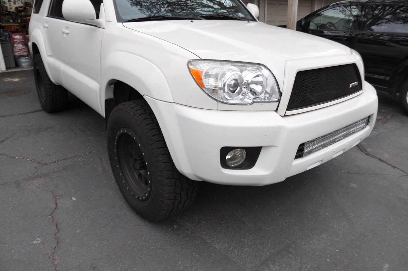

I like the look of the Satoshi. Nice update to a dated front end.

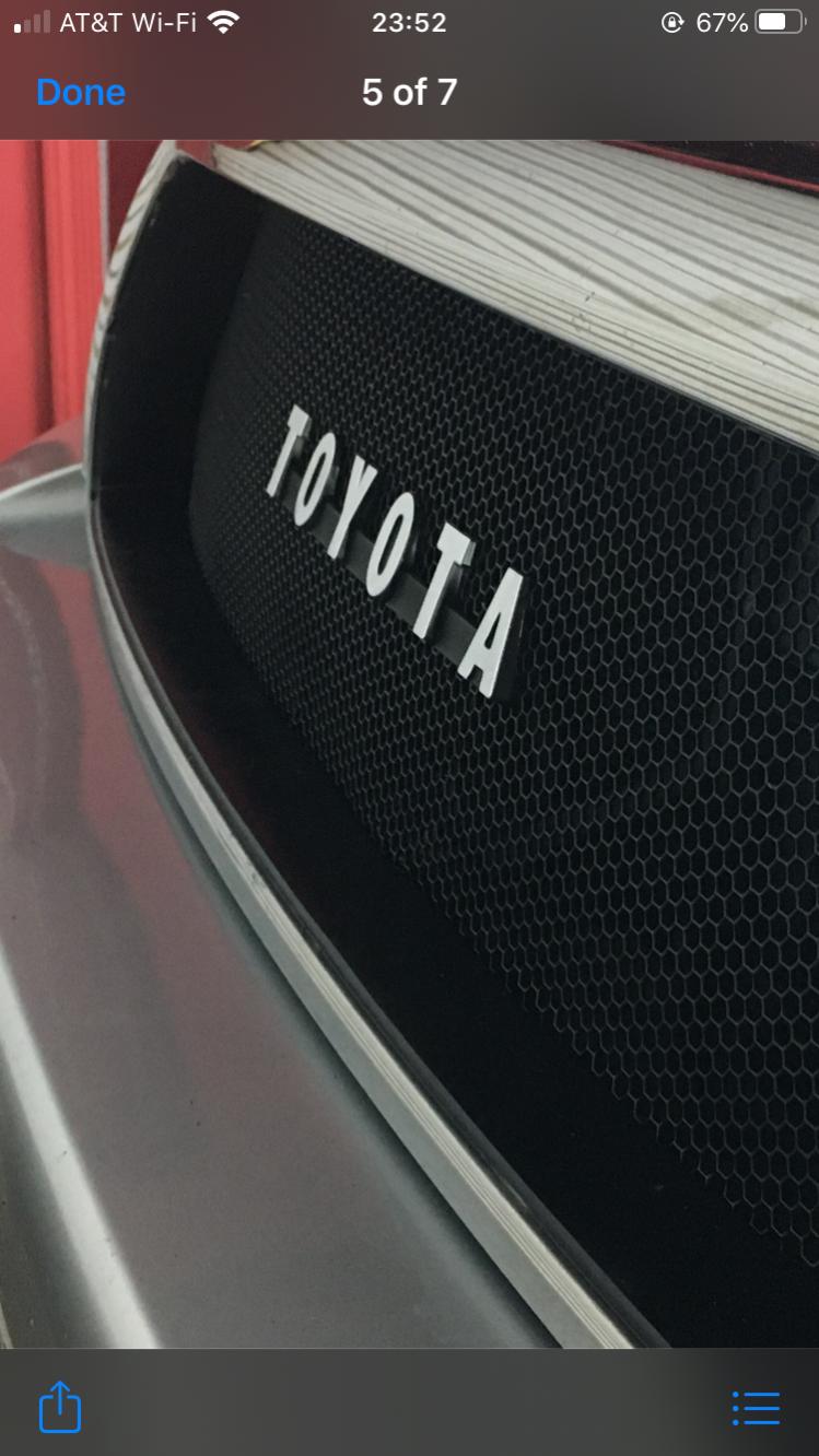

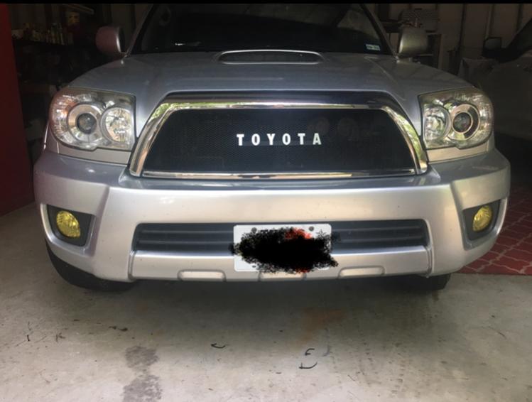

Not too hot on my badge choice.... has an angle to it.

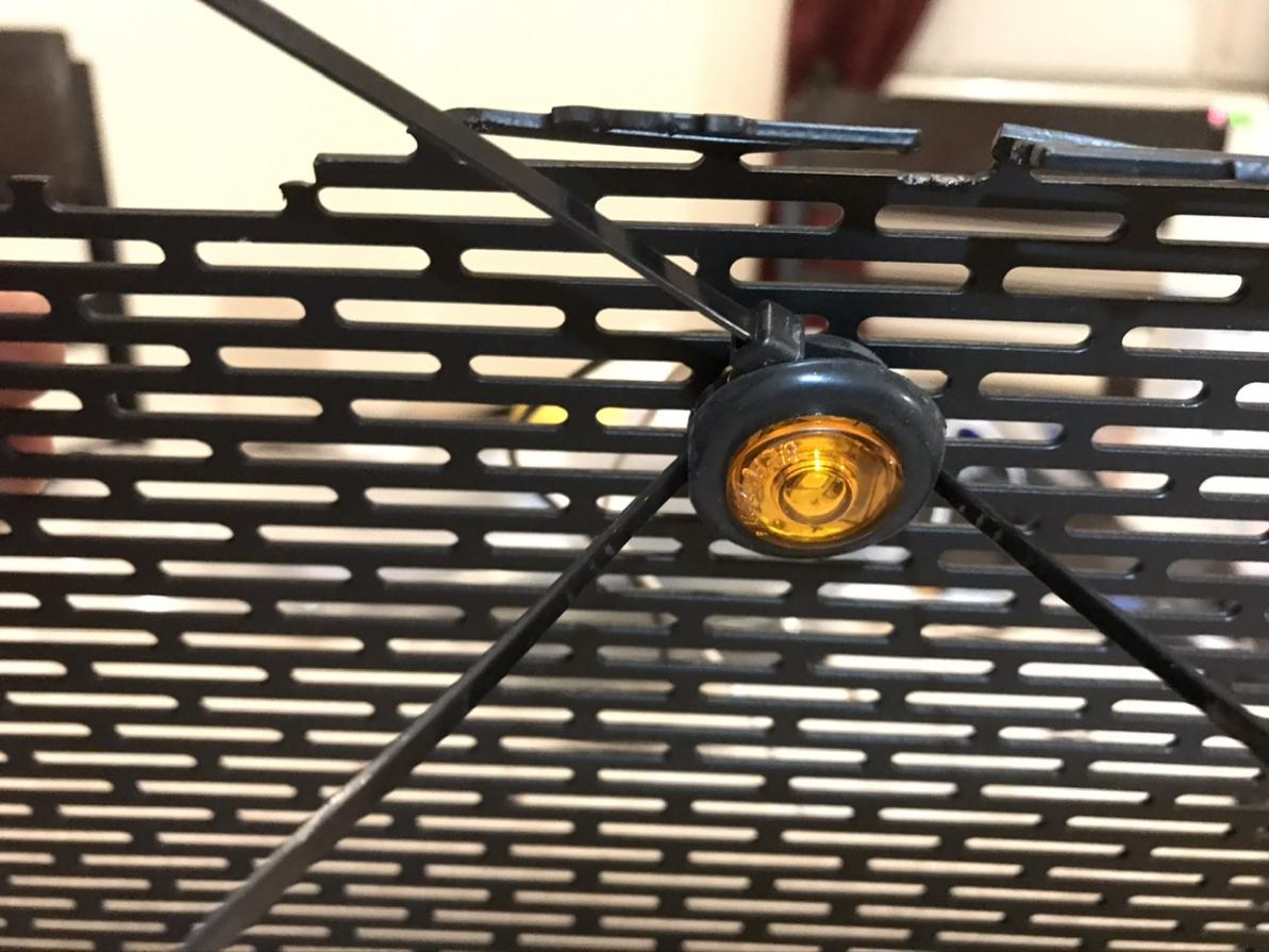

These look amazing, cant wait to do it on mine. Does anyone know how feasible it'd be to install some raptor lights with a satoshi grill on a post facelift 4th gen? I was thinking either cutting the mesh around the lights as precisely as possible, or somehow fitting them to the grille and leaving them behind the mesh. So far, all I've seen in the way of raptor lights on 4th gens are on the pre facelift, and none with a satoshi grill. I also have only seen the round lights which I'm not the biggest fan of, I prefer the rectangular style ones you see on most 5th gens.
I'd love to try to get 3 of these wired up and working with the satoshi grill!

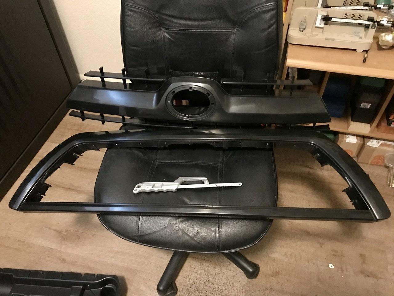

Question for you guys that have done the Satoshi mod. Just an FYI, I have an 08 so it has the updated front grille. I had read a couple people had bought aftermarket non OEM front grilles do do the mod. It seemed fine so I ordered one of these. I figured it’s just the perimeter anyways so hopefully would be fine? TO1200297 NEW Grille Fits 2006-2009 Toyota 4Runner | eBay
It’s different in that it is super heavy (ABS plastic), not light weight. The center horizontal piece isn’t 2 pieces and doesn’t remove like the OEM one does. Wondering who all used a Non-OEM for this and did it fit and work fine? Also it doesn’t look like the weatherstrip is adhered real well to this, maybe it will be better when put on and sandwiched between grille and hood? Wondering if I should use it, the existing one on truck, or look at ordering a new OEM piece?

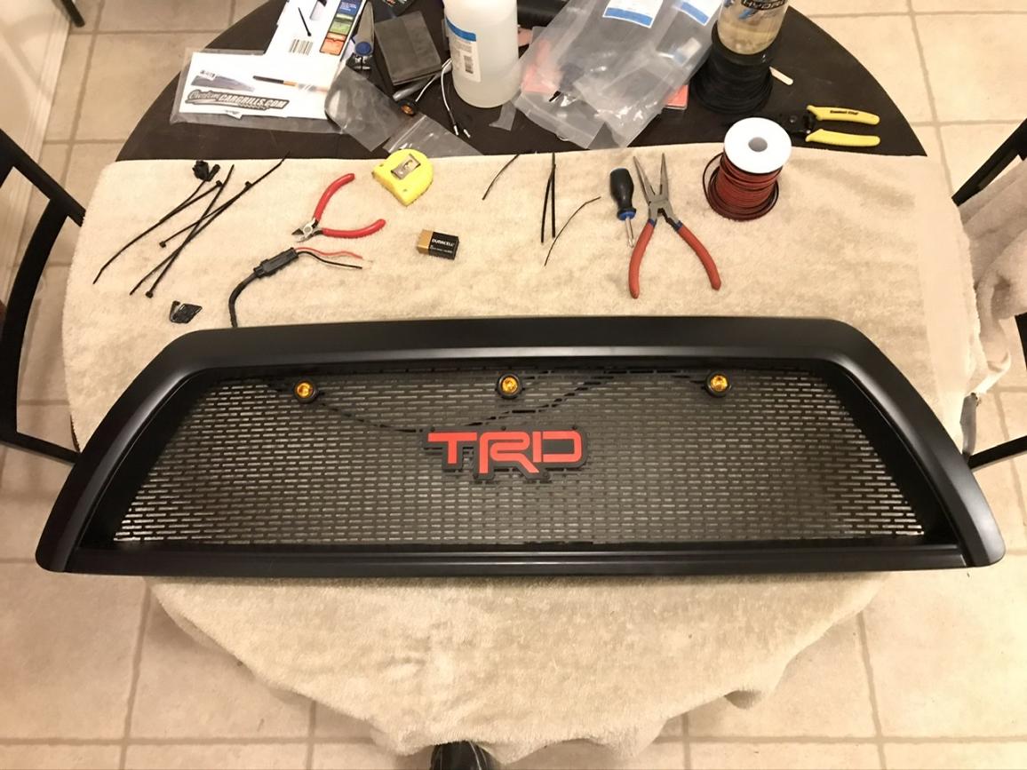

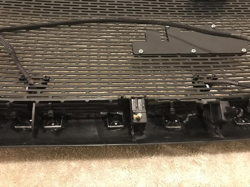

Here’s my Satoshi after many hours of work. My color match 1D4 paint hadn’t come in and I was tired of messing with it and needed a break. Painted flat black for now and wanted to just get it on. I’ll pull it back off and paint the face in 1D4 hopefully in the next couple weeks.

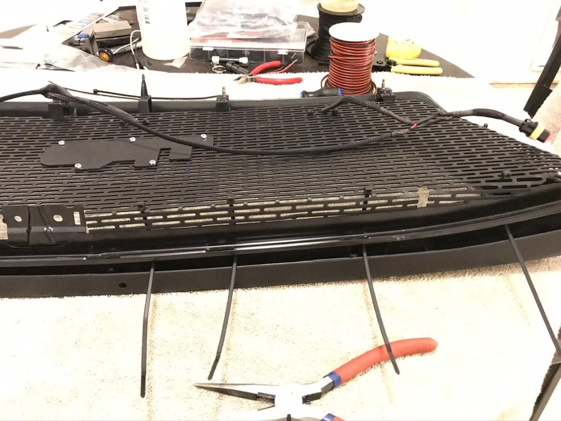

I used the method used by [MENTION=114846]Bluesky 07[/MENTION] of attaching with zip tie bases and zip ties. Worked out well and a great idea! Especially since I’ll need to take back apart soon.

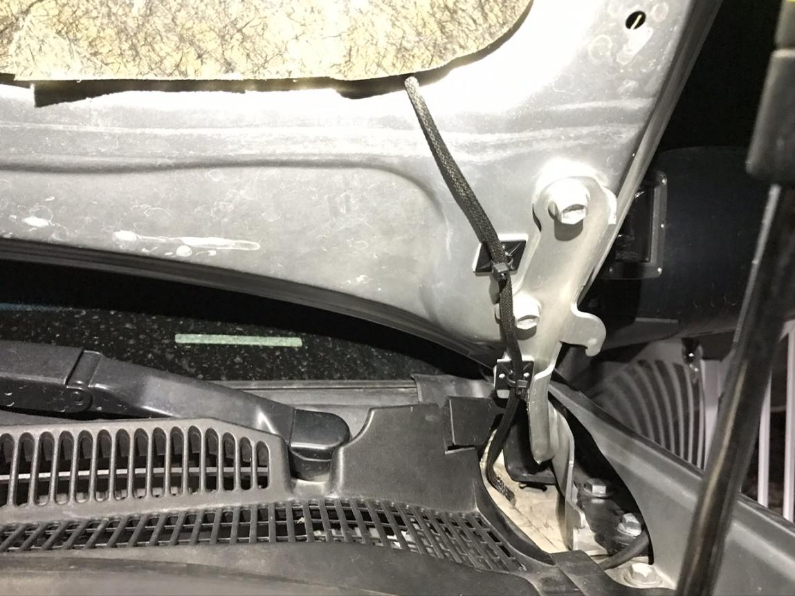

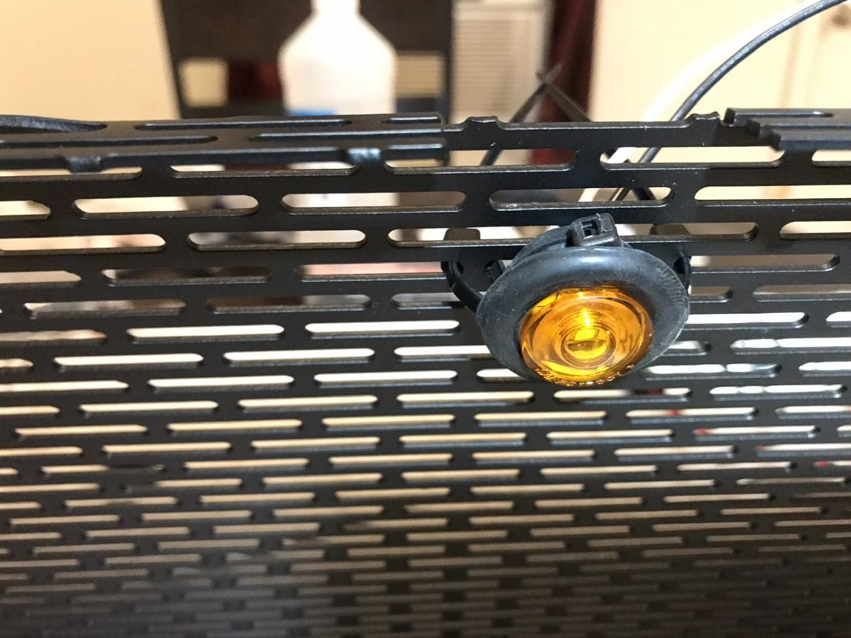

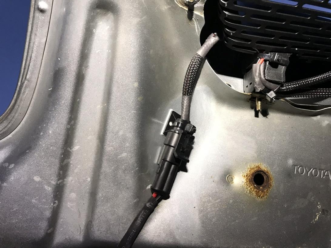

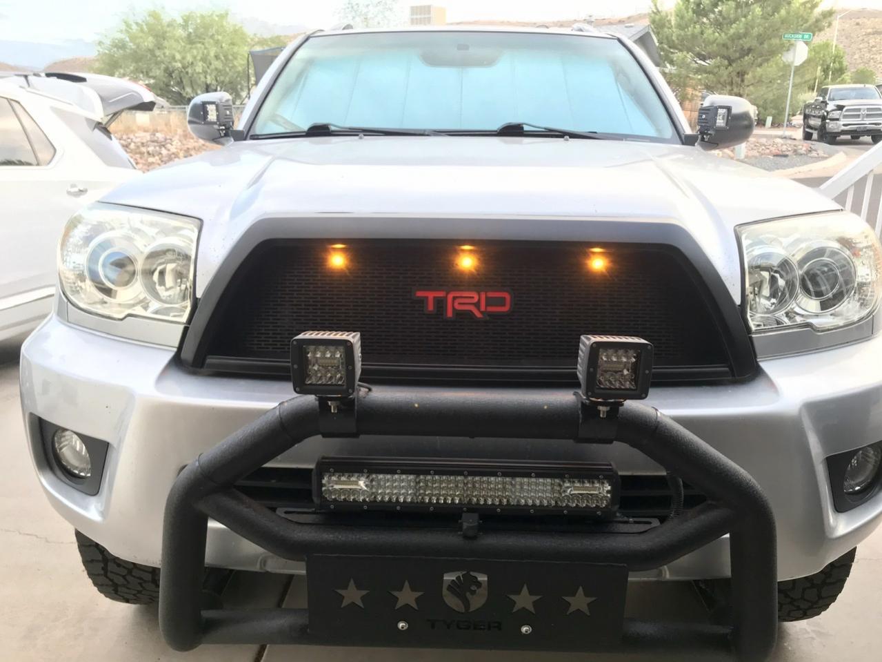

Went with the Raptor style lights and tied into a 12V+ ignition wire in my driver side door sill. I was torn between the BIG TOYOTA letters or the simple clean red TRD letters. I went with the latter and was afraid the large letters getting glued on would not be evenly spaced and get crooked. This TRD emblem just bolts on so easy to move and center.

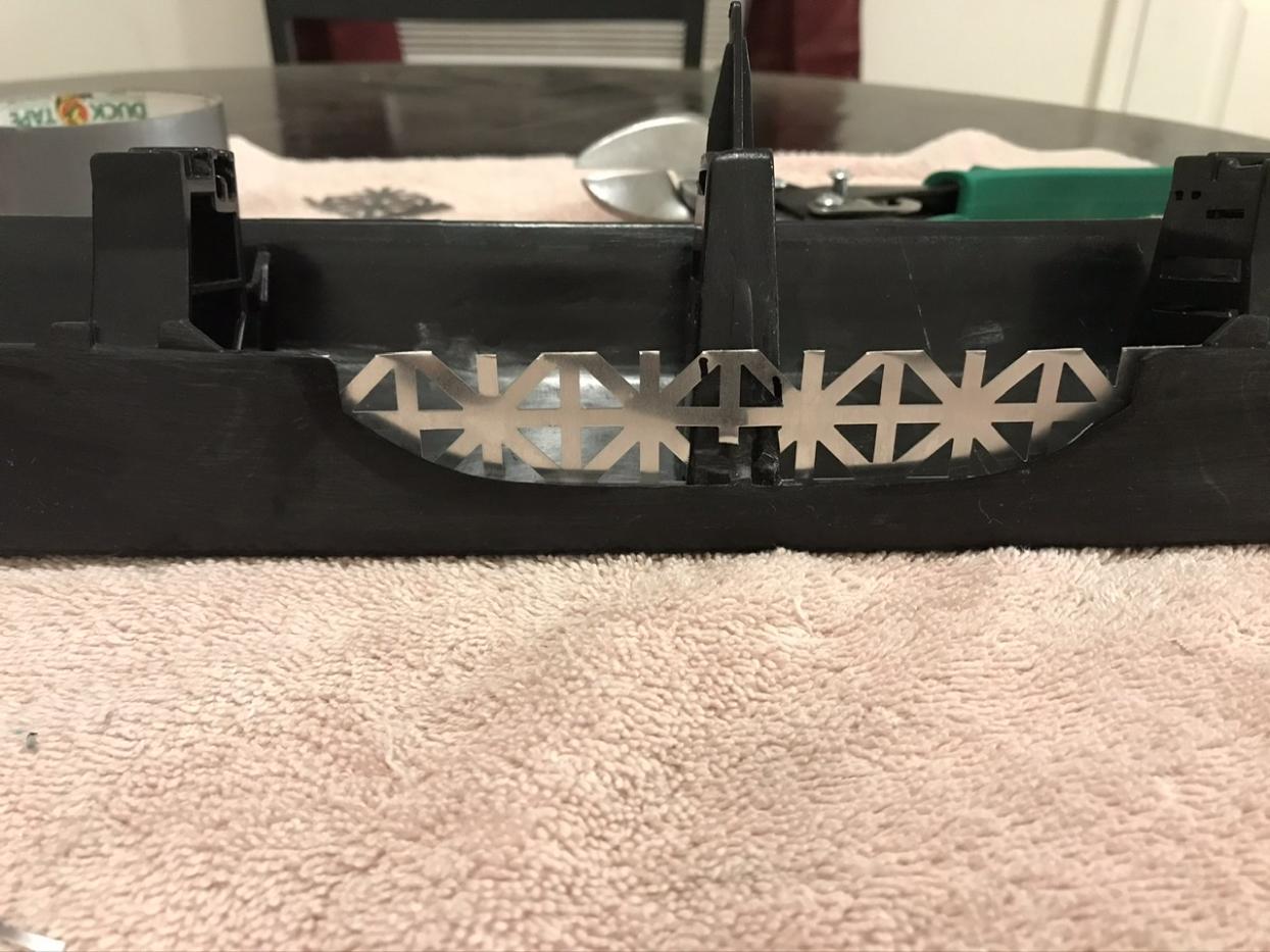

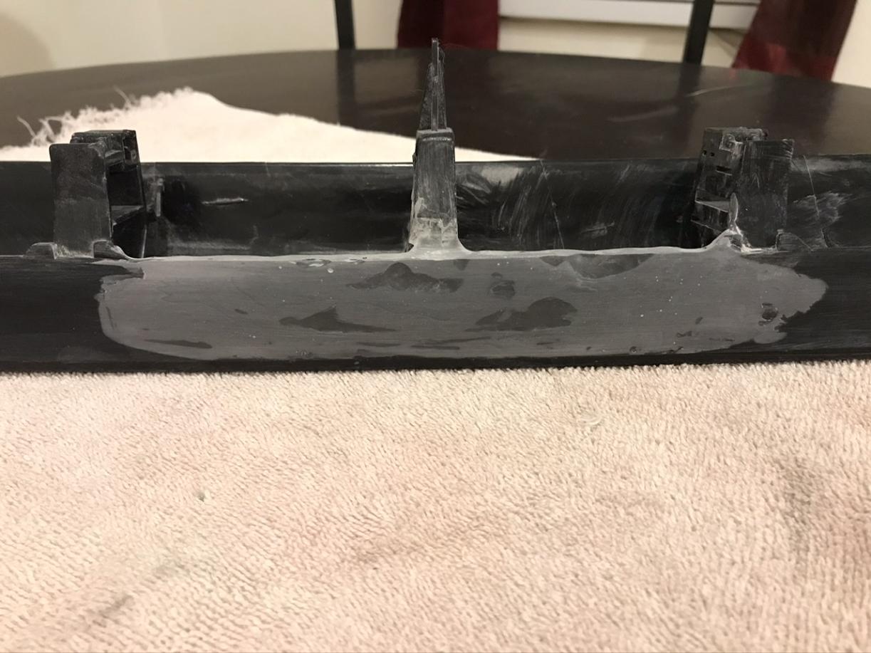

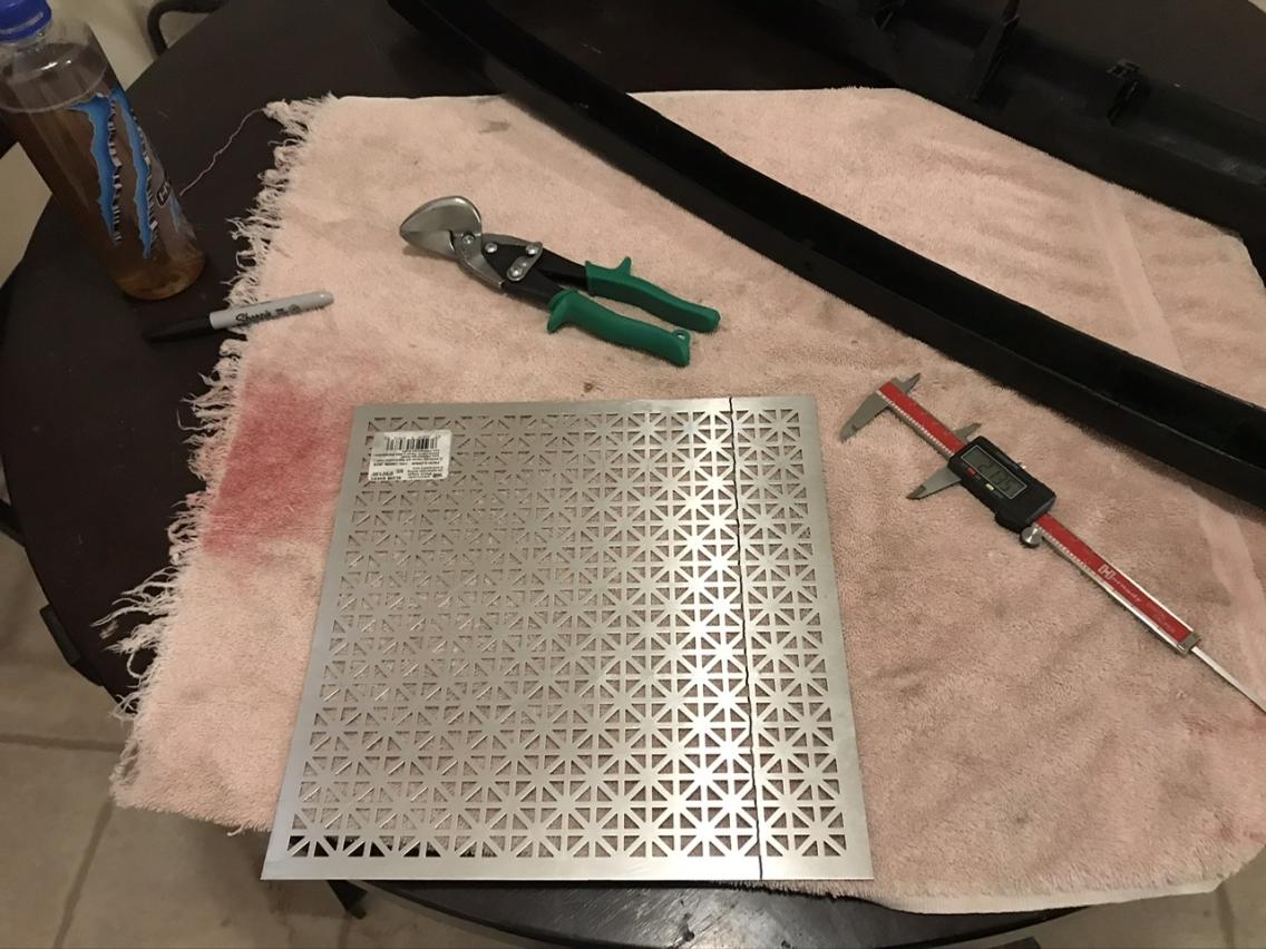

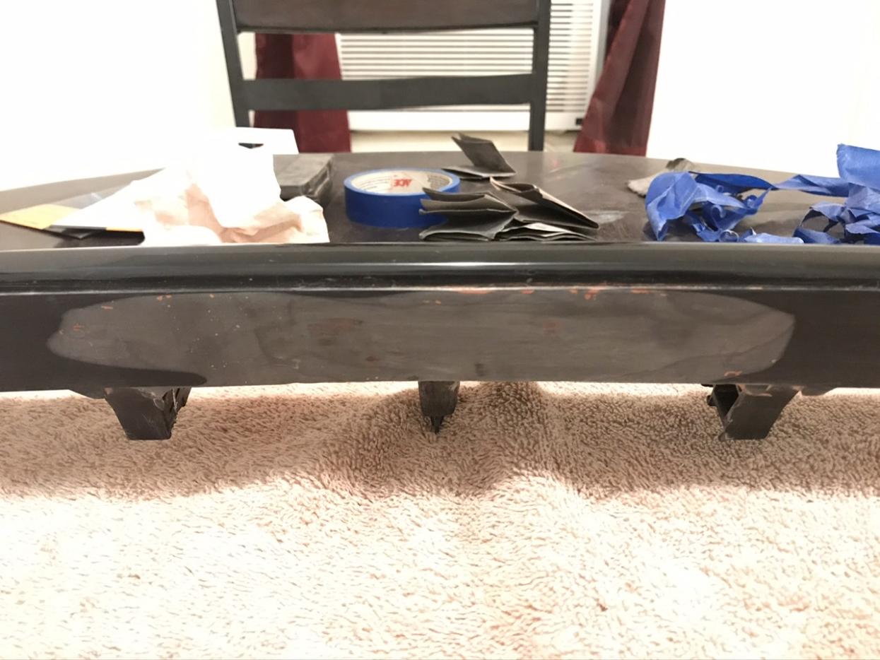

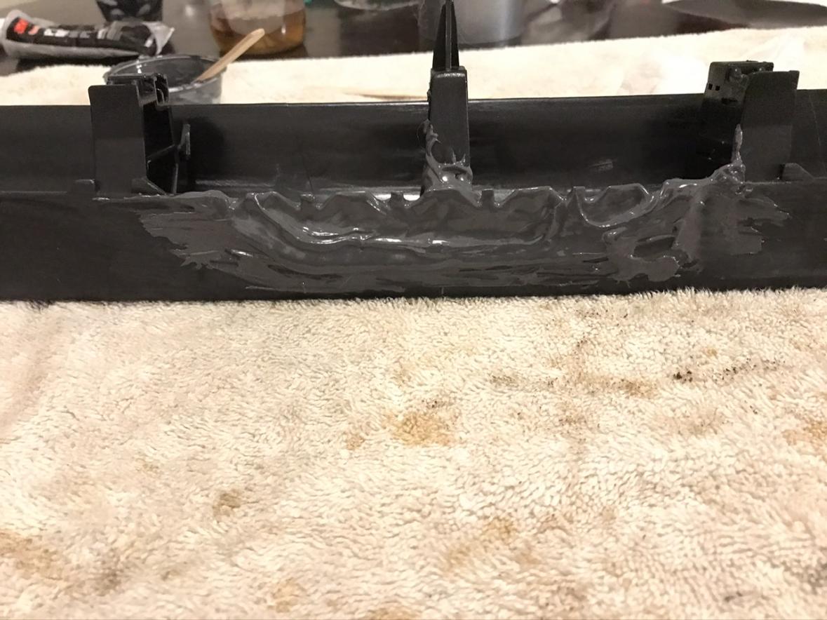

Wanted to try and find some aluminum expanded metal to avoid corrosion, this is the closest I could find at Home Depot and wanted to get started. I wound up using JB weld for the body filler since I already had it, what a pain in The butt to work with and sand! I wouldn’t use again, at least not the regular dry time. Too runny and tacky. The fast dry may be ok, which is what I used at the end as a topper. I was told Bondo may crack with that big of a gap and Ive never worked with fiberglass. At least it will be very strong lol.
Looks great & it’s very rewarding to know my thread helped. :cheers:
