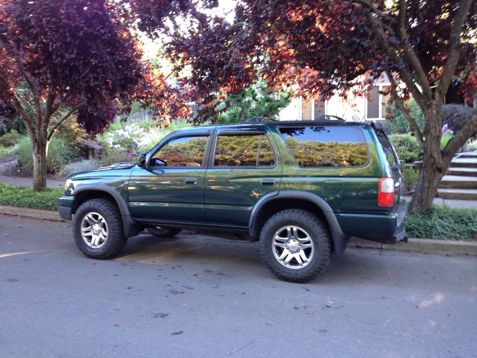

Just for reference I added a pic.

Just out of curiosity what are the measuring points? Maybe I'm odd but when i think 23" this is what I see!!
23" to the bottom of the frame..

I went from the stock Highlander coils to OME 880/906s, and I just clear 265/75/16 Duratracs at stuff with no other mods. I don't know where you're measuring 23" at either, but if you'll give me reference point I'll tell you where mine compares.
I believe when they are talking about 23" they are talking from the center of the hub straight up to the fender.

Ok, so with 880/906s and no extra load I'm at 21.5 in front and 22 in back from the hub to the bottom of the flare.
And if you're trying to clear a skinny 33, that's not nearly enough. Our last set of tires was 285/75r16s, and they rubbed frame and mudflap.
Man love the rig!!
Yes, sorry I just automatically assume the hub to fender measurement as being the way to go. So yes 23" from center hub to bottom of the fender.
