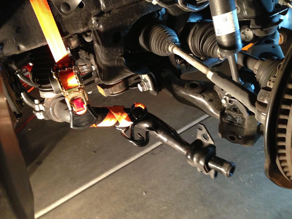

As a suggestion from personal experience on the KDSS, get all 4 wheels off the ground. That will alleviate some of the pressure on the system. Something that helped with getting it back was to ratchet strap the sway bar to towards the rear of the truck (can't remember where exactly I used) and that will pull the bar close to the LCA, and then I used the floor jack to push the bar up just enough to get it to realign. Once you get past the KDSS it wasn't all that difficult and pretty straight forward.

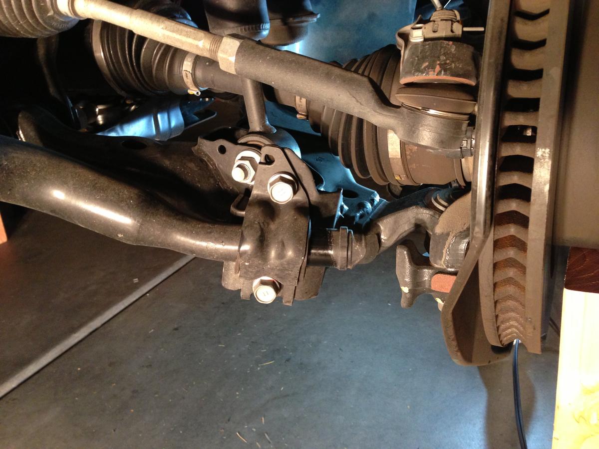

A few mins in and Im already having issues...The FJ step by step that I am following is great... just confusing that when looking at the KDSS the pics are not there... I just want to make sure that these are the two bolts that I remove to to drop the Kdss sway bar? and I am going to try to strap it up befor I unbolt it.

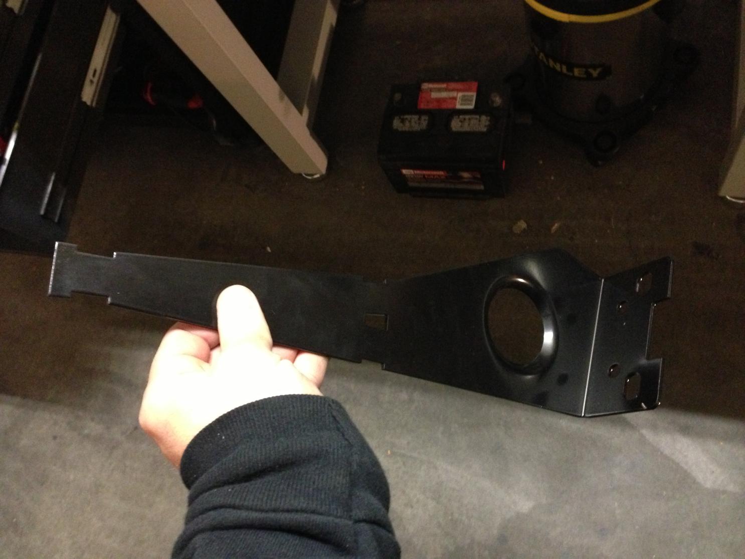

And this bracket for the remote res. goes between those to bolts right?
hope this is right...(((FYI my computer is gettting real greasy)))

Yep, those are the right bolts. I did not hold the bar with straps until I went to put it back together. I just let it drop, then coaxed it into place with the straps and jacks.
