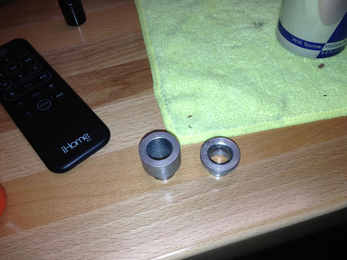

I just need a baby nap.... So here's an update... Driver side was a nightmare... Took a billion hours... Following the fj write up is helpful but still not that close to a 4runner with KDSS... The icon black and white one piece of paper instructions is useless for a noob.... I am super glad that Harper works 24hours a day like a slave and was able to talk me through some hiccups... Biggest problem was one of the shock spacers was manufactured incorrectly it took me two hours of tryin to push it through before I figured it.... I should have known this!!!! It's the first part of the write-up make sure u have all the parts and check to see if they are made correctly... How does a company not check this before they send it is very disappointing. i am Going to buy a round file I'm the AM to fix the spacer so I can use it on the other side.

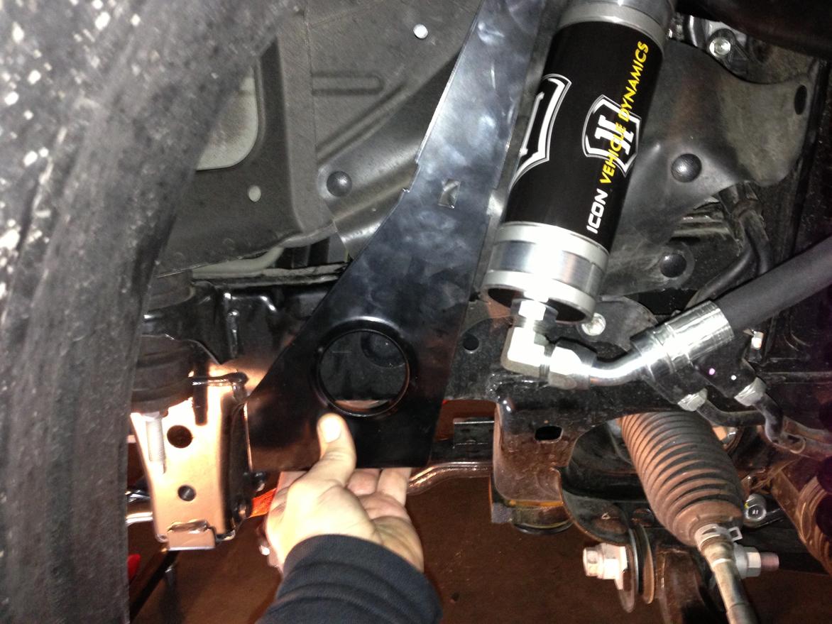

It was told the remote res. bracket bolts on to the frame and is easy to install... But looks like i need to drill holes and I'll need to go get a tap set to thread them but the res bracket doesn't lay flat against the wheel well so I might need to create one or bend it... I am sure someone has already figured out how to make this work some how I missed it.

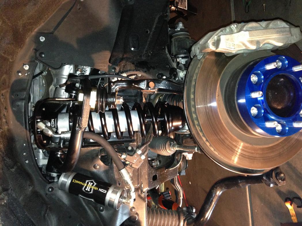

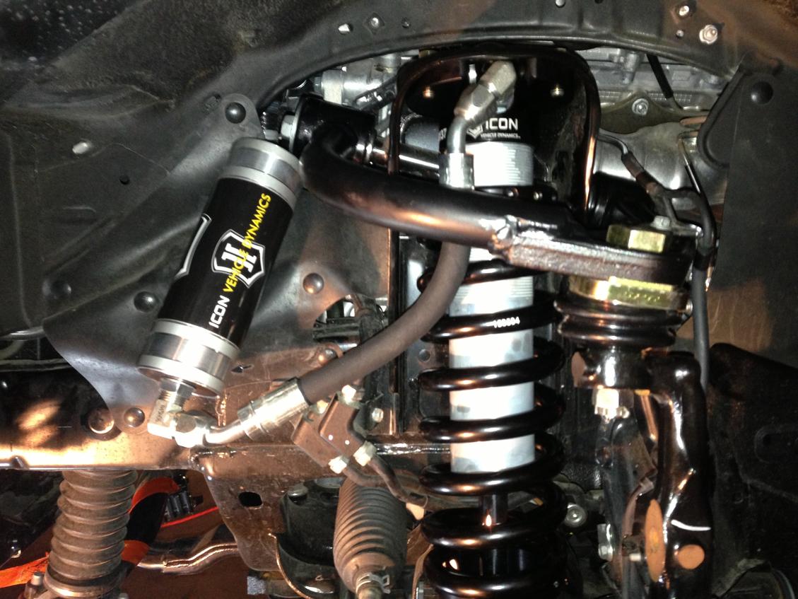

Please look at the UCA where it connects to the knuckle it looks like it is at a weird angle? Ill try to find pics to see it this looks right or maybe once the tire is on and the truck drops it will be in the correct spot... But now I am nervous maybe the tie rod(I think that's the name of it) doesn't move freely and it's bad and stuck at that angel till the weight of the truck breaks it free...
Any help would be appreciated...

Don't know why I can't post all the pics I need help on.. Anyways hope you can see what I am talking about

Did you use all 4 flat washers on each UCA'S? In the pics, it does not look like you used the large washers on the inside of each bushing. That is the hardest part of the UCA install, lining it up with the inside washers on since it is an exact fit.

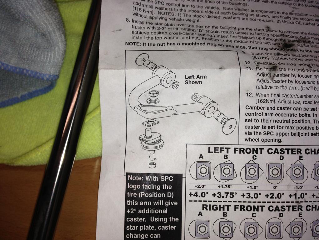

Hey gents... when I talked to Harper he said the same thing that I should have 8 large washers for the light racing but actually these are the new SpecRide bushing so they have big washers on the outside and little on the inner....here is the directions... If I am wrong LIE to me cause I just got the second arm in and that sucked. image.jpg

Huh, weird. My instructions are different than your because they show 4 large washers per side. In addition, my UCA's have the new spec ride bushings. Looks like you did it fine per your instructions, they just came with different washers.

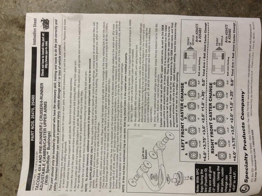

My instructions. Revised 3/2012
