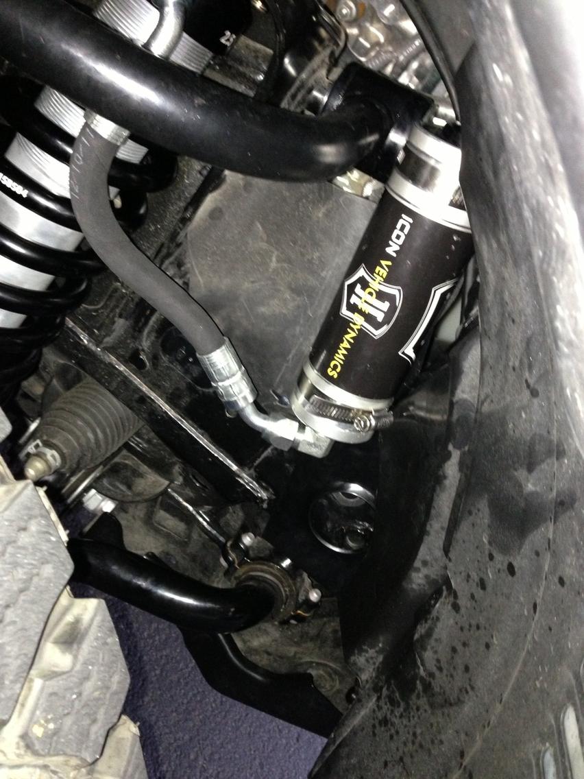

Just the reservoir at the moment! But it my fault my little drill is no way strong enough to drill holes into the frame... And Ducamonster aka bobby has a post with a pic on how he cuts the bracket to clear the washer canister in the wheel so i might try that and Harper does it be moving the res over on the actually bracket.. Long story long even on the drivers side bracket it doesn't really seem the bracket will lay flush in the wheel well, going to try to bend it out maybe...
Thanks for your help... Why did I go remote res? Not for a noob without the right tools! I would have been done by now.

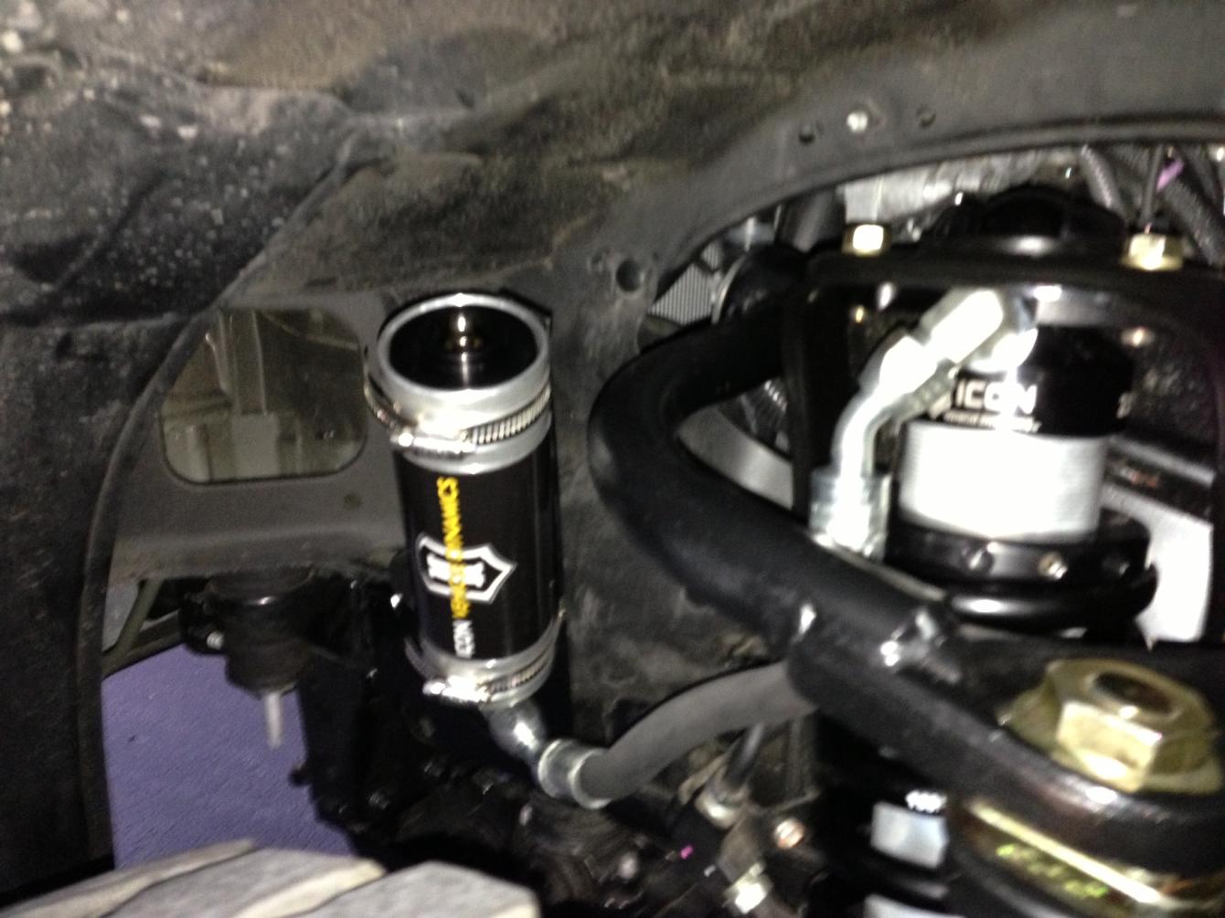

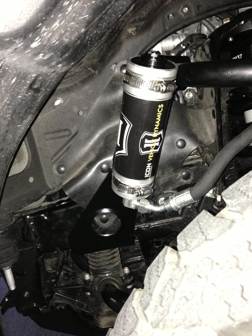

anyways if you have any pics or other suggestions on the remote res location and placement, please advise... Doesnt give you much slack to place it...I saw you post on jango's thread which helps....

Those spacers look right to me, you have to make sure they are fully seated in the com 12 bearing otherwise it won't fit inside the shock mount. If you need to use a hammer to open up the shock mount on the lower control arm and everything will slid right in.
For the remote reservoir nothing is wrong with it, I suggest you loosely clamp the reservoir onto the bracket and then bring it up to the mounting holes on the frame. The hose is designed to have a twist in it when fully mounted.

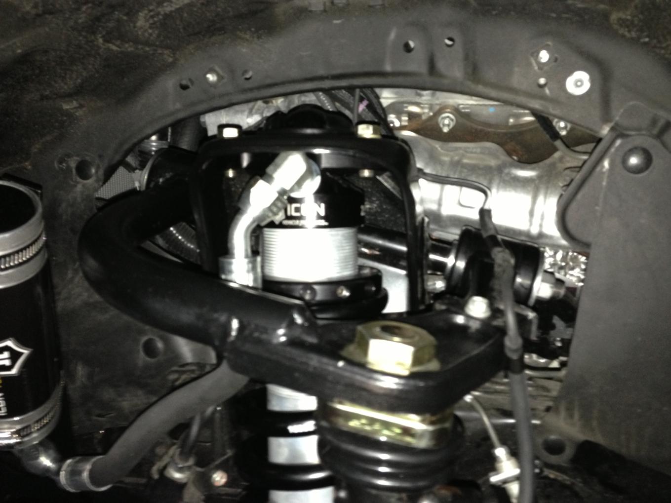

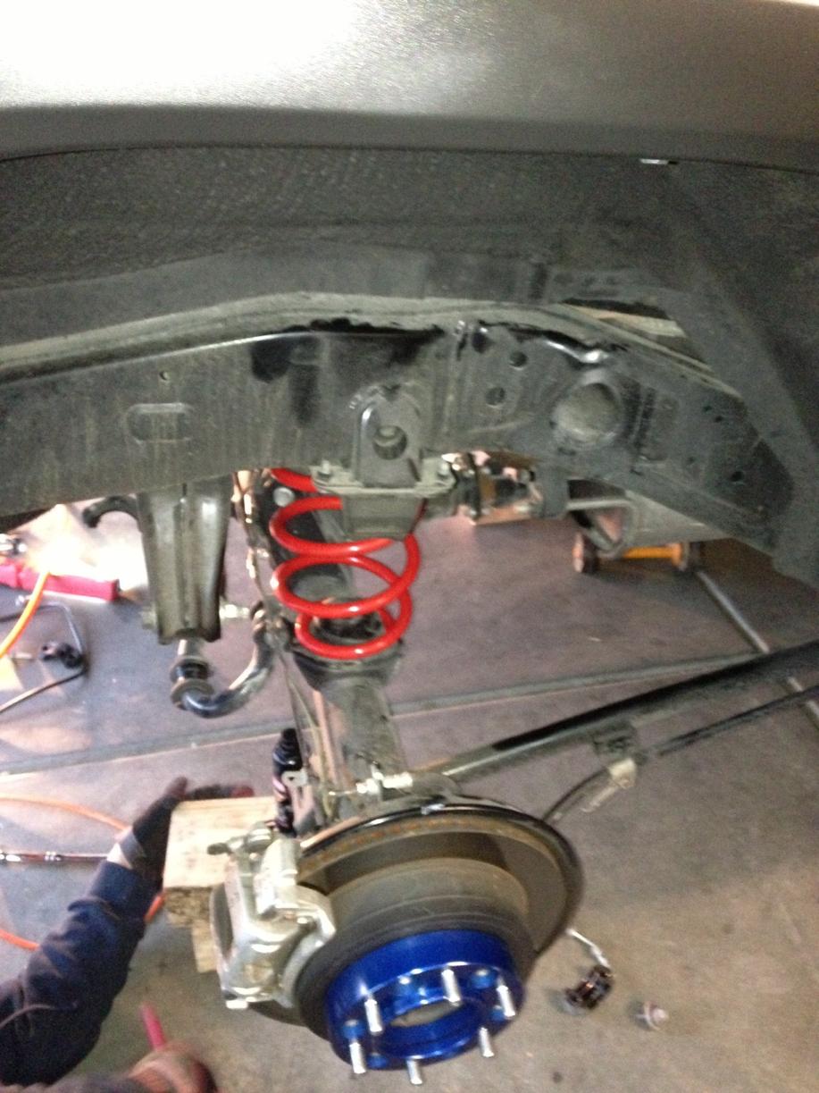

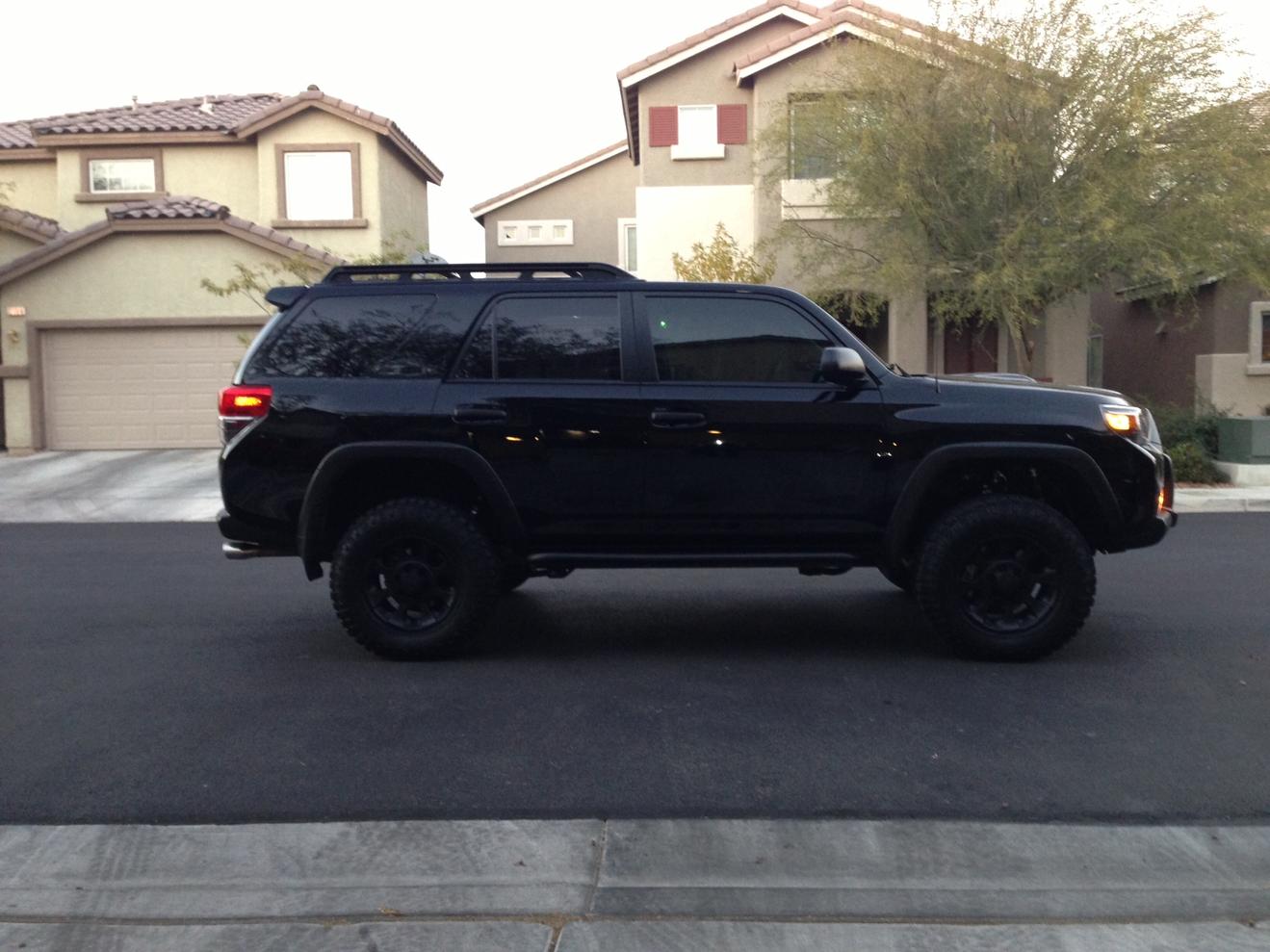

Lift all done... still need to adjust the height on the coil-overs and drive around for a minute to get the suspension to settle...then off to get the alignment... please feel free to look at the pics and tell me If I have the UCA upside down or anything like that...

Looks amazing Vegas! All of my parts have arrived as well, and def looking forward / nervous as hell to dive into this install! Did you modify the remote resi bracket on the passenger side (like Bobby (Ducmonsta) did for Jango)? Feel free to send me a PM or I'm sure I may just be calling you at some point in the next few weeks (not if, but when) I reach an "oh sh*t" moment. But don't worry, I think we speak the same language. I'll be describing things as "big heavy long things" (what, that's what he said?), PITA bolts, and kanipler pins and kanofalator boxes, and of course the johnson rods... :cheers:
Thanks... No have haven't messed with the remote res location... They are staying put so far so I don't want to mess with it. I did just go through and retorque all the bolts and try to adjust the coil-overs and I am getting the alignment done as I write this. Take your time and reread all the post on this forum and the fj site and you will be fine. PM if you have any questions but I really don't know what I am doing... For example I think I attached and reattached the rear sway bar a couple times... Also be careful of replacing the bolts on the factory skid plate.. (I am trying this app to post this so I can't see your signature so I am not sure which model you have) but I stripped one of the skid plate bolts, it happened to be the very last bolt I had to put back on... I think I read a few others did the same thing... Get lots and lots of blocks of wood and a couple jacks and jack stands will make your life better... I completely forgot about the bottle jack that comes with the truck I bought one at Sears.
