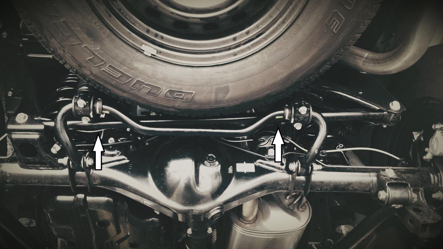

I got the icon stage 3 lift and had it installed, but I was told that the rear sway bar hits the suspension (?) when it bottoms out (??)
The two mounts bolted on to the KDSS that hits the rear trac bar.. when I droop. So I am totally confused, does everyone else have this problem. Or did someone mess up on the install ? Sorry if this is patently stupid a question, but I figured asking can't hurt.

you sure it's a "Stage 3"? those look like the OEM lower links.
I got metal tech lower links, so I guess its not icons links per se. The rest was the following

Are you sure it actually hits, or just get's really, really close? Mine looks like it is sitting on the bar at full droop, but there are no impact marks, and no nasty noises when catching a little air.
Yes, when I installed my lift and had everything dropped out, the panhard and sway bar were hitting, potentially limiting further travel. Will be looking into ditching the KDSS in the future. Damn, could have saved money had I known earlier.

[MENTION=78273]Jeremy556[/MENTION] - Def has a loud clang when I hit a ditch at a higher speed.. not very pleasant :( I haven't done anything offroad yet, since I just got it 3 days ago..

When I installed my All Pro rear springs I messed with the suspension a little to see full droop on the rear kdss sway bar. I noticed when I lifted the rear end up by the bumper using a jack the panhard bar made contact with the sway bar.
I took notice because of the noise it was making.

" No, they changed the track bar. So any coil will do this" - ICON ... I am told their engineering team is looking into this, so I will update this as and when I hear anything.
