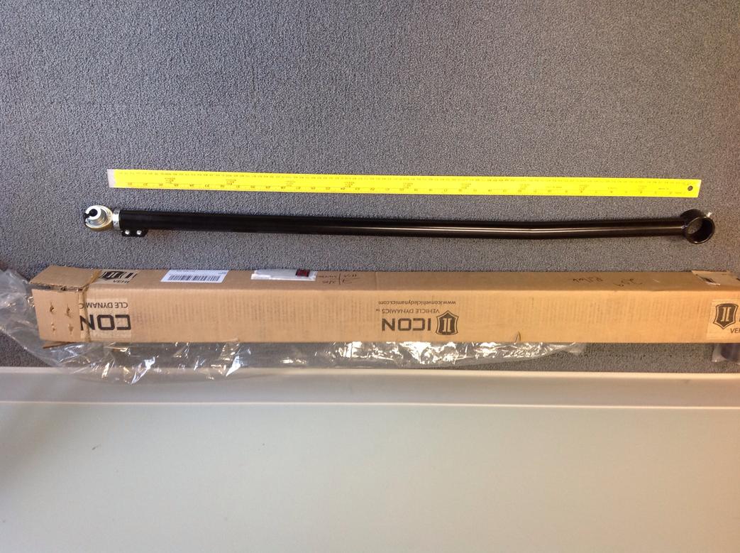

FINAL UPDATE : So this is from ICON :
With the new KDSS style suspension we found that the track bar needs to have a 5 degree bend in it. So we basically redesigning the track bar. This process is going to take about 3 weeks to complete. Engineering says you are fine to drive your vehicle with the clunk it makes at droop. It will not do any damage.
- ICON

dammit. pretty sure i saw someone posted a pic the other day that must've/might've been the redesigned ICON track bar.
i've looked but can't find it now. anyone else see that? :shrug:

so, [MENTION=109391]st8rocks[/MENTION] what can you tell us about the new track bar?
Works great! And one side has a greaseable bushing.
