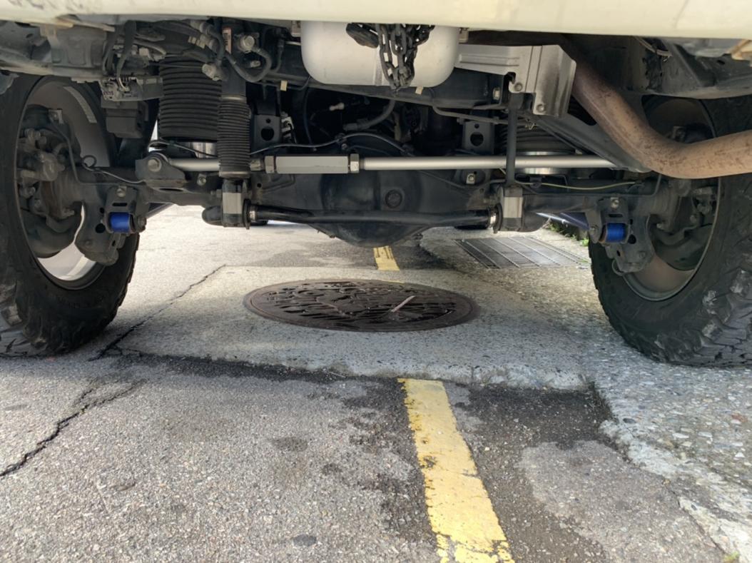

Though my car is a LC150 Prado KDSS model instead of 4Runner Trail, but the suspension is almost the same except for using air bags instead of springs in the rear.
I did my 2” lift with KDSS pads designed by myself. By lowering the sway bar, I think it will have better articulation for off-roads, and better sway bar angle for on-roads.
