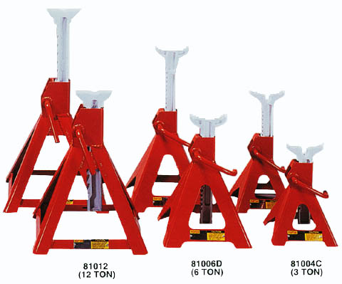

Out of curiosity, what jack stands and floor jack (manufacturer, weight rating) are you using? Do you leave any big wooden blocks or floor jacks under the frame as a backup measure?
I'll probably be doing some work on my 4runner this weekend. Just wanted to know what tools have been working for others. I did try lifting up my 4runner with a friend's floor jack; i got one wheel airborne, but it seemed like the frame was on the verge of slipping off because of the angle.
You'll want 6 ton jack stands. The larger foot print makes them much more stable/safer. I use a 3.5 ton and 2 ton floor jack - 3.5 ton for lifting the vehicle, 2 ton for cycling suspension, holding skid plates up, etc.
i'll be using 3 ton stands and a 2.5 ton jack.

Not that I want to start an argument on this, but what is the consensus on this issue?
A 6 ton jack is rated to hold the weight of the entire vehicle. Theoretically, though, if you jack up the vehicle one corner at a time, with wheels still on, any one jack stand you use will only be supporting about 1/4 of the vehicle's weight (which means something like a 3 ton jack should suffice).
What do people use? A full 6 ton for added measure? Or a 3 ton, with the expectation that it will only be supporting part of the vehicle's weight?
I use 6 tons, not really for the weight rating, but for the lift height and larger base, which makes them far more stable, especially when lifting higher. With 3 ton jack stands supporting the frame, it wouldn't be difficult to tip them over while prying on the suspension components to get springs to fit or sway bars aligned. I speak from experience on this one :redface:
As far as the 3.5 ton jack, it is just much larger/stronger/easier to lift the entire front or rear of the vehicle at one time. The smaller jack I use to move around the suspension and lift parts as it is smaller/lighter/easier to maneuver. You don't "need" a 3.5 ton jack, it simply makes some tasks much easier.
i had this same conversation with a coworker and you mentioned the same things I did. 2 ton (4k lbs) jack stands should be more than sufficient but at the same time, always bette to be safe than sorry. I have experienced a few friends who didn't opt for the safe approach deal with the consequences.
