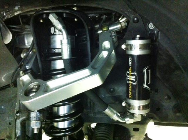

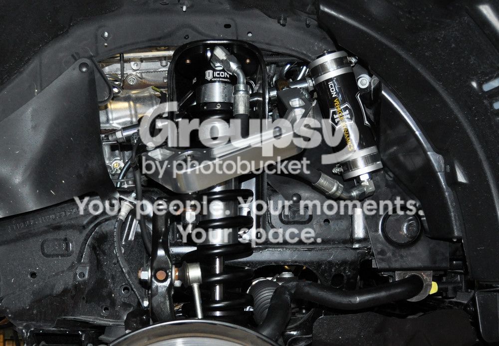

We just did Jaker's stage 6 and here's a pic of it fitting and shows where the bracket attaches for a Limited/SR5....

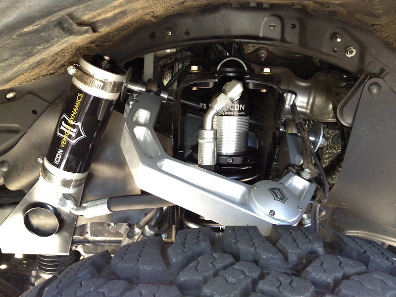

Just trim and the bracket! Same issue with mine in the right front, but a few cuts to the bracket and it was done.
