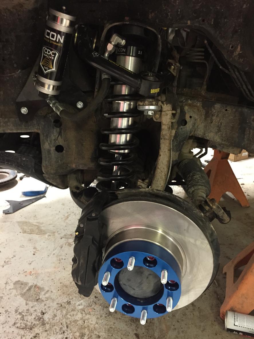

Here's a photo of my coilovers and UCA's.
