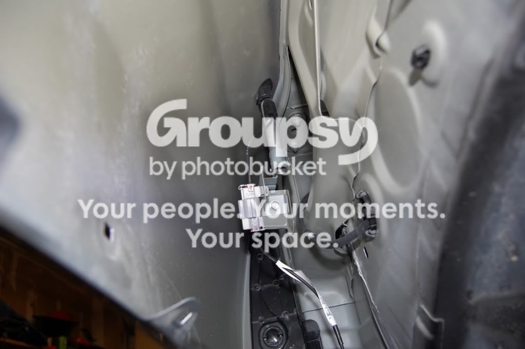

Did I Break Antenna
All - new to the forum. Recently picked up a '11 LE. Read feedback on this forum regarding Pilot ANT-029B antenna and purchased one. When removing stock antenna with wrench, it just kept turning. I finally pulled out the rubber guard and had to use a wrench and pliers to unscrew from brass base. After installing Pilot antenna, no signal. Reinstalled stock antenna, no signal. Any ideas? Thx
Bummer....It is powered and you probably broke one or both wires off. You'll have to take the plastic inner fender liner off or loose to get to it.
Here's a pic of the antenna on the inside the fender.
insidefender.jpg~original
