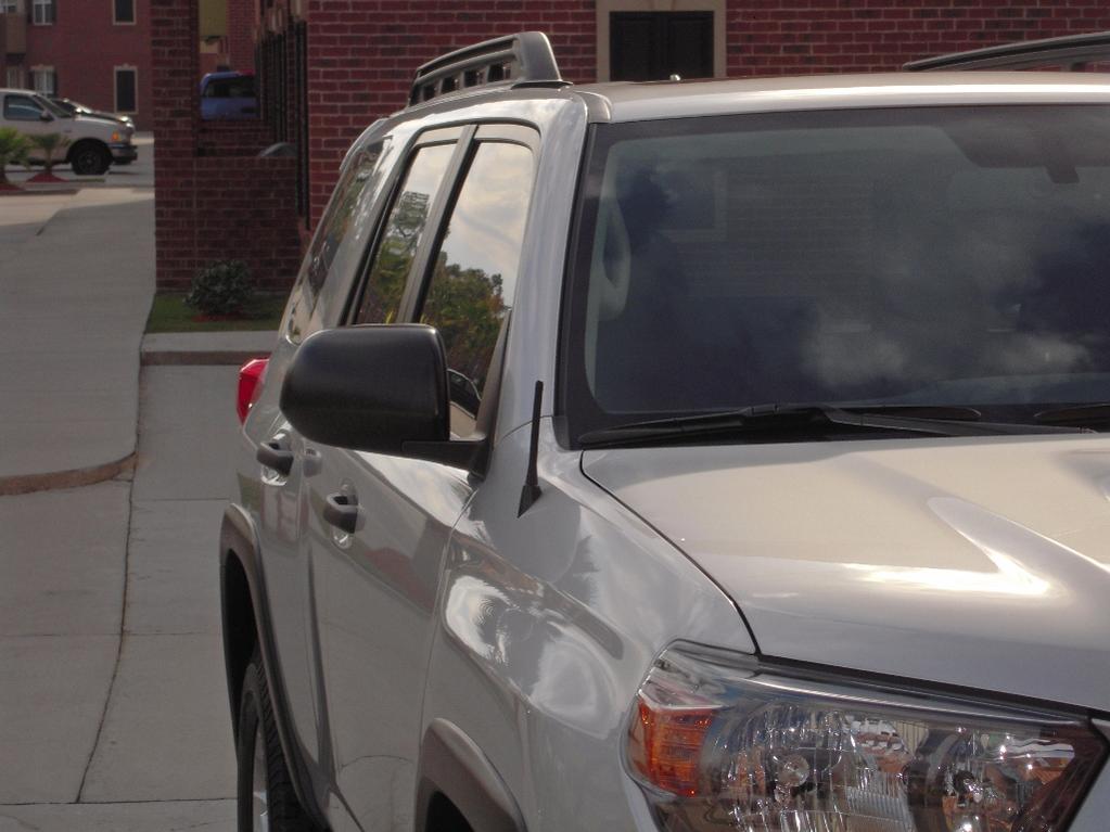

Here's my short antenna mod. I cut and rounded the tip of the OEM antenna with a Dremel and painted it.

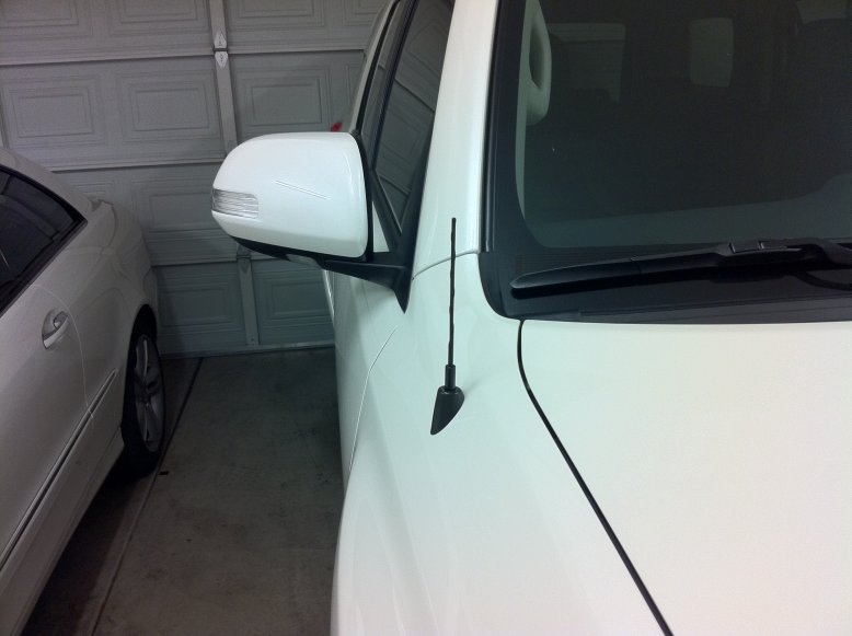

Picked up the Autozone antenna mentioned above for the base attachement. Put base attachment on to Mangowalk 5" and on to truck!
Works great! Haven't noticed any difference in radio reception yet!

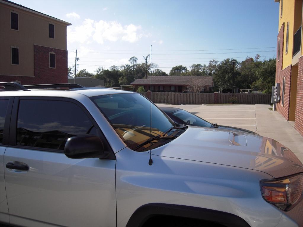

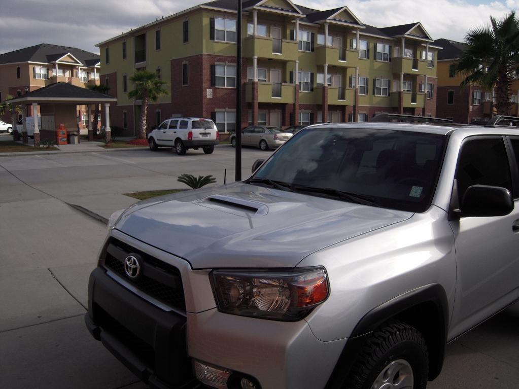

Before & After

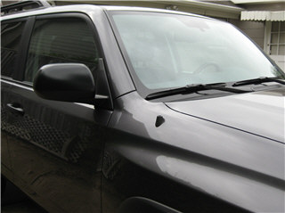

I listen to XM, iPhone via Bluetooth, and iPod in the glove box. I dont use the FM or AM at all, so I removed the antenna and stowed it under the rear seats. I plugged the hole with an automotive-style christmas tree fastener. :nerd:
^^ Looks clean! I think it might still be possible to pick up the stations that are real close to you still. But with USB, bluetooth and SAT, I rarely use FM/AM anymore either.

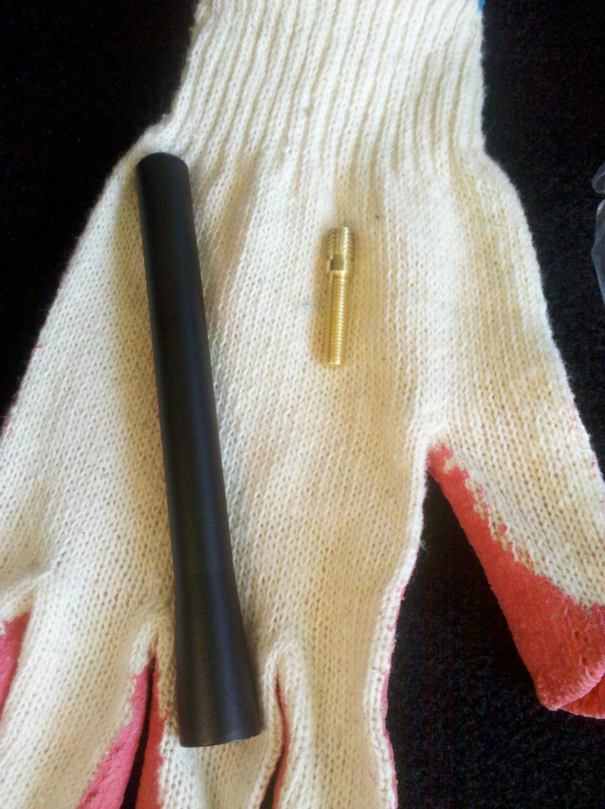

Hi, I just put on one I ordered through EBay and I can't tell the difference from the original reception wise. I found it by searching Toyota T100 antennas, it's the 14" billet aluminum one, a whopping $7.25, looks fine, even comes with a couple of adaptors. I'll have to trim the correct adaptor an 1/8" inch or so to get it to seat just right but no big deal.
Thanks for the inspiration apenso:
I found the part required at my local Autozone. It's a Dorman panel retainer part no. 963-075. It comes in a variety pack and is shown third from the left in that link. It fits really well and the ribs match the threading well enough so that it screws in and stays secured.

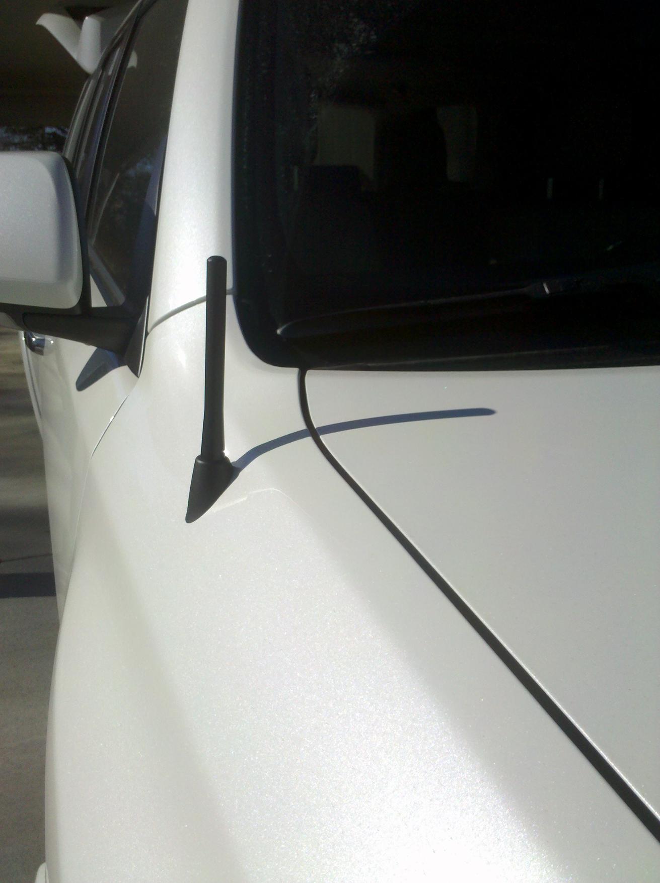

I found this stubby antenna at Pep Boys, fits right out of the box only setting me back $11.99. I live in the DC area and I haven't notice any loss of radio reception.
Got me a '11 BP Limited w/Nav two weeks ago and loving it! I've already added the running boards, cargo cover and this stubby antenna. HID conversion kit in route along with Husky all weather mats and precut tint for the fronts.
Only items left to get is the bull bar and adding led to the cargo area and running boards.
