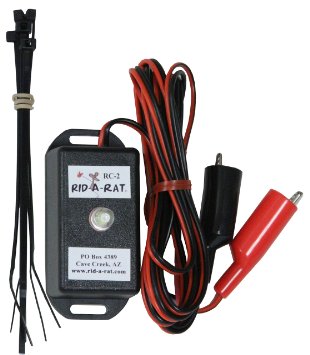

I just installed the rid-a-rat flasher in the engine compartment, after my 4R wires were chewed. My first rid-a-rat flasher was successful in keeping packrats from nesting in a shed, but someone I know used the rid-a-rat flasher for several years before it failed her. One advantage is that the flasher doesn't wear out like odorants. When I'm in packrat territory, I add in Critter Ridder, a pepper-based odorant that comes as liquid spray and solid granules.
