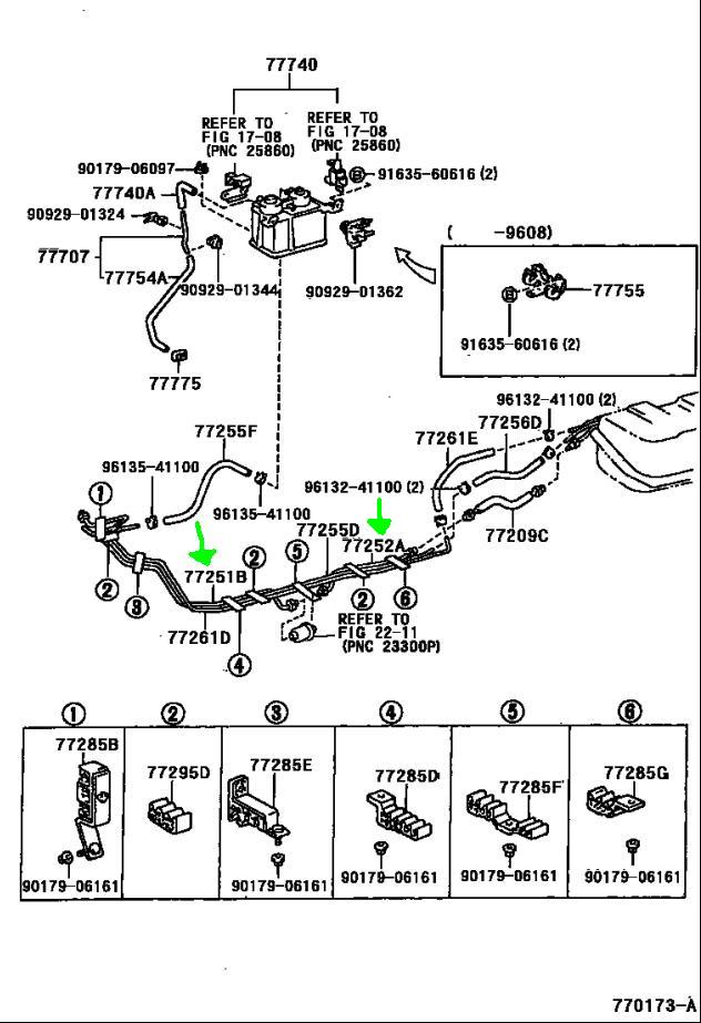

If I ever strip the nuts that screws the fuel lines onto fuel filter
trdrun
Just concern if I ever strip the nuts that screws the fuel lines onto fuel filter.
Are these the correct parts (see image)?
77251B and 77252A
Yes, looks to be.This actually happened to me this week .However I only had to cut the line on the engine side though.I just bought a 14mm fuel line fitting with some 5/16 steel tubing + some -6an SS braided hose I had laying around and took care of it that way. I'll try and post up a pic tonight or tommorow.
Yes, they are.77251‑3D140 and 77252‑35350 are the part numbers. I hope my exhibit shows up.
Always attach the two metal lines to the filter and then mount the filter to the truck. You cannot go wrong.

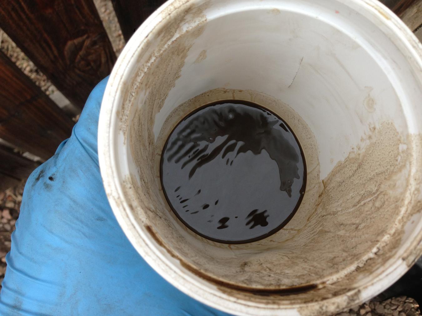

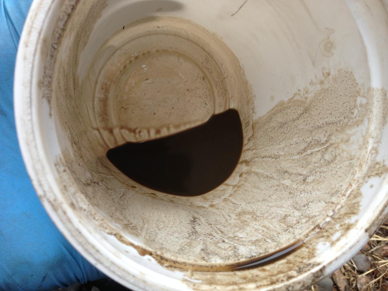

Don't hold your breath but if I get time I'll crack my fuel lines open tomorrow and drain a bit of fuel out of my 215k old filter. If you are getting that much contamination into the filter then I hope you have dropped the tank to inspect it for debris and to replace the pre filter on the pump itself. That is far from normal. By the way where do you buy fuel so I know to stay away from there.
Thats good advice. Thanks.
Good reason to go ahead and replace my fuel sender bc gas gauge is wonky (TSB EL010-00). I'll let you know what i find inside tank. Most 4R filter change write ups say they find the same residue, some have photos. Mine may be especially dark because 14 years, 180,000 miles, original filter, dry dusty Denver. Please post a photo of what comes out of your filter.
