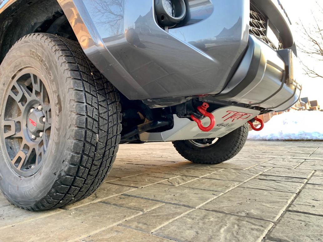

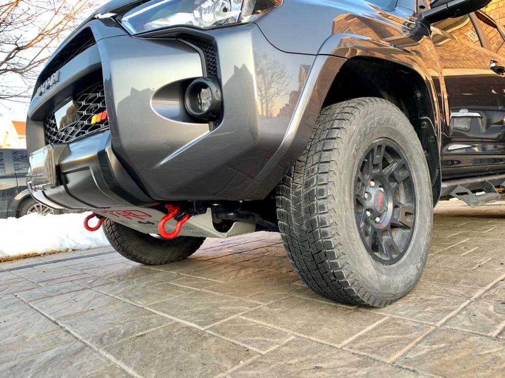

i didn't have any issues using the bolts hat came with the Pro skids. took out radiator support brackets and the Pro skid fit perfectly with the supplied bolts. took specified Torque too. this is my 2020 TRD OffRoad with KDSS. The SKID itself is from 2019-2020 model with plastic letters.
