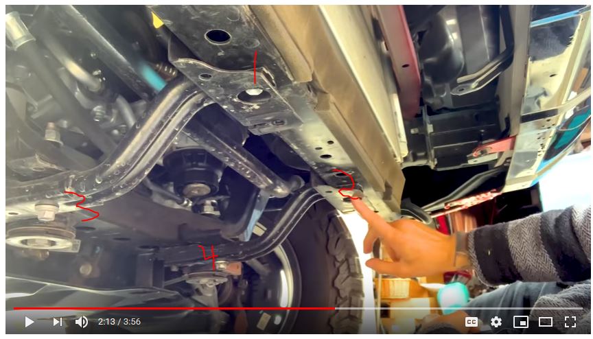

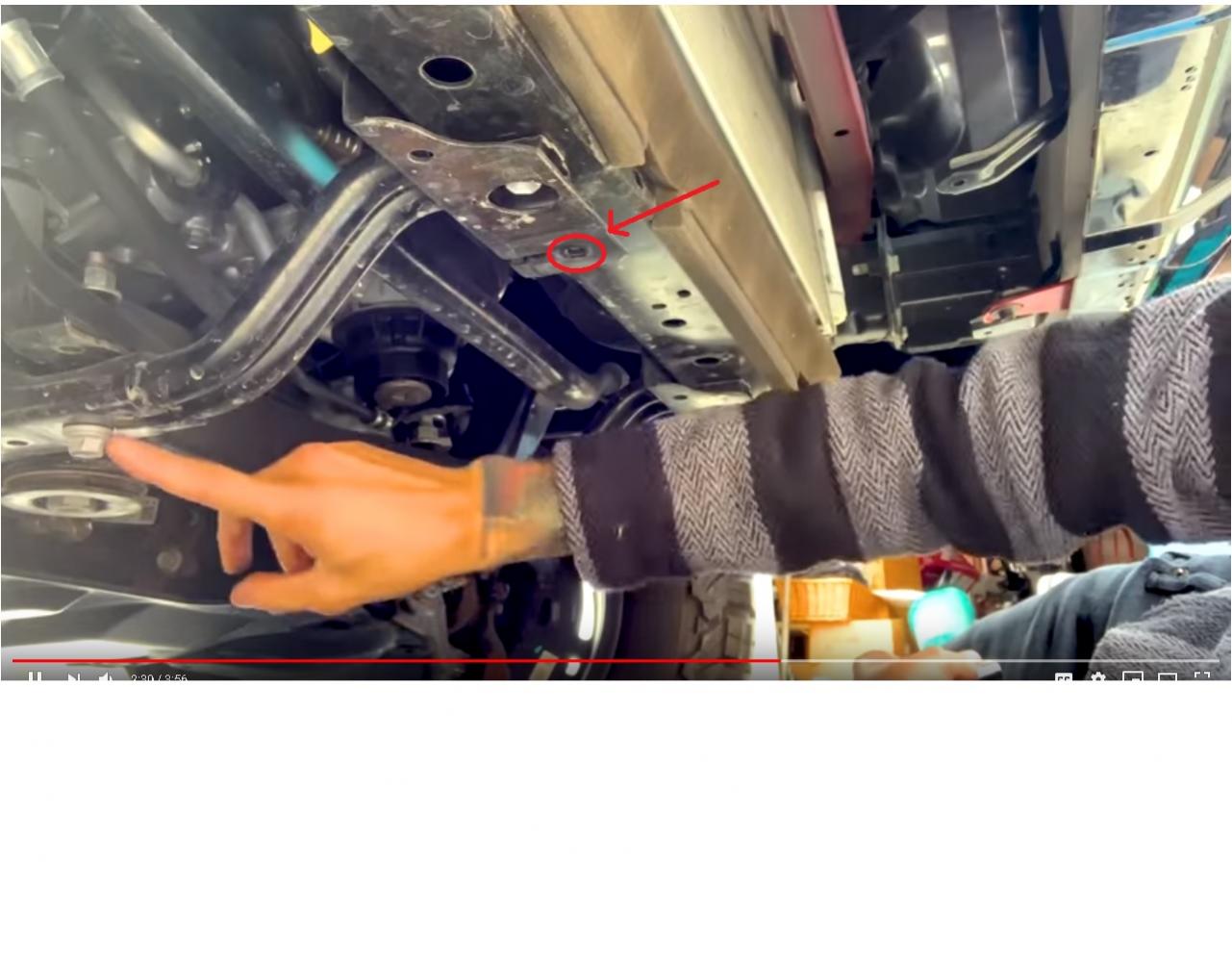

Re-watch this video. I think you're working on the wrong holes in the frame.
YouTube
I re-used the rear 2 bolts. #3 & #4 in this pic. I broke off the fasteners (or spacers) holding the 2 large front bolts to the skid and connected those bolts to the front two holes (#1 & #2) in the frame.

Oh shit. No joke. I have been using the wrong holes.
I assumed you were supposed to use the holes the skid plate was originally mounted on.
Holy shit. How do I send you beer?!!

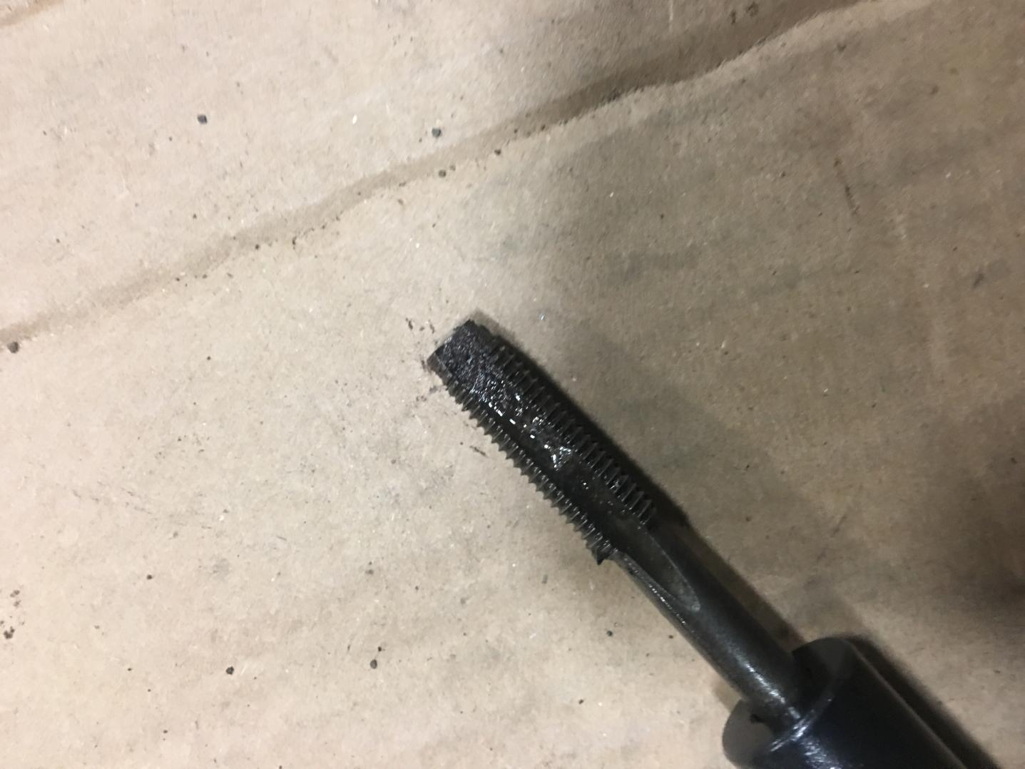

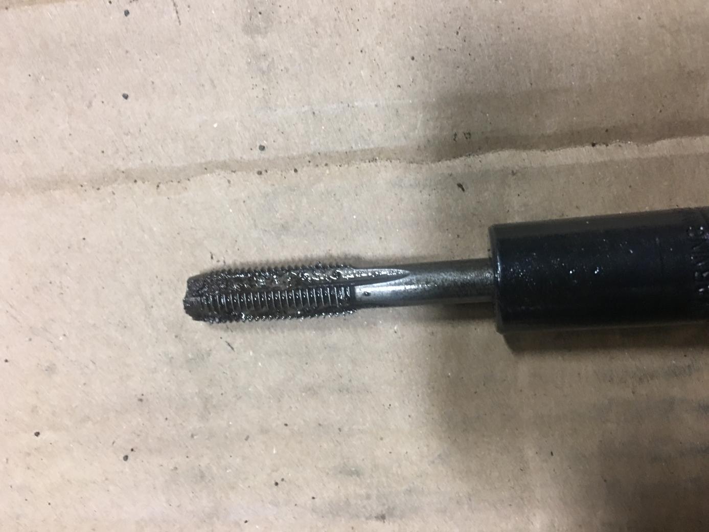

I installed my TRD skid last night on my SR5 and this thread was a major time saver. THANKS!! its a 2018 and I couldn't believe the amount of crud I got out of ALL 4 holes even though there were bolts in them AND I did try to just spray lube on the new bolts, screw them in and bypass the tap out step, NOPE, it didn't work, I had to tap all 4 holes out. when I installed my sliders a few weeks ago I tapped all 12 holes and got a ton of crud out of them too so I shouldn't of been surprised the skid holes were full of crud.
