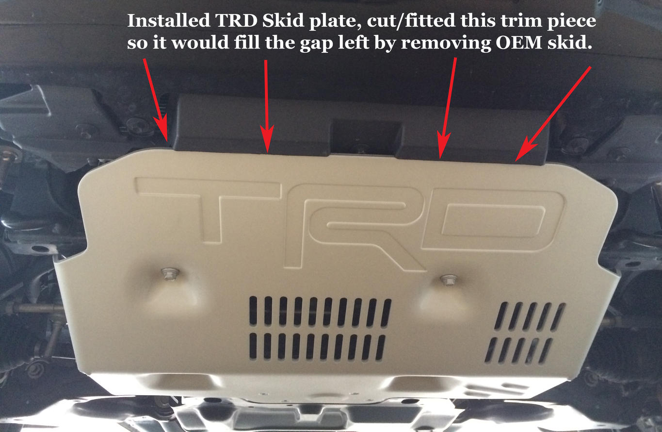

Just got a TRD skid, the only thing I don't like is the gap where the plastic OEM cover was located. Anyone have any additional pics of the way you cut yours to use with the TRD skid?
The instructions say to delete the plastic piece but I just trimmed mine back in the middle. Some airflow into the radiator may be retained.
Check this:
https://www.toyota-4runner.org/1798124-post58.html
130770d1411079106-trd-pro-parts-trd-skid-t4r_1-jpg
After researching this I'm just going to leave the plastic shield on without any cutting or trimming, just going to bolt the TRD skid right over the plastic. This seems like the best move, with my luck I would have a branch go right thru my radiator on the first day if left it off...
