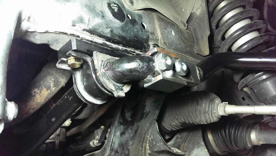

I have not had much time for this lately.. lots of stuff going on with the family.... but got the first rev done and started some test fitting tonight.
I still need to finish making the hardware. Planning on spline drive bolts but need to get my lathe out to get the clearance I want... also need to experiment with some other options.
$150 invested so far and it looks very promising. Tolerances are super tight (which is good and bad) I might need to loosen it up a bit to make removal/install easier (it require a hammer at the moment).
I also still need to come up with the link disconnect.
Anyway, here is a pic. Will be interesting to see how it clears everything. Might have lost 1/4 inch of scrub angle at most. Appears to be extremely solid but road testing will be required...
If anyone has a link quick disconnect lying around... let me know.

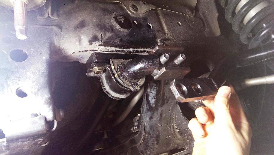

Quick update on this. I installed the swaybar and ran around town with it on today. I also took it on and off a few times...
Results so far are fantastic.
  • Body control is great as expected.. just like having a regular swaybar
  • Disconnected it flexes just like no sway bar on
  • Removal takes minutes (maybe 3) much faster than airing down
  • Installs in minutes (about the time it takes to air up 1 tire)
  • No tire rubbing on scrub angles so far, looks like plenty of clearance
Still a little concerned about long term durability, but really no way to verify that without more use.
It's nice not driving a boat on the road ;-)

There are plenty of threads (about .40" of contact). It is a canonical seat (so most of the contact is below the surface). I'm torquing to ~80 ft /lbs... The studs are wheel studs.
The bolts are just much bigger than necessary (I may machine them down some more). I had some very small open spline drives on there that I machined, but they felt too flimsy. I want to be able to take them on and off with an impact gun with no worries.
Looks like a great setup, i see what your saying about the contact. I guess i am just old school, i have trouble if i can't see the end of the bolt at least flush with the nut. LOL
Looks awesome!
The conical seats and lugnuts is great solution to that joint. I think that design will last for a very long time compared to the other versions that rely on precise machined fit.
Why didn't you just get KDSS?! Haha - had to say it.
Looks good. It's nice when a project comes to completion. Keep us posted on long term operating and durability results.

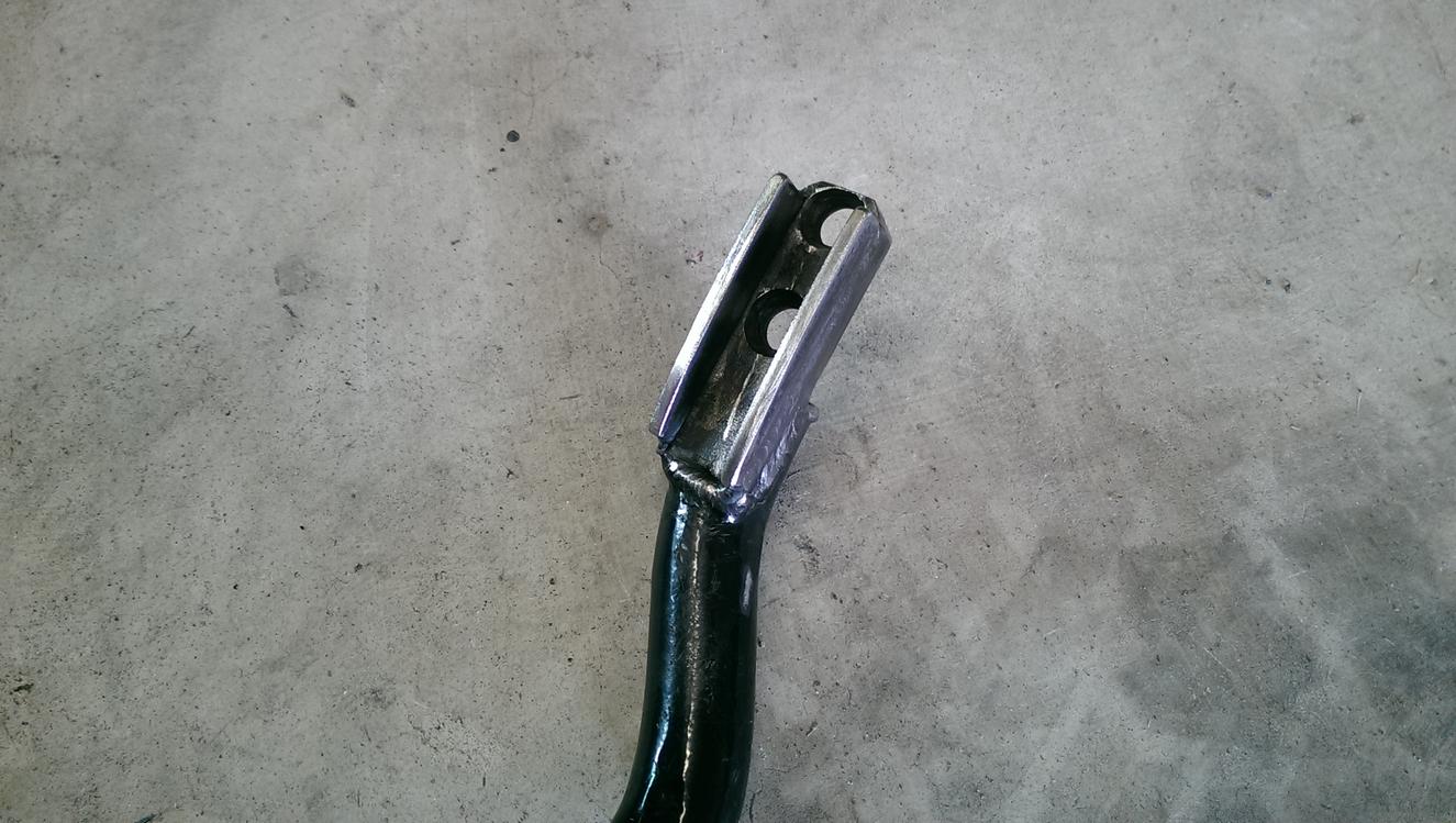

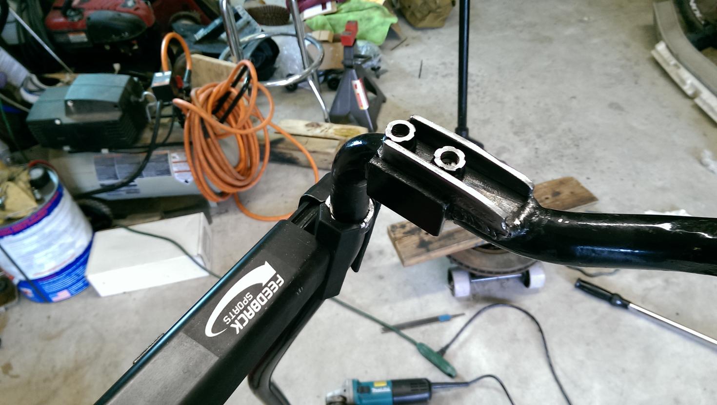

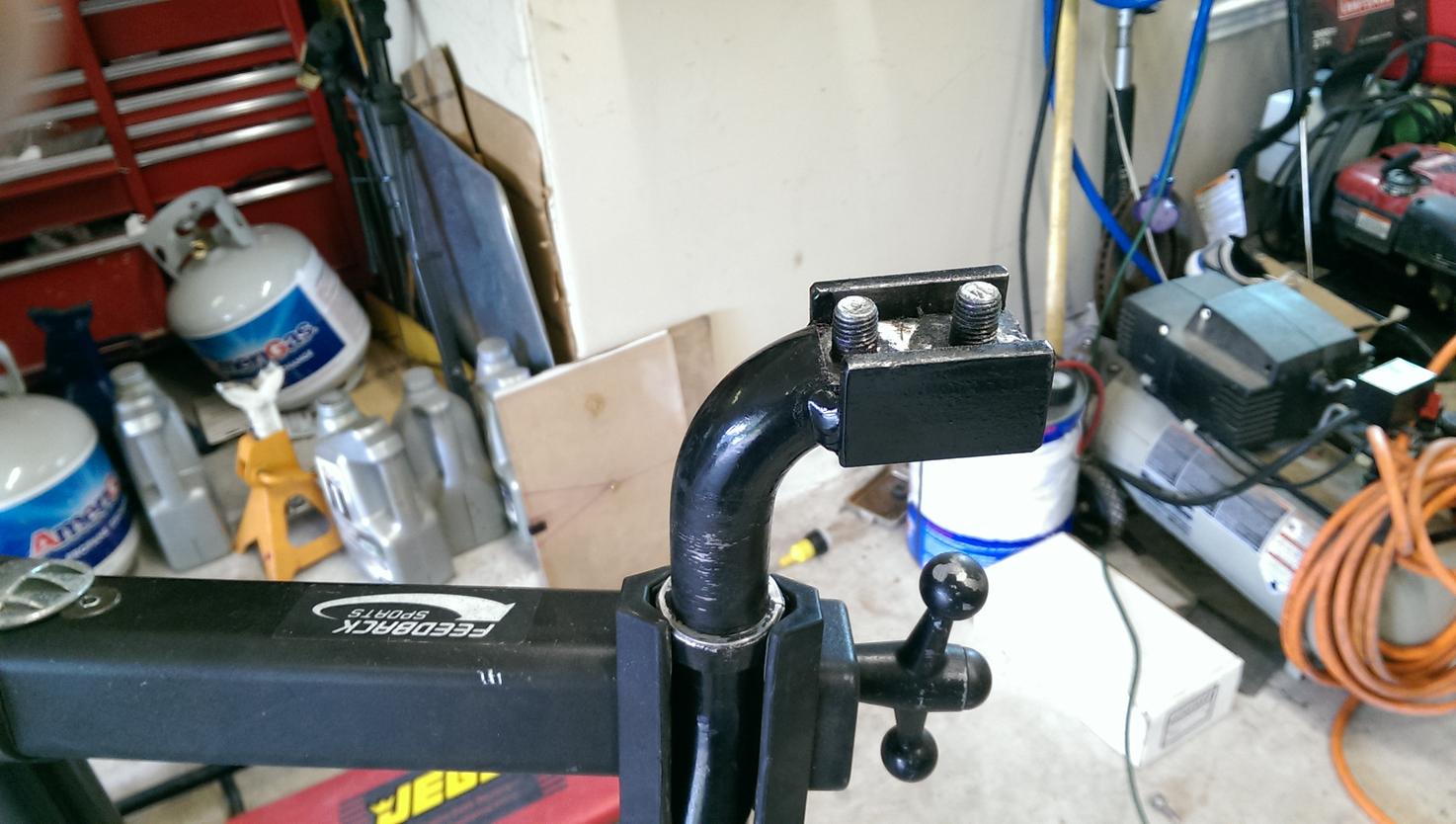

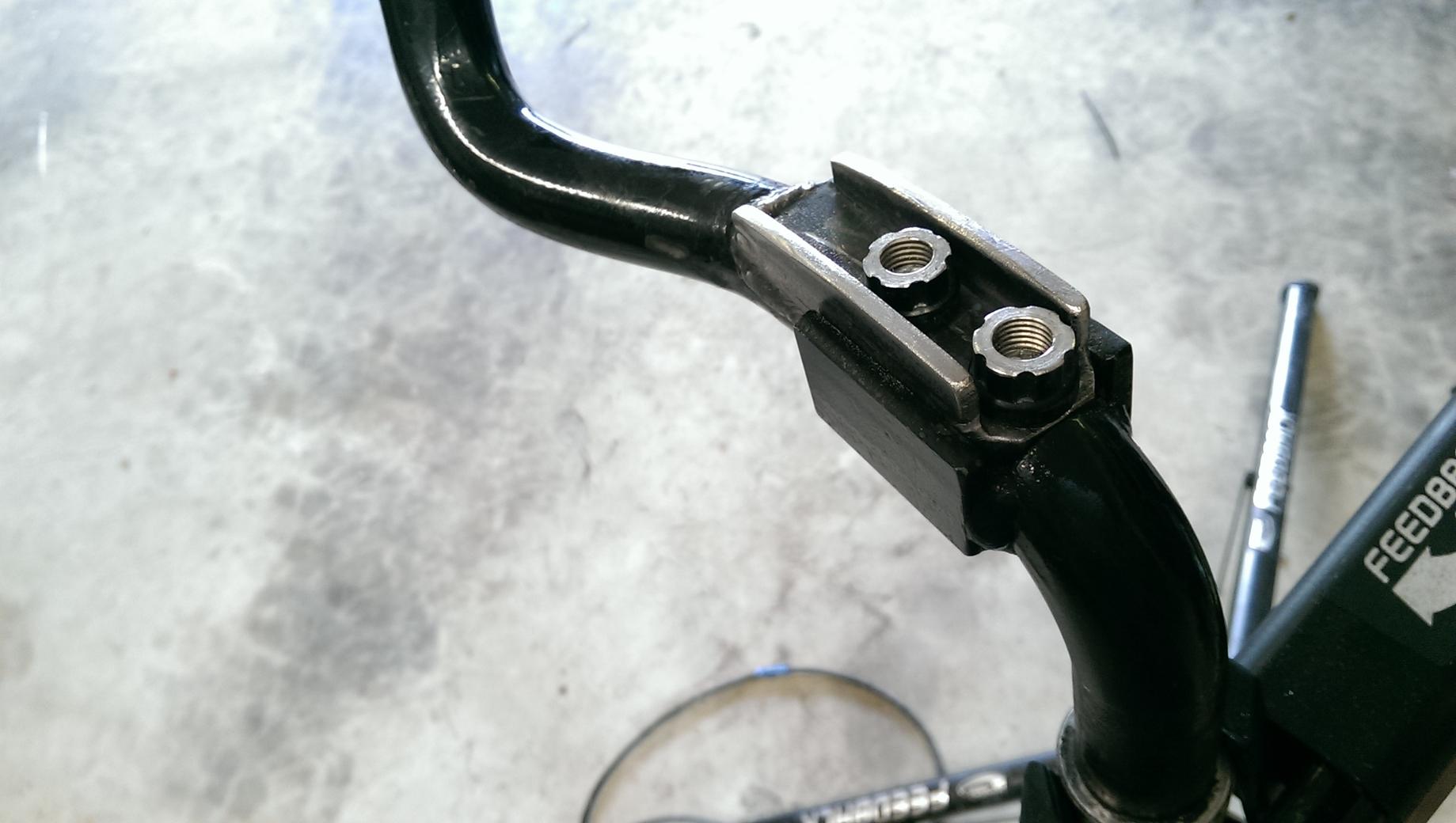

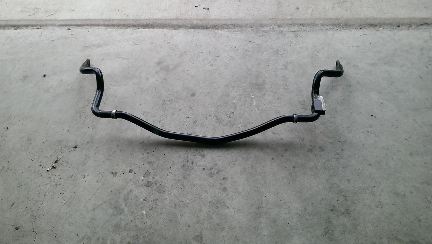

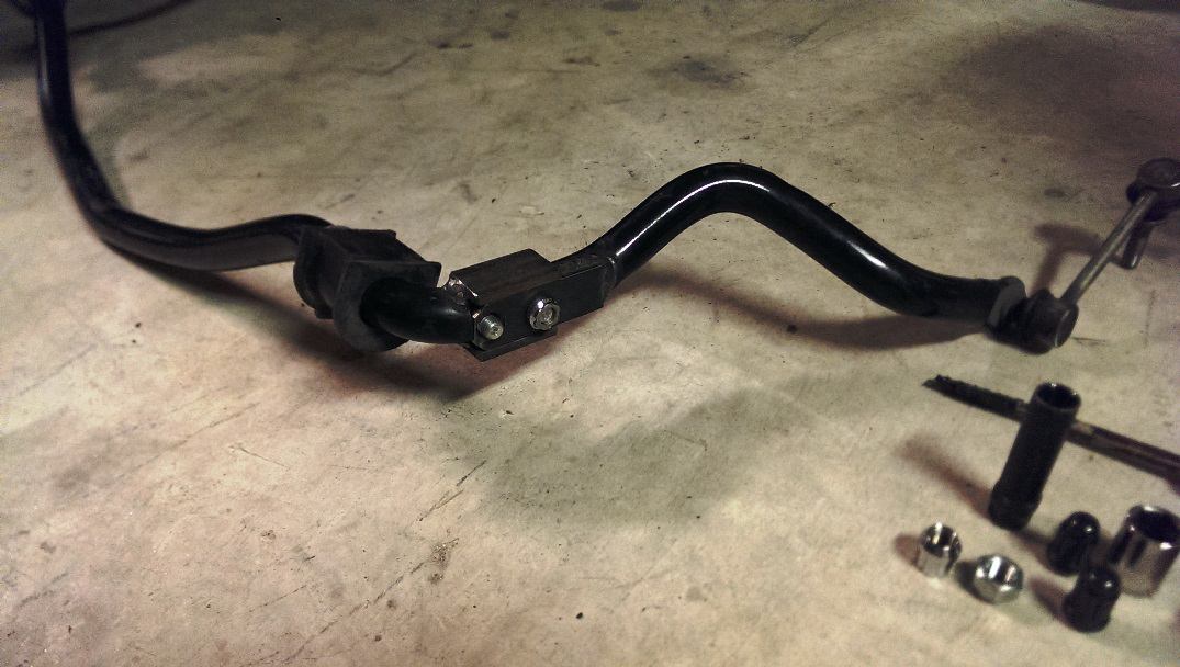

I've been working on the second rev... This has taken quite a bit of time.
This one includes gussets on the disconnecting arm for lateral outboard loads at the connection point. The challenge was fitting bolts with the gussets, so I machined some spline drives on the lathe.
Still need to verify clearance on the truck, but it should be fine. since I measured all my scrub angles beforehand.
I took pictures before painting, since it is really hard to see when it is all black...

The second revision looks good, the spline drive nuts are an interesting solution. Though aside from what I mentioned before about metallurgy differences earlier in the thread, that thread engagement seems very light.
Good looking bar none the less! Be interesting to see what other design avenues you take later down the road. (Making me want to get around to revisiting my original design.)
Thread engagement is fine, It is just deceiving in the pictures due to the seats being so deep.
I'm pretty confident this will hold up to typical use (on road and light off-road). What I'm not confident of is it holding up to rock crawling conditions while connected. I've bent links into noodles before doing that.
There are things I would like to have done differently, but I've got other higher priorities projects at the moment.
The bends and space constraints with this bar make it a huge challenge to come up with a really elegant design.
Anyway, I'll report back in a few months after more testing.

Yea, removal is very easy. Park on somewhat even ground then I just turn the wheel to full lock passenger, reach behind the wheel and remove the link bolt on the back of the spindle.
Then I turn the wheel straight, (or lock to driver) and remove the two spline drive bolts on the bar. Then that driver side arm comes right out. The truck then effectively has no sway bar. The connected side simply moves without any torsional resistance whatsoever.
