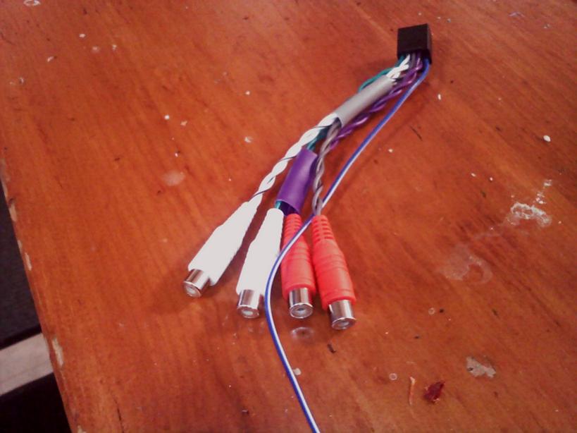

This is the wire set that came with the amp you suggested Brian.
It runs into the amp from the HU for the speakers. So these are rca female jacks, and so are the corresponding jackes in my HU. Ive looked and looked online, and I havent seen any cables with male rca jacks on both ends. So how would I go about connecting these to my HU? I saw male rca jacks without cables that you crimp yourself. Should I just buy 8 of those and crimp them to 4 wires?

Do you meant that is wiring connector for the Alpine Power Pack? Please clarify. I have never seen one in person.
Male to Male RCAs .... easy.
Don't cut or crimp any RCA cables.
Buy two pairs of these from this exact link:

You really want a decent shielded audio cable. Buy these Monster cables. They are shielded and only 3 feet each. You don't need a long cable correct? I assume you are putting the power pack in behind the stereo. There is a lot of room in there. If you decide to put it under the front seat then you will probably want 6 foot cables.
It is a good idea to get the shortest workable cable length.
Well, I didnt see this post until after I found a set of rca wires on ebay and bought them. I went with 10 ft cause I wasnt sure where I wanted to mount the amp. But they are JL audio gold plated jacks, and were fairly pricey so I think theyll work well.
