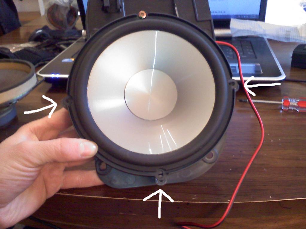

Am I missing something here?? I ordered the Infinity Reference 6.5" system on Amazon from an exact link that I found here on the forum. So take a look at this . . .
The holes do not line up at all. Theyre off by half a cm. The only way to get them to line up is to bend the plastic like crazy. In fact I couldnt bend it that much by hand. I had to squeeze end to end with a clamp just to get two opposing screws in. And then the other two were gonna be next to impossible to get on, so I didnt even try. I dont want to damage the plastic part or the speakers.
Did you have this issue?

Just drill new holes in the plastic/door. We all do. Start small.
I figured out another way to mount them. I just used washers with the screws to clamp the other three spots. Anyways, I got the passenger side installed and then turned it on to compare them to stock by centering from driver to passenger side. Im not sure whats going on, because the stock speakers sound much better. The new tweeter was louder than the old one, but the stock woofer produced much more sound and hits a lot harder. The bass from the stock speaker actually shakes the door panels. The new one was working, but didnt produce near the power. Whats going on here? Everything was hooked up right. I used the crossover unit. I bought 14 g speaker wire but havent installed it yet. But either way with identical wiring on both sides the stock speakers sounded much much better.

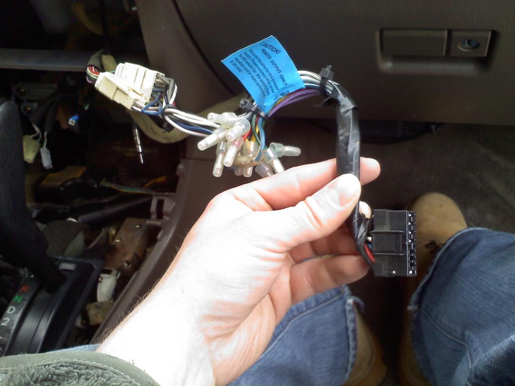

And here we go with more questions . . .
Have a look at these two pictures of wires and HU

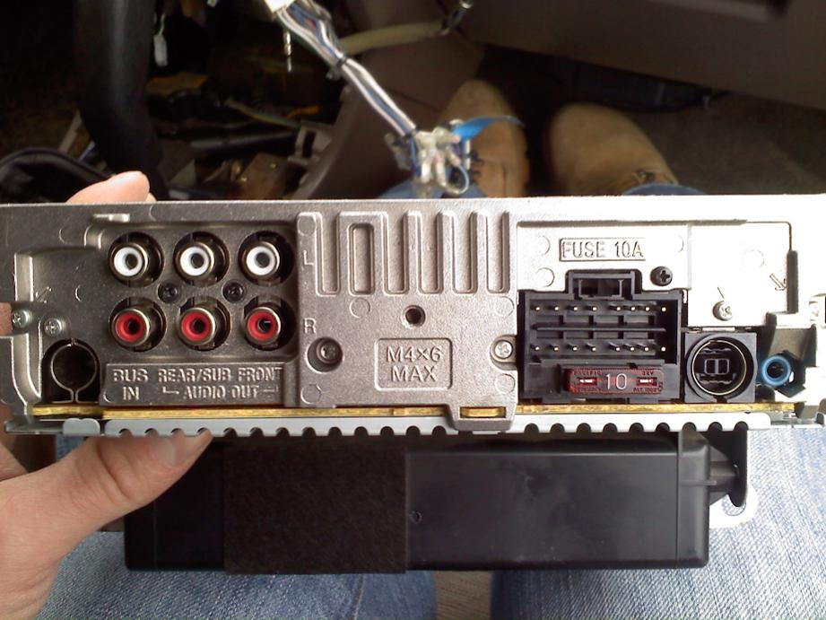

So picture (a) is the set of wires going into my HU, and picture (b) is the back of the HU. Whether or not these have been modified by previous owner I have no idea. You guys would know better than me. So obviously the black connector goes into the black port in the HU. So my question is, how would I rewire that? Do I have to track down one of those connectors and wire the 14 g stuff I bought into it?

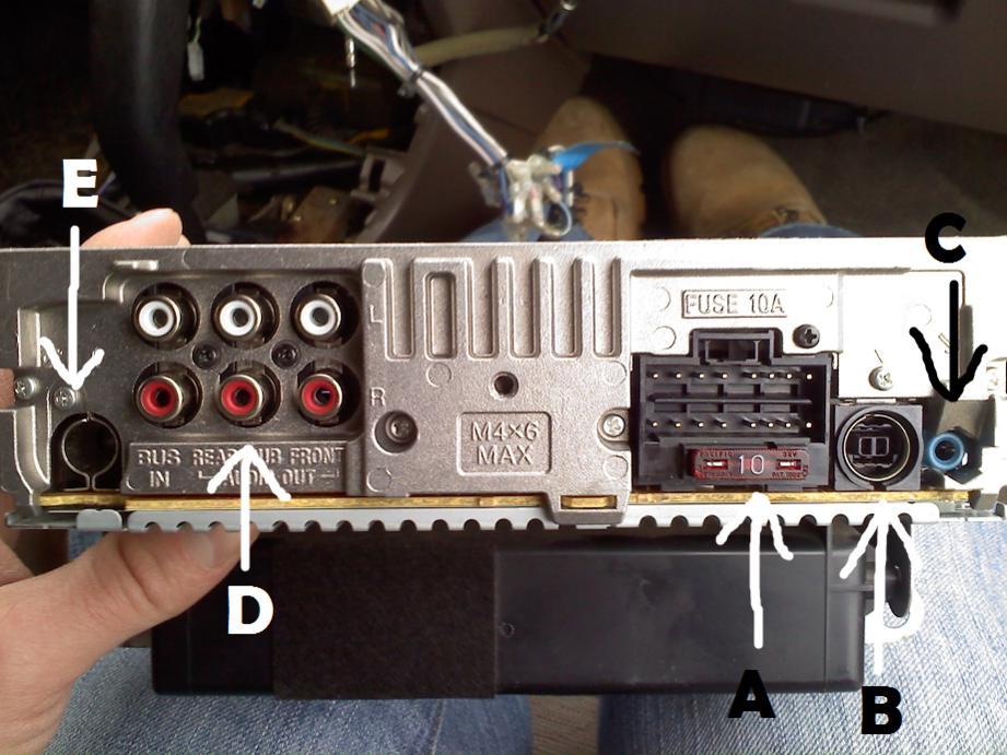

And then this one . . .
So (A) is where my wiring harness plugs in, and I have a cord for (E) as well. These are the only ports being used in the back of the HU. And I only knew to use them because the same ports were being used on the old HU which I replaced. I just copied what I saw.
- In what case would I use the speaker ports at (D)?
- What are (B) and (C) used for?

I have to ask ... Have you done a Google search for the model number of your stereo and the word manual?
The Sony manual is probably online and has pictures for all those ports.
Those are the pre-outs. You have Aux-In on the left and front and rear pre-outs for connecting to an external amplifier. The speakers would then connect to that amp instead of the standard wiring harness.
So you buy the Alpine Universal Power Pack from the link above And connect a RCA cable from the back of the head unit to the power pack (amplifier) then the speakers connect to the power pack instead of your wiring harness.

Actually I just found the manual :behindsofa: I may have forgotten that I had it. hehehe
Buy this --> Alpine KTP-445U 4-channel Power Pack Amplifier:Amazon:Car Electronics
It will work fine with your Sony head unit.
So I think Ive got it all now. Ill still be using the black harness as it contains the wires that power the HU, but the speaker wires running from it will just be empty. Amp plugs into HU pre-outs and then I run my 14 g wire from amp to the Infinity crossovers and rear speakers
Thanks for your help man.
You're on the right track especially if you run new 14G (or 16G really would work) speaker wire from the Alpine power pack to each speaker.
Running the wires are pretty easy and those panels come off with little trouble.
I also really really suggest you run NEW power and ground from the car battery to your SONY & the Alpine power pack. A simple 12G black & red wire from AutoZone will work perfectly for this. Just run 1 (+) and 1 (-) will be fine, you can split them near the deck. Be sure to put a fuse with 1 ft of the battery. Doing this will help to prevent speaker whine (in my opinion) :fish2:
