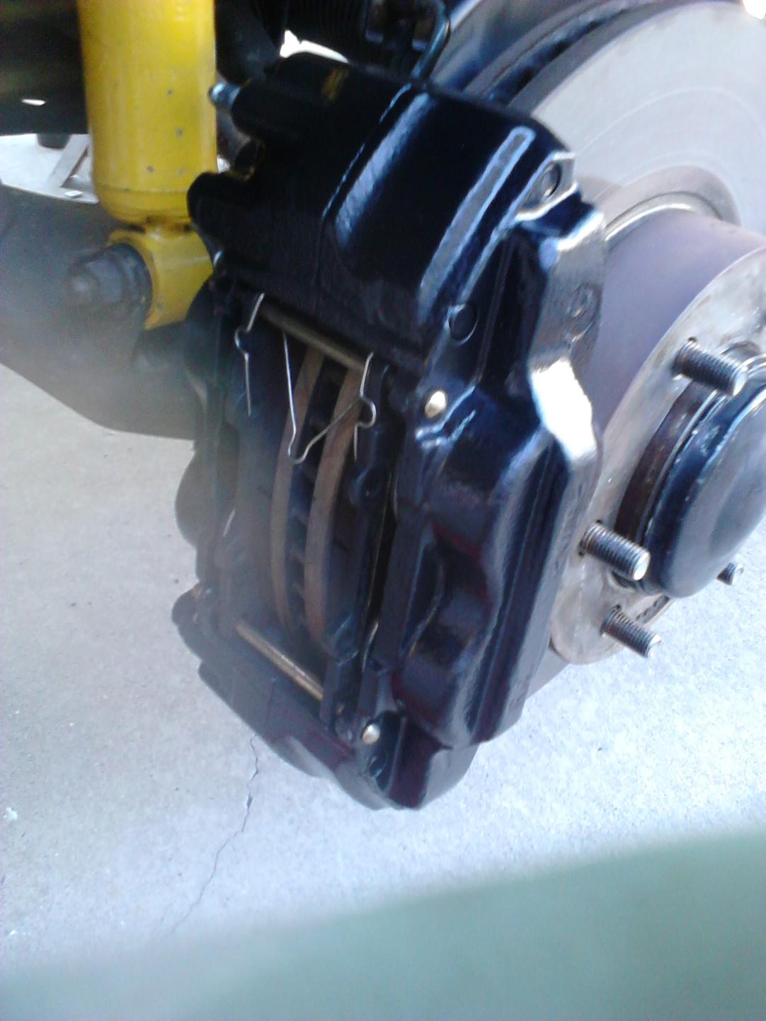

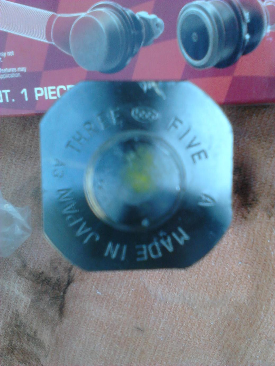

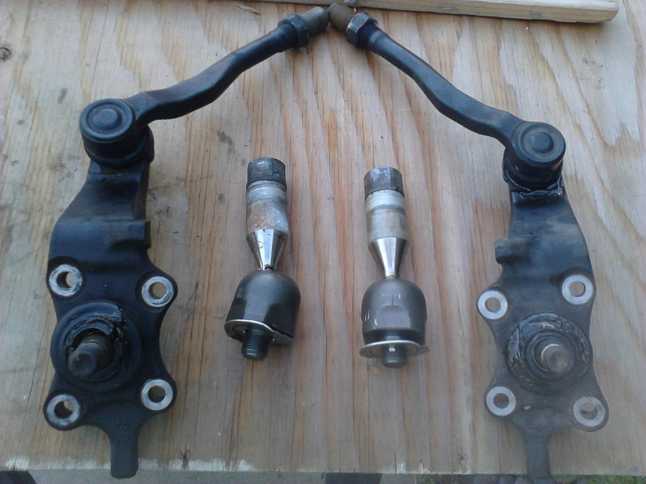

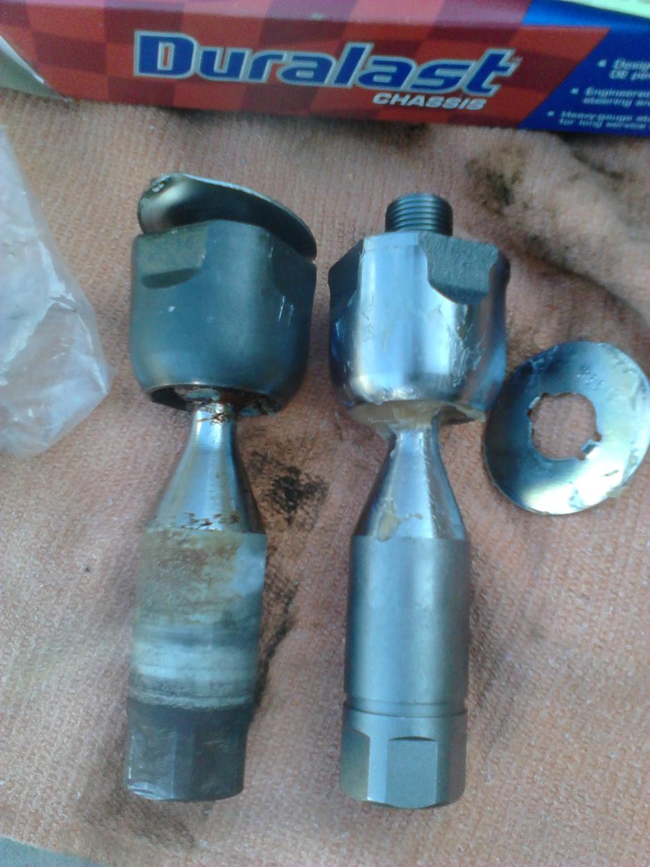

Check this out - Got to 555 brand from Autozone for $27 each. Made in Japan. Just got done changing LBJ, both inner and outer tie rods. Also painted Tundra 231mm brakes.
Camel Toyota - No tax, free shipping
LBJ - $80 each
OTRE - $46 each
Autozone - ITRE - $27

I see the washer is bent down on the ITR next to the steering shaft. I assume that's to keep it from coming loose. Would some blue loctite work just as well? Or would that do more harm that good in that it would put too much stress on the steering shaft when you go to remove the ITR next time you replace it?
Same question for the OTR. Would blue loctite help between the inner and outer tie rods? Or do more harm than good?
Or should I only use blue loctite where the OTR attaches to the LBJ?
don't need it. the washer serves the purpose of locking in the inner. the outer uses the cotter key.
