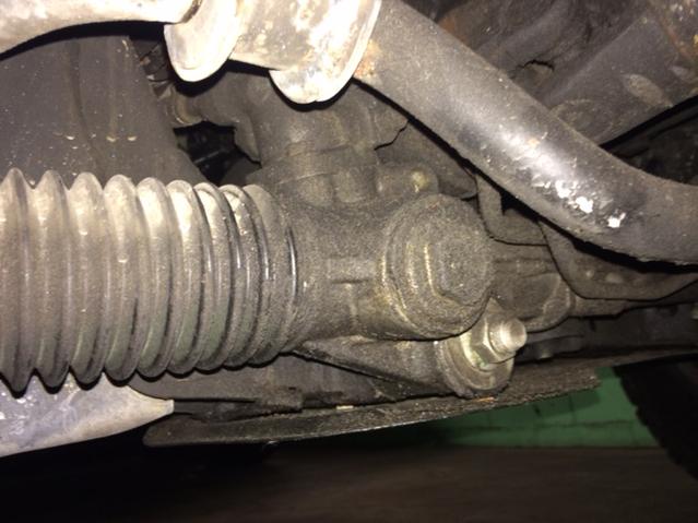

I have all my parts and tools finally for this job but had a quick question for the forum. I noticed quite a bit of grease around the boot near the steering rack. Most of the pics I see of others look fairly clean and dry. Is this normal or is there some other seal or something simple in the rack I should be fixing while I'm in there.

i SECOND this question... my rack is "wet" with what looks to be oil

My rack is oily too. It's just leaky valve covers and probably rear seal for me. The rack are in the perfect spot to collect all the oil and other fluids that drip off the engine.

My valve seals are both leaking pretty bad...
When you say "real seal" are you still referring to the valve covers?
He said "rear seal" as in the rear engine main seal. Just like the front crank seal but on the back.

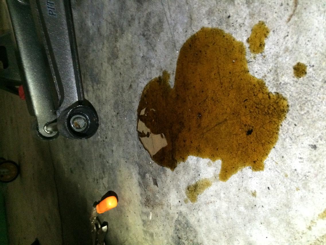

I did my inners and outers today and had a decent amount of oil in the boot. The passenger side (pictured below was the worst)and it was pretty watery. The boot looked solid and I didn't see any holes or damage to it. I replaced it anyway. Would this be a steering rack issue and is this something that will ruin the new inners I just put on?

FWIW on the OEM vs Non-OEM for these parts; I got LBJs, ITRE, and OTREs from Napa about 32k miles ago. The LBJ's were Sankei/555 and were trashed. The driver's OTRE (Napa Chassis Part NCP or Sankei I think) has a torn boot, but the ITRE (NCP or better) actually still holds the OTRE very well, so go figure. The passenger's OTRE is in good shape (no torn boot), but the ITRE drops the OTRE pretty quickly, so...yeah.
I'm thinking of going all OEM this time for these Amayama prices. If it turns out to be expensive to ship or something, I'll just be going with OEM OTREs (already replaced the LBJs with OEM from Camelback) and Napa ITREs. I'm getting the impression that any exposed rubber boot on a lifted vehicle that isn't an OEM part will get trashed.
