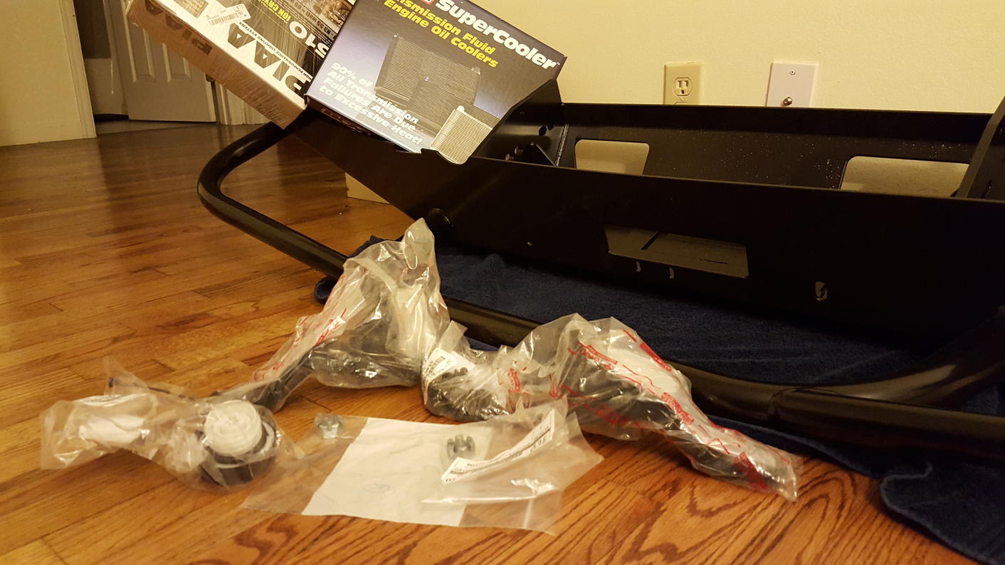

So I just got my new OEM LBJs with new hardware and castle nuts today from Camelback. Due to budget, I did not order the whole kit and caboodle (inner and outer tie rods) yet. If I have the lifetime Firestone alignment, is there any reason to delay swapping out the LBJs till I can get the rest of the parts? My thinking is that as my 4runner sits, (at 190K miles), that getting those LBJs swapped should happen sooner rather than later, then worry about the rest when I can. I have a new Shrockworks front bumper that I am about to install, and I figure that I should catch up with some maintenance before I go adding weight and things like lifts to my rig. What say ye?
If it were me I'd hold off until you have everything, unless it's going to be months before you can get the other stuff. It will save you having to break the tie rod and LBJ apart, which can be a pain, and you'll probably damage the boot anyway. When I did mine I pulled the LBJ, ITR, and OTR out as one piece, and then just replaced everything with new.
I was actually going to suggest the opposite. I'd swap them because it's a safety issue, but tie rods aren't. I had no issues breaking the tie rod free from the LBJ when I did mine. I just had to get the right size puller and be careful around the boot. My truck also has no rust at all though which certainly helps.
As for the alignment if you have the lifetime alignment at firestone then it doesn't matter, I've probably got 10 alignments there since I got my 3rd gen. Pretty good deal if you work on your truck a lot like I do. You don't NEED an alignment after LBJ's either. It shouldn't change anything, but I had mine done afterwards anyway.
