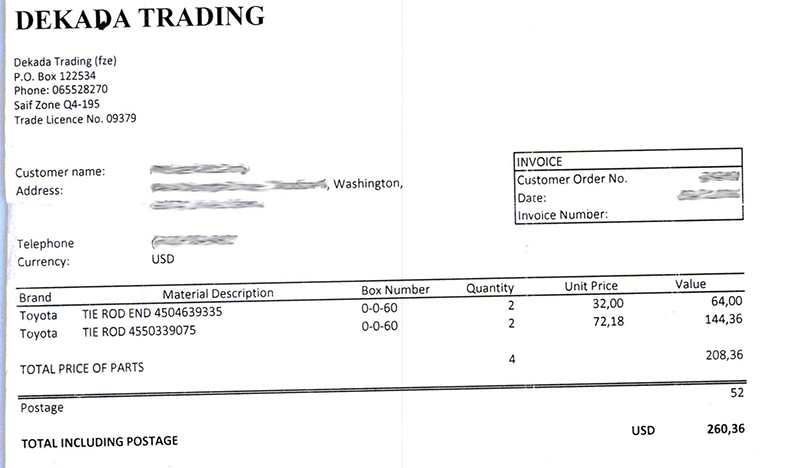

At the time I bought the Sankei/666 parts, I really didn't have the money for OEM. I do now, so I got the ITR's from Amayama for $199 for both shipped from Japan. That's about $60-70 less than the best price I could find in the US. The OTRE's I got from Camelback since the price savings was negated by the international shipping.
