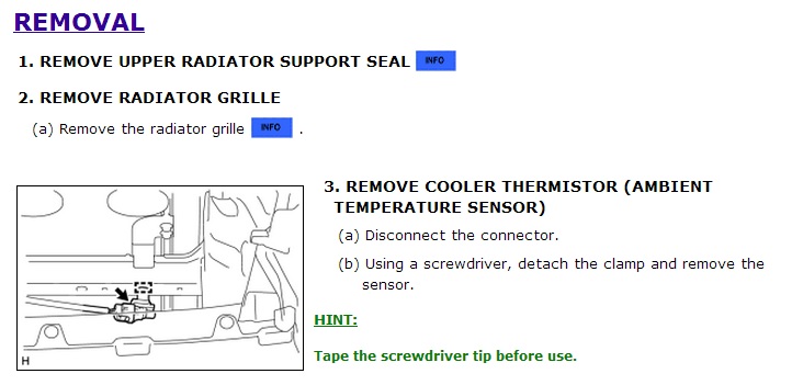

I'd be interested in hearing where that temp sensor is located if anyone knows.

Seems like it's right behind the grille?
