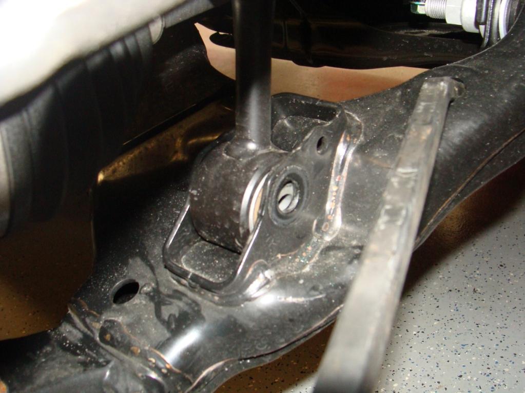

Put a crowbar in one of these holes, kneel on it and the strut will slide right in - even set at 2.5". I've done it 4 times this way. Piece of cake!
