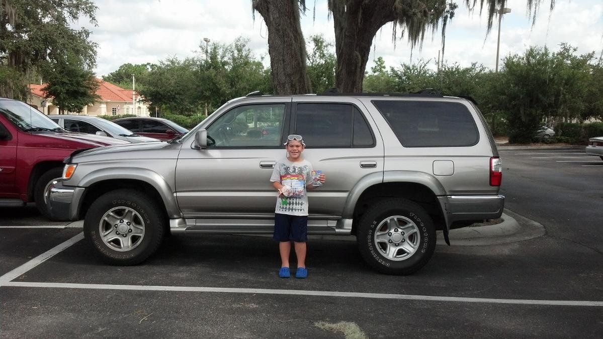

my son posing with the rear done, 906's/billies. fronts to come. already have the 5100's waiting for coils!

OME coils , 881's in front and 906's in the rear

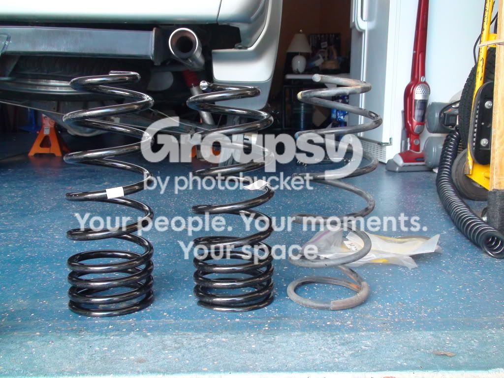

Old vs. new springs
DSC00025.jpg~original
