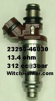

Just did a HP calculation on 312cc injectors on a 6 banger at 45psi fuel pressure. Says they would only support 252whp supercharged. I would guess now that they are not large enough for this application. Something around 450cc would be a lot better.

I surely had Supra injectors. Part number was 23250-70080 - the light green top ones. I always thought they were 315cc, but apparently, like OP stated, they're 312cc.

Now, my near future plan is to drop in the brown top Supra injectors which at said to be 312CC, I see they are good enough for 250whp but that's plenty...I'm really looking for 240whp realistically.

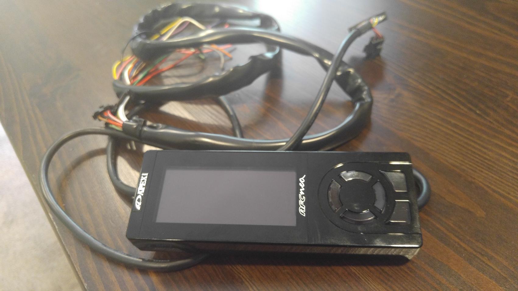

Purchased my Apexi Neo to tune this, gotta get my boomslang harness and I should be able to send the injectors in for cleaning and then install.
