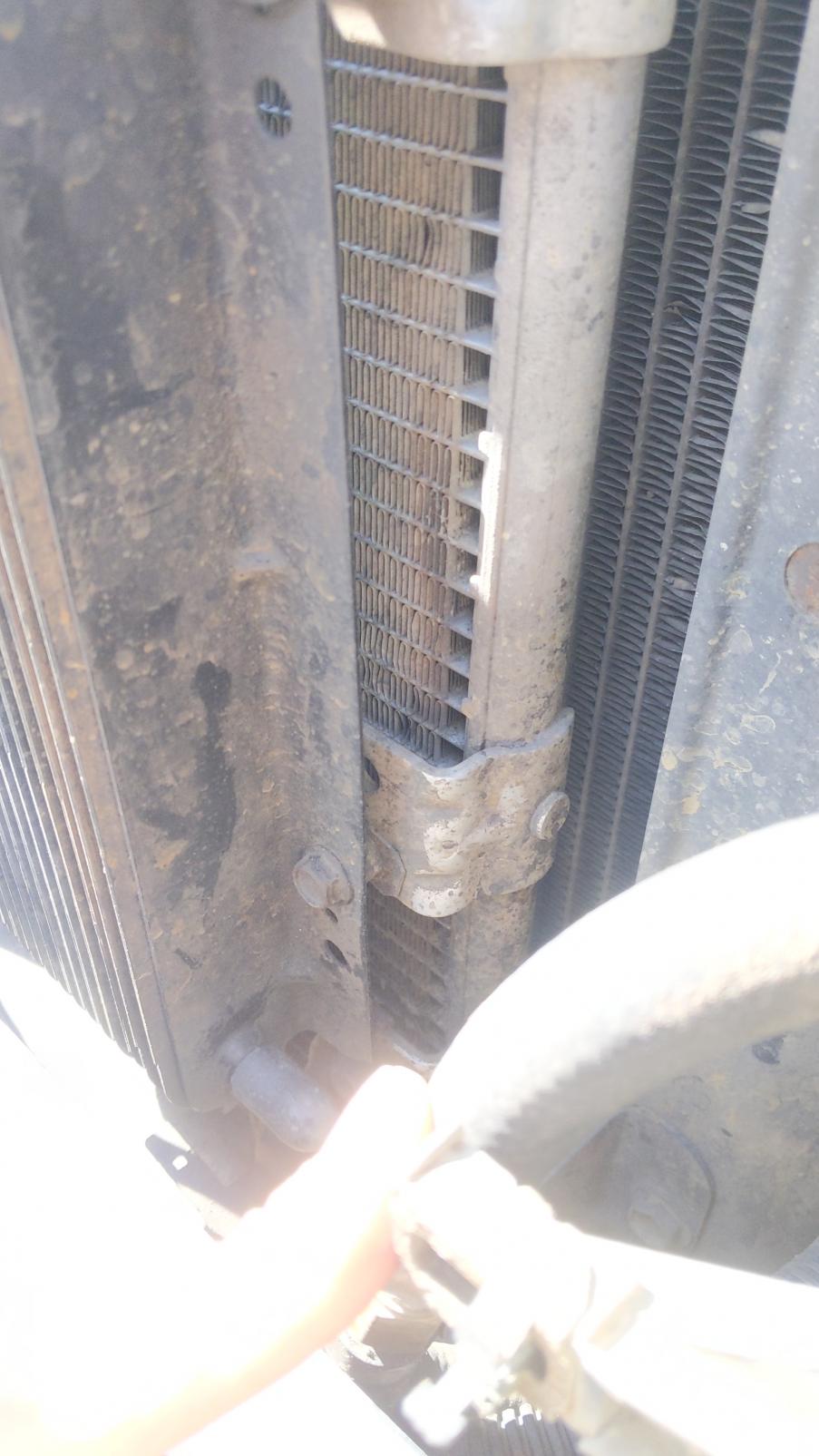

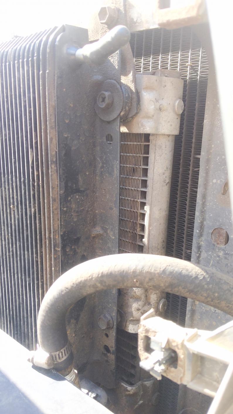

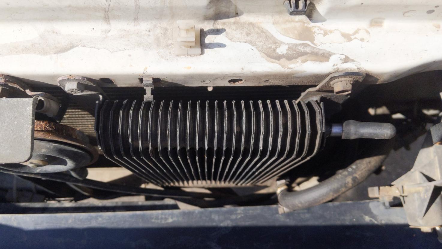

If you take a look at my build thread on page 8. It will give you an idea of how I mounted mine. If you need I can get some more pictures.
[MENTION=45676]dirtbike250x[/MENTION] would love to see some more pics of your mounting points/bracket bends past what you have on Pg 8 of your build. Definitely on board for your methodology and rationale on this one. Thanks man!
Apologize for the delay, hopefully these images help as I happen to have the grill off right now. The cooler is mounted via three bolts and has been rock steady for the years it has been mounted so far.
