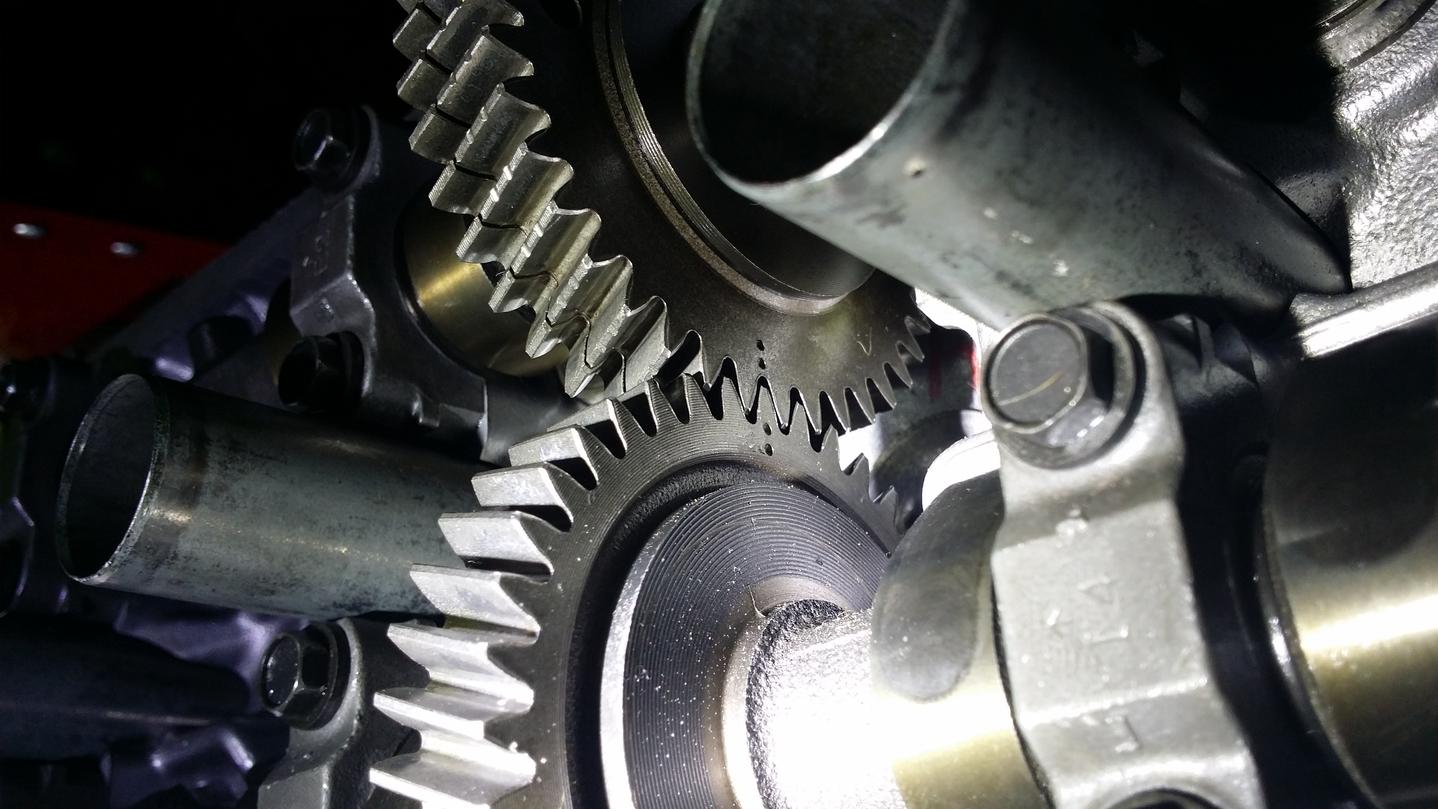

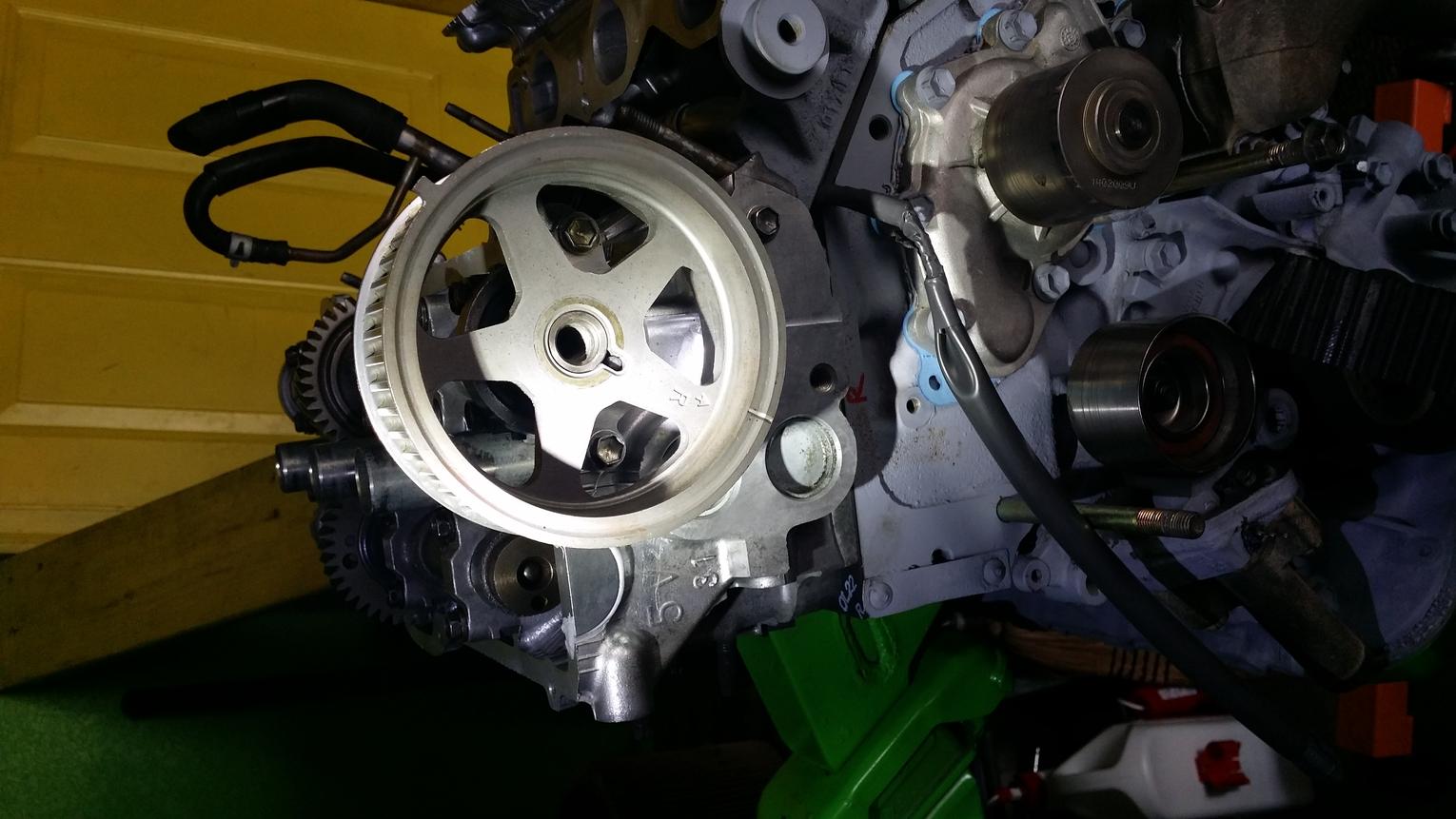

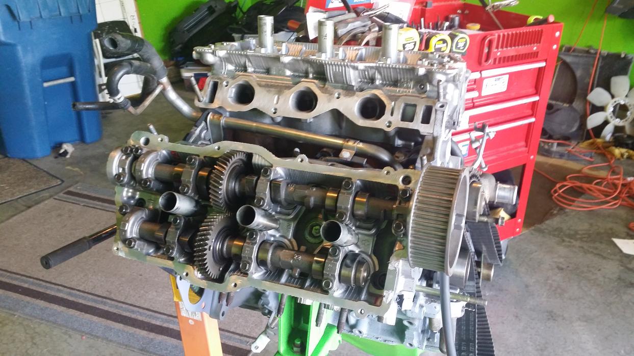

See pics. Why is that wheel not at top dead on the marks? Am I 180 out? Or am I just over thinking this like I do at times with engines.

The hole that's at the 11 o'clock is correct. If you eye ball the dots on the camshaft gear they should be level with the cylinder head valve cover gasket surface. Like i said the hole has actual hole has another purpose. Keeping the constant pressure on the intake gear for no noise direct gear to gear lash.
Like i said in the PM. the cam lining up with the timing marks on the Big belt driven gear is for timing the little dots are for install for minimal tension on the cams for installation. you can break a cam if installed incorrectly , hence why there is a service procedure to install them that way.

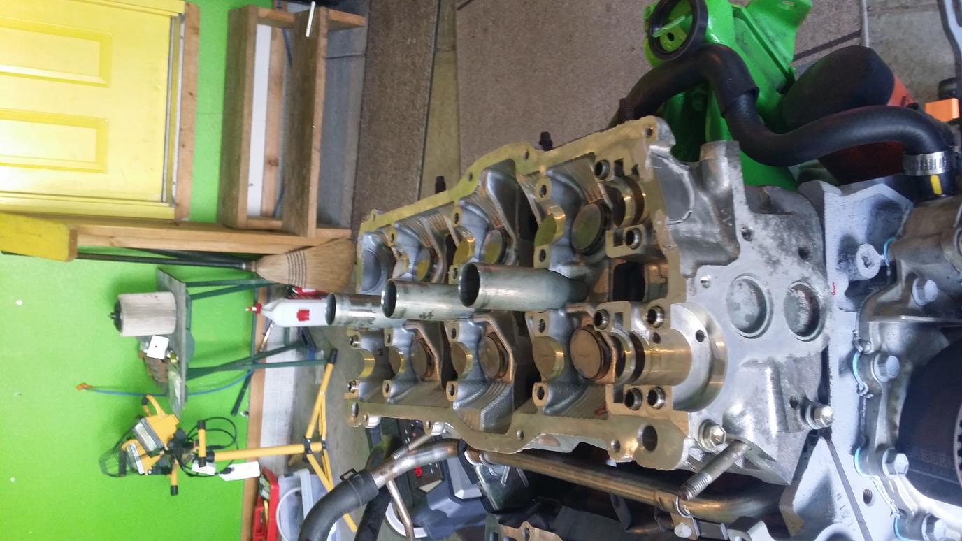

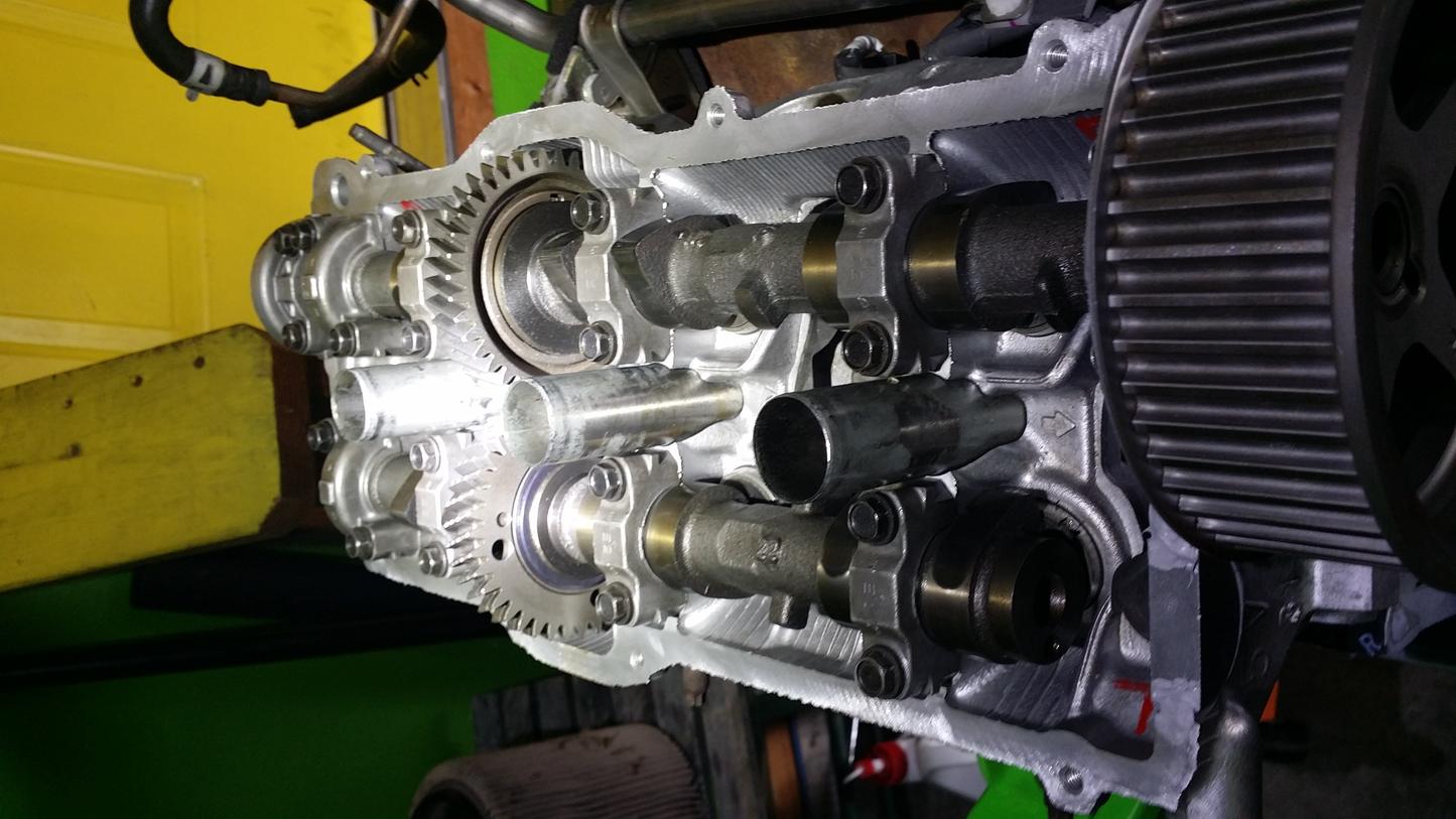

It's coming along. I'm just over thinking crap again.

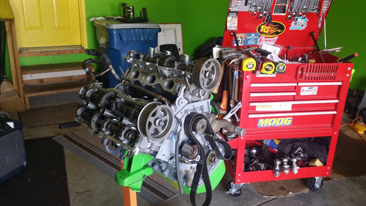

Cams are now in and all lined up as they should be. Lower intake time...
Hate to tell 'ya man, but you don't have enough hammers or tape measures to finish this job right.
You always NEED a bigger hammer. As for tapes. Good luck finding one if you ever need one. I just found one of them under my kids bed,and one in the shed. They now all live on my tool box so I can find them or at least one anyhow.
