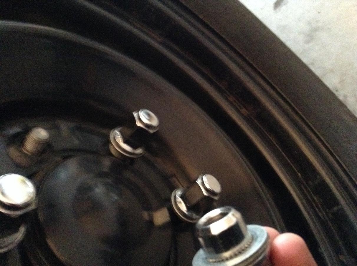

Hey [MENTION=51186]philsey[/MENTION] [MENTION=85512]eddiebx[/MENTION] [MENTION=66300]Intruder[/MENTION] [MENTION=23991]jspagna1[/MENTION], am I ok to use the wheel nuts off the 20's? The guy I bought these wheels from said he used the OEM nuts as he bought these tires and rims from the dealership. I know there are different styles of nuts. Pics attached of me mounting. You can see on the rim that the receiving hole (lol) is rounded outward and not flat. I also am also holding the OEM nut to show the rounded bottom.

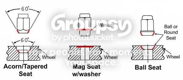

What you are describing is a ball seat on the steelies, as shown below:

To be honest I never carefully inspected my 4runner's nuts, lol; but I think it might not have a ball seat in addition to the built in washer, since it is the washer that applies the clamping force to our wheels.
With a ball seat type wheel/nut, it is the ball seat surface that applies the clamping force, so your best bet is to get the appropriate nuts ASAP. With that said, before I knew better in my younger days, I ran tapered seat nuts on my ball seat wheels for months on end without issue. BUT, don't follow my foot steps, lol.
The problem is you risk having the lug nuts back out since only a tiny bit of the seat is being used to clamp the wheel down, instead of the full surface.
Swing by any car parts store, they should have what you need. Also, bring an OE nut inside so you can get the right thread pitch :)

Thanks. So now I'm on my 2nd tire and not sure whether to keep going or put the OEM wheel back on and get a shop to do it. So much for this being easy lol.
Cause it's a pia lol. I called the dealership and the guy in parts said it is ok and yes the bottom of the lugs would fit against the rim, the washer will have no contact. He said the only issue is I may hear a bit of rattling. He said that's how he runs his. I feel confident in his recommendation because he described the fitment to me and knew exactly how it is set up without me having to explain it and him just agreeing with my unprofessional opinion. I'll keep going and continue putting the winters on and like you said, see about getting some proper nuts to fit.
As I had said earlier, it is most likely fine to run it with those nuts if you are in a pinch, in the sense that you're not likely to end up with a wheel flying off instantaneously; I used tapered seat nuts (which are probably pretty similar to out OE nuts) on a set of ball seat wheels and was fine for the longest time (before I knew better).
BUT, it's a very good idea to get the right lug nuts as soon as practical; reason being, with the wrong nut you're only clamping down with a tiny fraction of the actual seat surface so it's much easier for the nut to loosen up. Plus if you keep putting them on and taking it off with the wrong nut, you eventually ruin the radius of the ball seat.
Look at it this way, It's literally like trying to mate a round ball with a cone or vice versa, lol.
Anyhow, remember to recheck torque periodically if you're going to use the OE nuts for now!

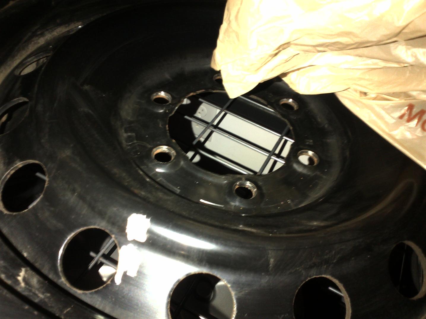

[MENTION=92682]JayceeP[/MENTION], it just occurred to me, did you look carefully at the steel wheel's lug nut seat? It could very well be that they are tapered seats and not ball seat, no way to tell from the picture you posted. See if there is a slight arc in the seat (ball seat), as opposed to being completely flat but conical (tapered seat). The OE nuts might work out just fine if it's a tapered seat, maybe that's what the parts guy meant :)

I put them on, hard to say. I'll double check. I just took a quick rip down the highway and everything felt fine. I'm surprised... I figured here would be a more noticeable difference between the OEM 20 Yokohoma's and these 17 Michelin x-ice xi2's.
[MENTION=85512]eddiebx[/MENTION], I haven't taken off a nut yet but here is a pic I snapped yesterday. If you zoom in a bit, it does sort of look tapered so that the rounded/tapered end of the bolt can sit in it. The bolt itself wasn't tapered very much.
