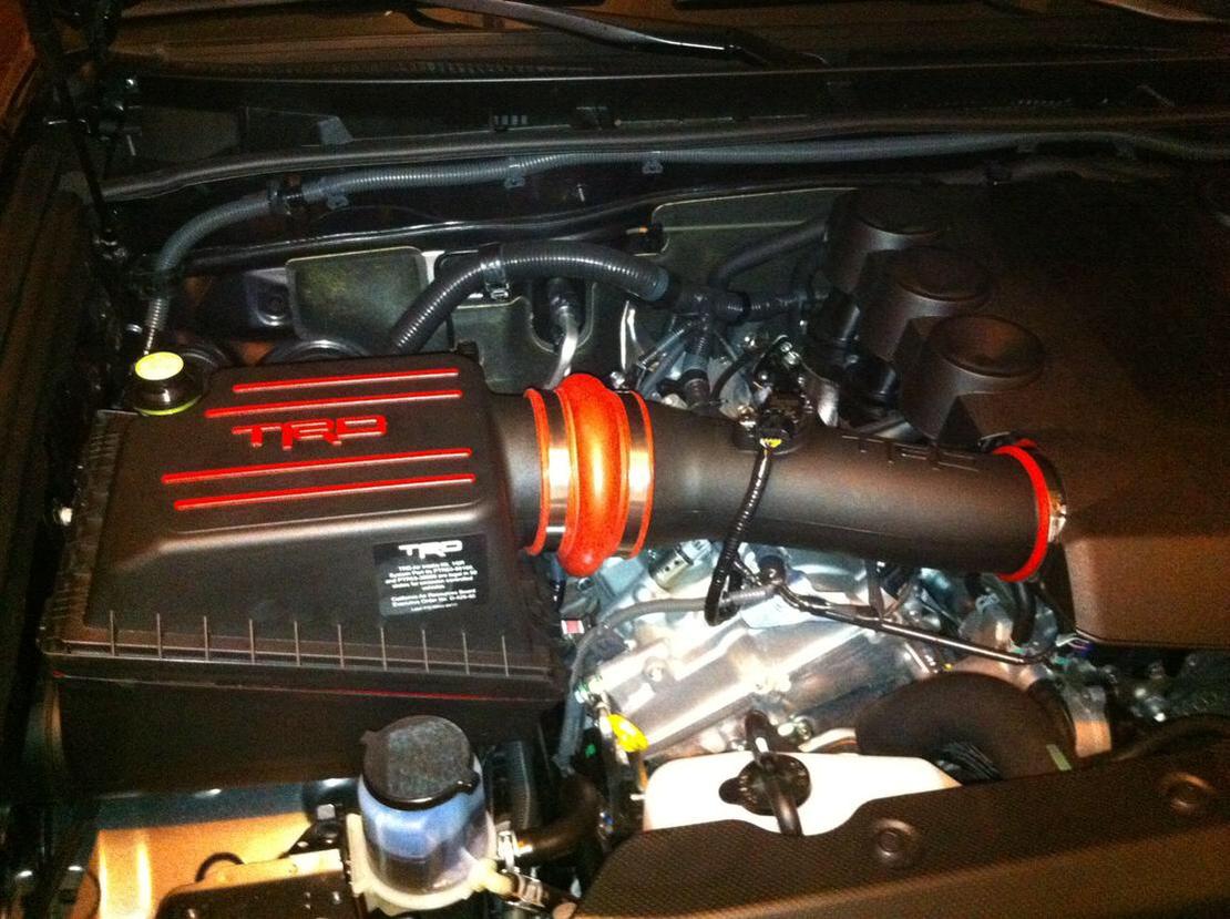

a lot of guys have mounted their compressors at the passenger side firewall, behind the intake box. pic below shows how the MAF is relocated into the TRD CAI (credit to whomever's pic Google found for me). two screws hold it in place in the intake tube.
pretty sure the other filter you're referring to is the hydrocarbon filter, which i removed from my TRD CAI with no ill effect.

Hydrocarbon? So, I guess it is there for emissions/evap when the engine is off. Seems worth removing.
