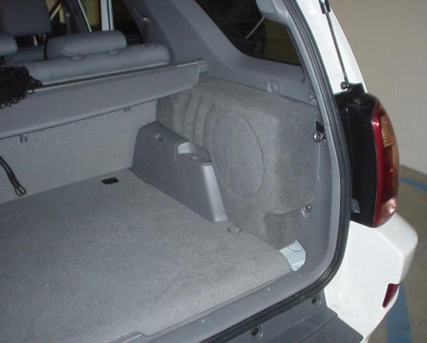

BlueGP said:
Where did you get the sub box? Did you build it yourself, it looks great.
Brian
No, no, that's a JL audio Stealthbox, you can order them from JL Auido with the carpet color you need. It has on 10w3v2 woofer in it. The box is made of fiberglass. Its a bit pricey approx $500, I would have done one of their ProWedge 12inch W6 woorfers($350), but the owner of this car wanted it to take up as little space as possible.
nice job! looks pretty cool to me. how's the sound? does the double decker shelf still work w/the stealthbox in place?
The sound is a 100x improvement over stock. But consider we bumped the output considerable and there is a much better source some of that is to be expected. I think therer is a little room left in term of sound quality by upgrading the door speakers. But we are getting to the point of dimishing returns if you know what I mean.
The shelf cannot fucntion if the subbox is installed per the instructions. However. with a slight modification to the shelf, I think it can be made to function again. It is just a hair to wide on the right/passenger side, but I think if I trim the shelf a 1/2 inch in one spot it will work again. I'll let you know if when that is complete.
hey thats pretty cool how you are going to hide the amp but a couple things to think about. just from having multiple custom systems with many different variations did u consider with that small amount of space behind there where the custom bracket is, the amp is in and the side panel will go over. when you play the sub for a long period of time do you think the amp will over heat? are you going to do anything to cool it. what kind of woofer are you going to use, also the pro wedge is an awesome box man, JL is the only way to go. i am installing a custom stereo in my 04 as we speak with to 12 in JL W3 and i am trying to post a thread but i just cant figure out how to post pictures. i wanted to see what colors you guys think i should use for my box
thanks man and good luck with the system
Bailey- I was concerned about the small space, but I was going to give it a shot before installing some fans to improve air flow through there.
Consider this...at the bottom of that space is a sizeable vent to the exterior that all cars have that enables air to flow through the passenger compartment from the HVAC system and then escape through the rear quarter panels. So there might be a fair amount of air flow through that fender area. Also it isn't as cramped in there as the picture indicate.
Based on that I was going to try it before wiring up any fans. So far it hasn't heated up, but it is cool here now too.

FlyingDutchMan, I love your amp bracket. I was planning a very similar bracket for my JL e4300 but it looks like you beat me to the punch. Can you post dimensions? It would save me a ton of time.
Thank you VERY much in advance......
Sorry, but I didn't trace it. But you can do what I did, just trace the stock subwoofer box onto the wood, cut it out, and then trim and fit it from there...you'll have my pictures to give you a head start.
