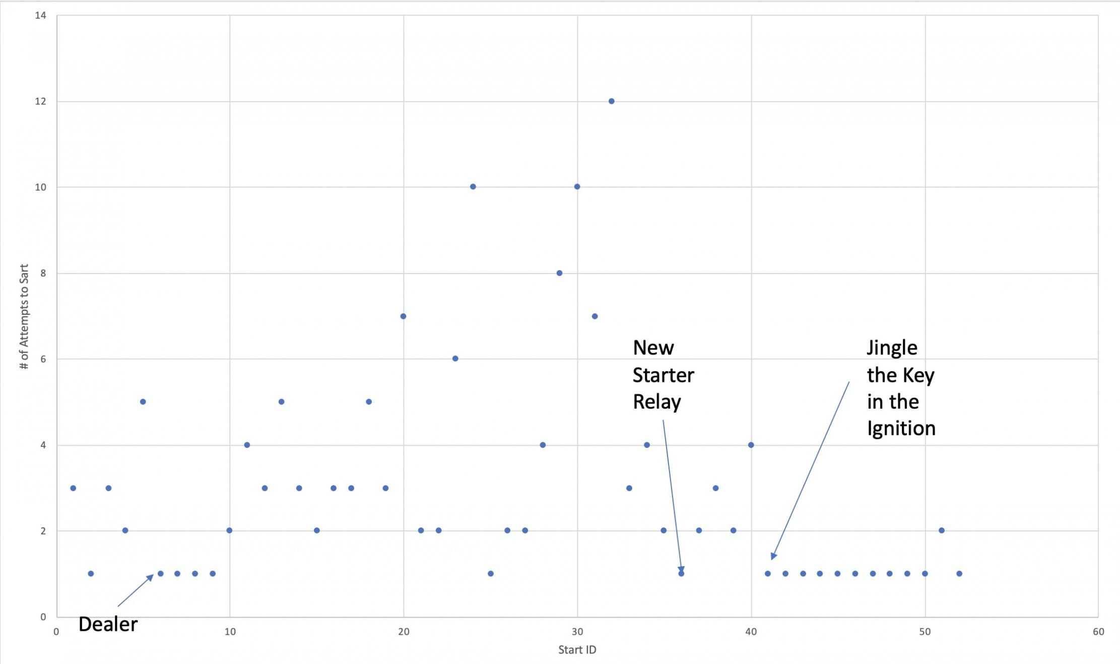

My suspicion now lies in the ignition relay. I put a new starter relay in and it continued to act up. Got fed up and as a last resort did some percussive matinenance with the key in the ignition (jingle jangle the heck out of it in all rotation positions (up down, left right, in-out...) and that seems to have helped tremendously... even made a pretty picture of start attempts vs starts:
330720d1554439425-intermittent-delayed-start-crank-start_attempts-jpg
I've now ordered a new ignition switch. After looking at the repair manual , I believe the switch engages the ECM, but is not 100% of the time engaging the starter relay. I plan to pull it and swap a new one in as soon as it arrives in a few days.

So the above 'key jingling' and such turned out to not fix it. Problem continued, intermittent as ever, after swapping out ignition switches. After a few weeks, later April, for about a week it would fire up on the second attempt which was livable. I had a week vacation where I didn't need the vehicle, so dropped it off at the dealer for them to hopefully duplicate and troubleshoot. They were able to replicate it twice but unable to troubleshoot it. This was in late April/Early May. After I picked it up, it has 'cured' itself. I'm beginning to suspect the dealer installed KARR 'security' system was misfiring for some reason. I want to take remove it since it's the only 'aftermarket' item spliced into the vehicle starting system. It's on the inside of the vehicle hidden in the drivers kick panel by the inside fuse box. Still not 100% sure what caused the vehicle start system to go berserk, but seems to have cured itself for the last month.
