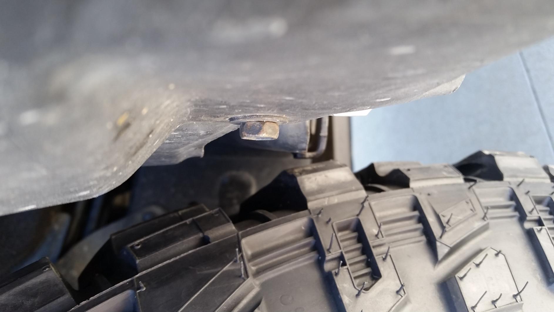

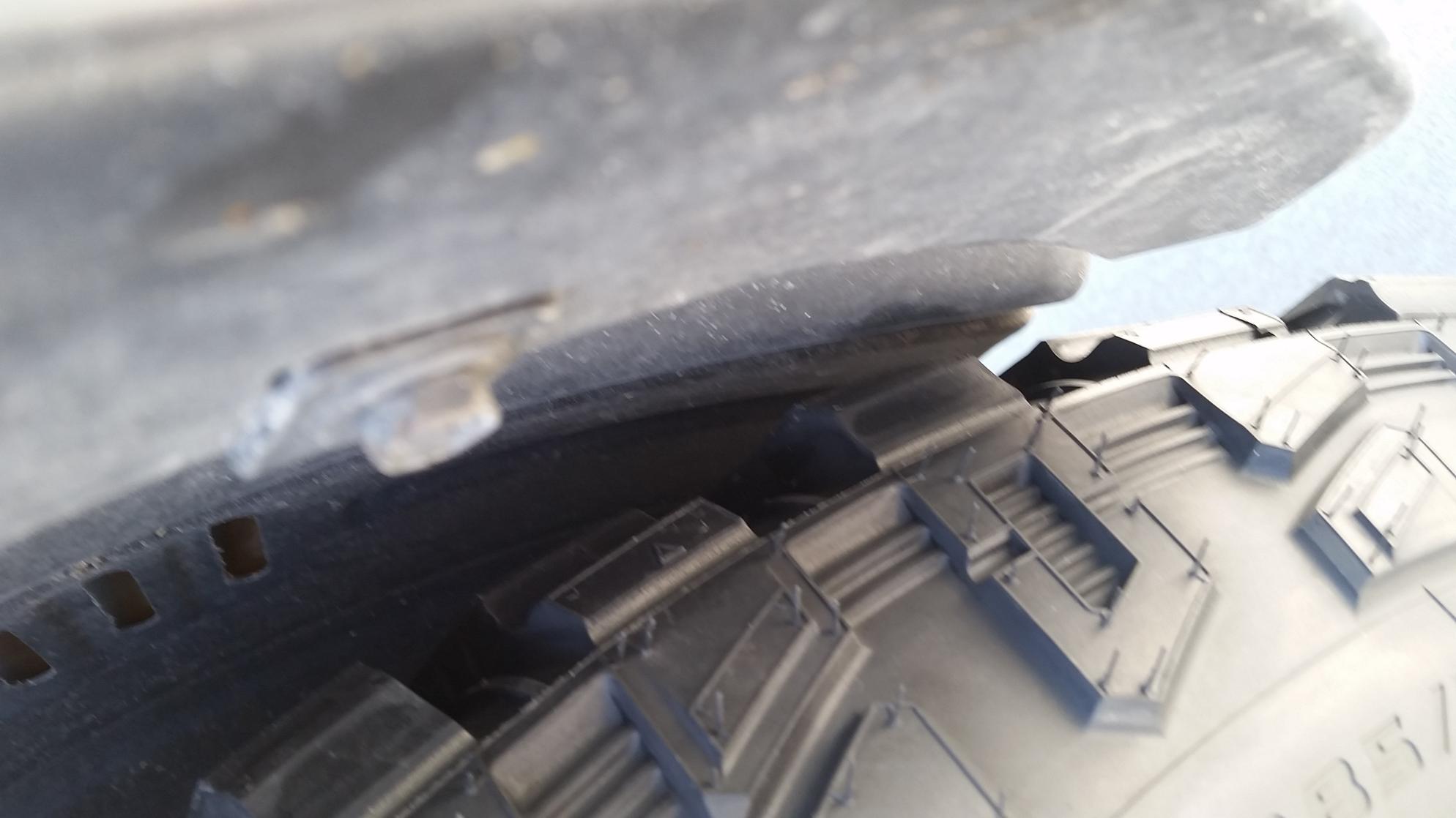

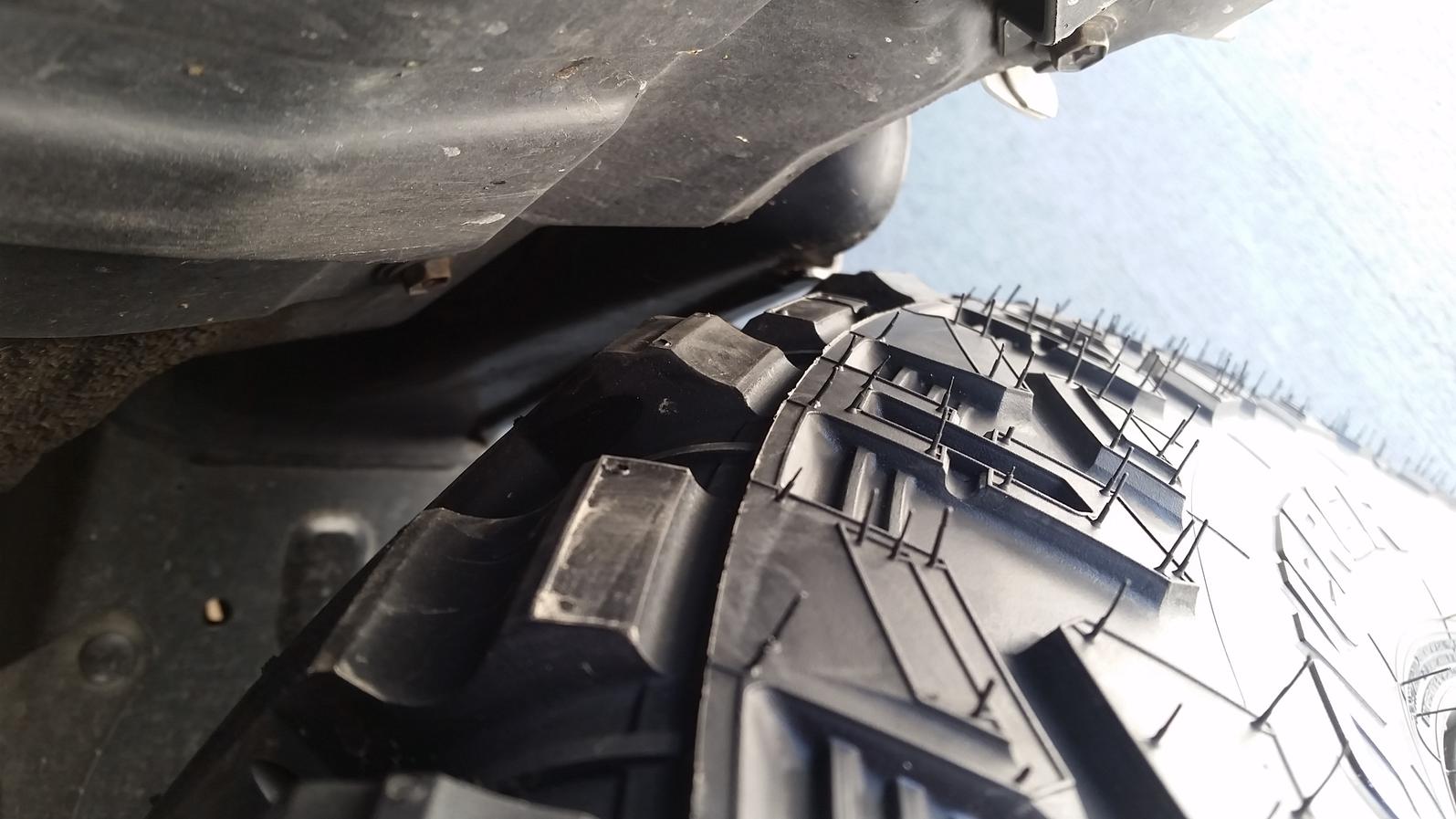

I have some rubbing on the body mount in reverse. If it's flat it's not until full lock, but any kind of incline/decline driveway or parking lot I'm catching the body mount as soon as I turn the wheel. Normal driving I've no issues so far. Definitely need to do a BMC before I go wheeling again. Last pic shows how close I am to the liner. I'm at +4 caster. Everything is fine for driving but I'll need to do some trimming and the body mount chop before I hit the dirt.

Sorry for the sideways phone pics. Can get better ones if anyone needs them. Also forgot to add I put on brand new Cooper STT Pro Tires. If I was running an All Terrian I doubt I'd have any rubbing issues.
