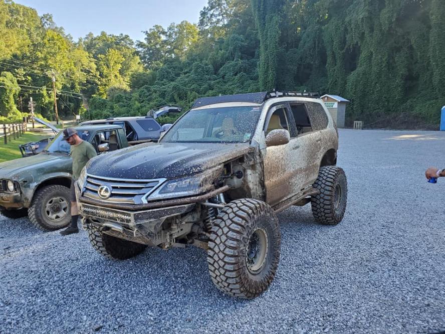

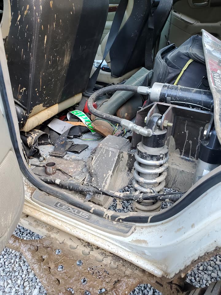

[MENTION=130999]Inv4drZm[/MENTION] Thanks for letting me pick your brain! This is Southern Style Offroad's Lexus ( [MENTION=110183]SouthernSS[/MENTION] ) Kevin brought to ATR a couple weeks ago. It's a full trailer rig but it might give you some ideas. He has TT style lower links with the front brackets moved forward quite a bit for the extra length. I never crawled underneath to look at the axle mounts or the upper links though. Judging by the 1st pic the lower mounts might be in the standard position and looking at the coilover pic, the tank has been relocated.
Yeah it's a trailing arm rear setup where the coilover is mounted directly to the suspension link. I'm wanting to mount mine to the axle still, and the frame side mount might stick up into the cab, but I can cut the wheel wells and box it in completely blocking off the elements.
Ah, that presents a whole different set of problems. Kevin cut some small tubs in his wheel wells to clear the big tires. I guess if you do that you could cage or put a small tower in and then box it all in like you mentioned. Has anyone done this on a 4th or 5th gen before? I wish I had a decent shop and a lift, I'd sit underneath this thing all day cycling the axle and looking at my options.

Pretty much what I want to do. Close in the shock mounts, throw a brace tube in between each shock mount, and incorporate a roll cage/bar off of that. Maybe even raise the floor in the rear 6" and mount a fuel tank underneath the hatch. Removing my old tank of course. No I haven't seen it done anywhere except a solid axle 4th gen and maybe a couple FJ's, but without the roll cage addition.
