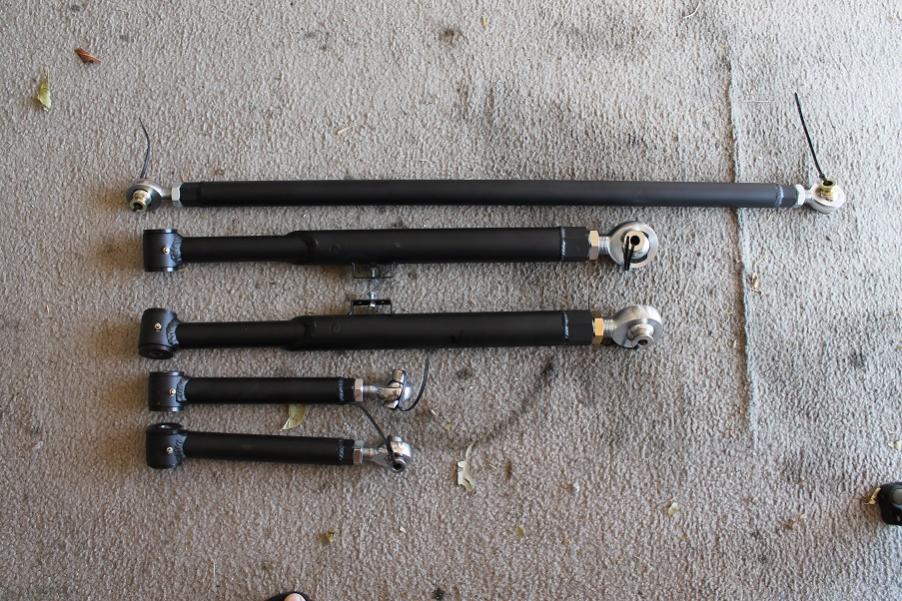

Front-Range Offroad heims are a hair too big diameter to fit in the lower axle mounts easily. We chamfered a bolt quite a bit with a grinder and knocked it in with a hammer, hoping the link will wear itself a new home. It was either that or grind down the heim, or die-grind the axle mount but we didn't have an air tank for our die grinder at our house. A angle grinder couldn't quite reach the spot on the mount.
The stock bolts for the lower links were too short, they beefed up the thickness of the plate. We ran and got G8 3.7" long 9/16 bolts. We still need a couple extra washers because the width on the mount leaves a little wiggle room for the misalignment spacers which is a no-no.
Which brings us to the shock mounts, they are way too long and allow the shocks to slide probably 3/4"... Might need more spacers or something.

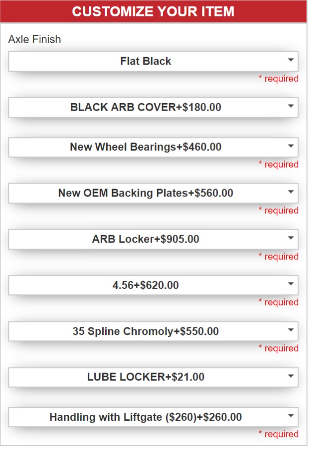

This is the Dana 60 and the options i'm looking to get, anything else you would advise that I would need?
Looks good. Front diff too, of course. Unless you are 2wd.
Edit: Not sure you want the lube locker gasket with the ARB cover. You don't need to take off the ARB cover with every oil change, and it might even have its own gasket, not sure.
  • 85-140 Lucas gear oil, about 3qts for the rear, 1.5 for the front. Enough for two changes so you can break in the gears.
  • 2 Grade 8 3.75" long bolts/nuts/1/2" washers for lower links
  • 8 1/2" washers to center the panhard bar
  • Air locker air lines and solenoids are included by ECGS. They also include the parts to swap the factory ujoint out for a D60 size ubolt setup.

Ha just noticed you have Front Range Links. How do you like the Heims on both ends? Probably gives you a good bit more droop. The CaliFabs are offset for that purpose, but are more expensive. I never really looked at FR before, they look pretty stout as well.
The double heims added a bit more vibrations, but after the install I noticed when rock crawling the driveshaft flange rubs the fuel tank skid and the muffler so I'm getting more movement somewhere. Maybe just side-to-side movement though. I havent looked to see if these contact the housing or where the new droop limit is, keep in mind I have standard length Icon 2.5" shocks.
That sucks about the contact. Is that the stock skid? I don't do much crawling here in flat land, so I got nothing. I do hit the whoops when I can and so far haven't noticed any contact. 28" Ext. Rear Kings w the Califabs.
Like you said, Maybe the heims at both ends are allowing for a touch more lateral movement?
