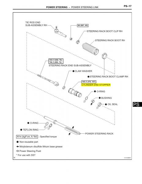

Are you saying you had to tighten the "cylinder end stopper"??
Noticed the steering rack is coming loose again, so I tightened it up 2 turns. I seriously need to tack weld it.
Yeah that is it. It came unthreaded during my Moab trip and blew out of the end of the steering rack, though it was captured by the tie rods.
