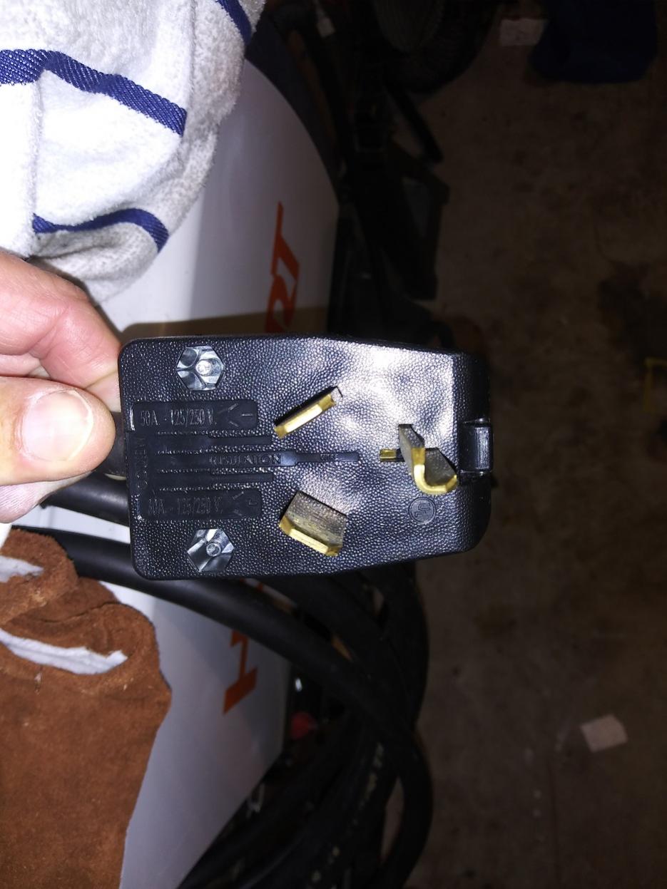

I do have a 220 dryer outlet, its about 30ft from the garage, down the stairs. My grandpa has an extension cord too, which is pretty long. I grabbed it today but different plug, I guess welders use a different style plug than dryers. To buy a 50ft extension cord and adapter from Amazon is $200. I'll try the freebie option first to see if it works out. I shouldn't need 220v again after welding these jigs.

I picked up a used Hobart 175 mig last summer and found that out. I had some heavy 12/3 cable about 20' long sitting here for an old project, and bought this Leviton 50A universal at lowes or the depot for less than $20. Might be an option in the future if you can find some cable cheap enough. At 30' you might have to go to 10 guage to be safe though. Might be more trouble than it's worth or just run a new circuit down to the garage if it gets to be a necessity.
Probably less than $200 to have an electrician just add an outlet in garage
Sent from my SM-G986U using Tapatalk
That's only if the electric panel can handled one more 220V circuit, you can only have so much load in a electric panel, if it's already at max capacity you can't add another circuit.
That's true, I forgot about that. Even if there is space in the panel for a 220 breaker, the main might not be rated high enough to handle the load. You could make sure your HVAC, oven and dryer aren't running while your welding, but it still wouldn't be ideal or up to code. And then you might have the problem of old panel equipment that is discontinued and breakers would be hard to find, really expensive, or both. The old Federal Pacific panels here in Florida are one example.
