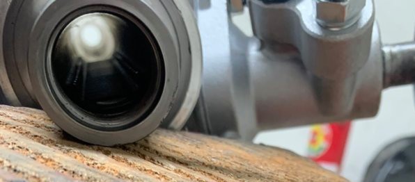

Here is a pic of the hollow 200:

The measurement between the tie rod mounting surfaces means nothing. The only measurement that matters is the pivot points themselves. The inner tie rods balls are larger on the LC200 rack and add to its width. I measured:
33.5" clevis bolt to clevis bolt LC200 with heims
32.5" stock LC200 ball joint to ball joint
29.75" stock ball joint to ball joint
So thats where I got my 2.75" difference overall or 1.375" each side. Stock rack to stock rack.
I don't see how its possible the shorten the shaft any. Last picture shows the shaft all the way in, max steering angle. That metal guard around it is held in by a snap ring and appears to be important. You can see the snap ring in the second pic. If you shorten the shaft that metal guard is in the way of the tie rod.
The end where the threads are could be heat treated:
