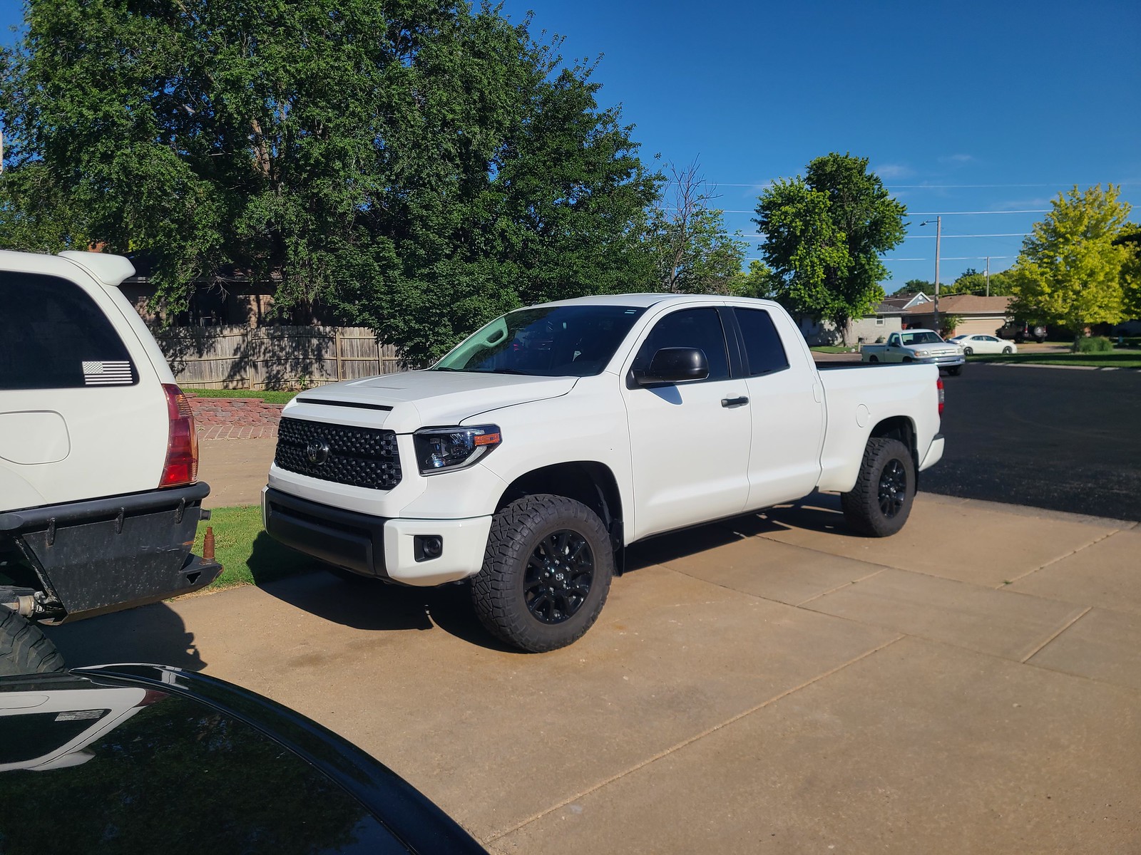

Been looking online at newer trucks, not super seriously, but have considered just about anything new between a 2022 Tundra, single cab 5.0 F150, or even a Silverado trail boss as a DD and expo rig. I don't put many miles on so decided I wanted another gas guzzling V8 lol.
Then the perfect truck popped up for sale at a local dealership. 2019 Tundra, extended cab, 6.5ft bed, white, color matched bumpers, already leveled on 33's, already has cool wheels. Only 13k miles. Fell in love and drove it home!
"The last of the V8's" still rings true lol
Super nice upgrade over my 2005 trucks.

Are you going to keep the 6.5 ft bed or are you gonna shorten it? I've seen some cool extended cab 2.5 gen tundra builds from a few shops. the shorter bed looks cool. Except less functional...
I considered a Raptor in that configuration but decided a 6.5ft bed will be nicer when I actually need a bed and I can still sleep in the back of the truck if needed.
In Kansas a longer bed/wheelbase won't be noticed unless parking in bigger cities. In Colorado I only plan to do milder trails with this so a foot shorter wheelbase shouldnt be an issue.
I eventually want Decked drawers, and possibly a mild single exhaust system, I might weld it myself. I like the stock shock's ride on concrete and may not change them out but a budget Fox 2.0 setup is being considered. It already has 1 size bigger tires than a TRD Pro, any bigger and I may need to remove mudflaps which I don't want to do.
