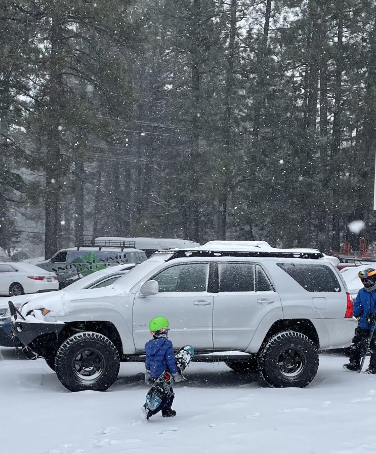

I would give it a go. I think that kit might level your truck as it’s sold. If not, adding a spacer later isn’t super difficult.
And yes, i fit the 33s just fine without trimming. I have 285/70/17 Falken Wildpeak AT3Ws

I reallyy like your built and it’s what I’m looking to make mine look like. Last question, do your wheels have any offset or did you put wheel spacers?

Thanks! Yeah i have 1.25 spidertrax. The trail wheels i have from a 2012 4Runner are +15mm offset (meaning about .5 inch inboard). With the spacers, i actually started rubbing more. I wouldnt recommend the spacers unless you’re ready to start trimming things and maybe a BMC.

As posted above, Ironman 4x4 uca has 4 degrees castor. I have 285 75r16 and experience on rub in the front and no BMC. When rock crawling, the rear does rub against the rear bumper. I will cut that before I got out next time
Wheels are 0 offset 16x … I forgot
